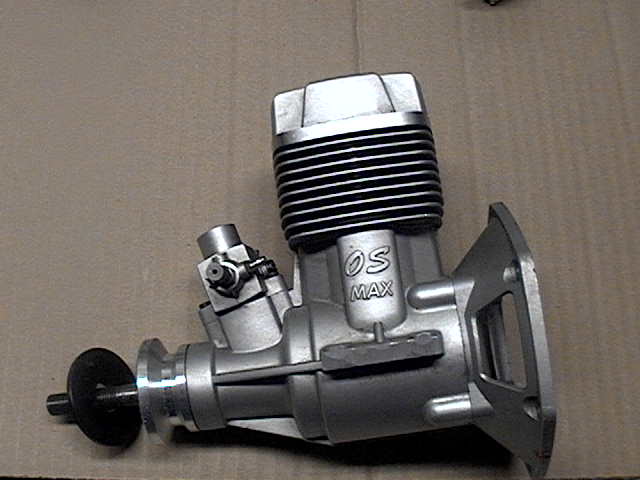

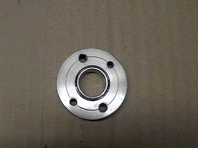

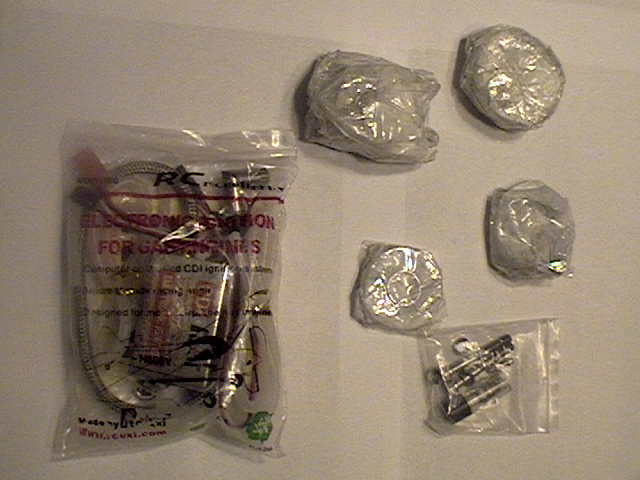

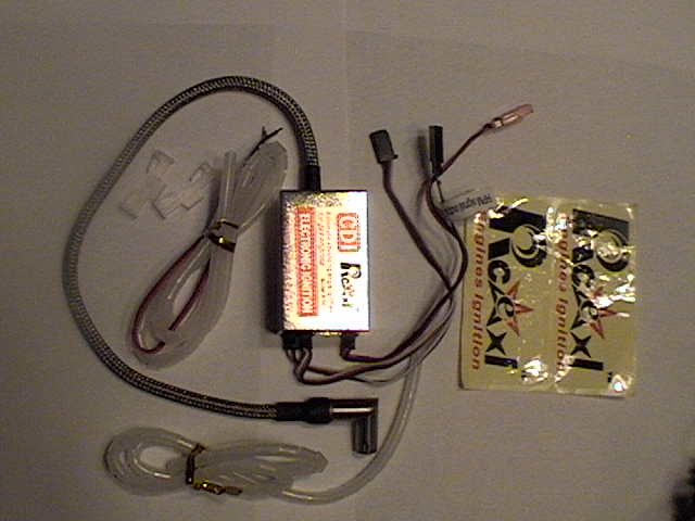

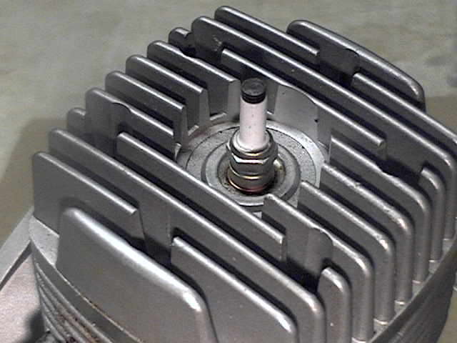

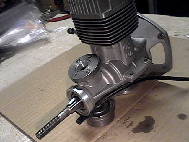

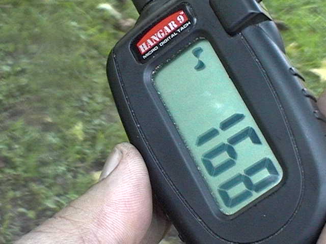

ST Engines out of Mexico has new glow to gas conversion and I got one for the BGX-1. Here's what's in the kit.
Here's the original engine.
Here's how it's done.

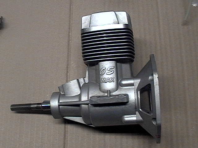

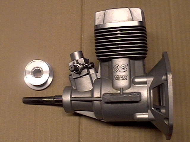

1. Remove the hub and carb. Keep the"O" ring for the Walbro carb.
2. Remove the glow plug. Kit uses a 1/4-32 spark plug.

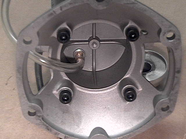

3. Remove back plate, drill 1/8 hole and tap for the supplied pressure fitting for the Walbro carb.
4. Install the carb adapter, carb and sensor ring. The instructions show the correct location.

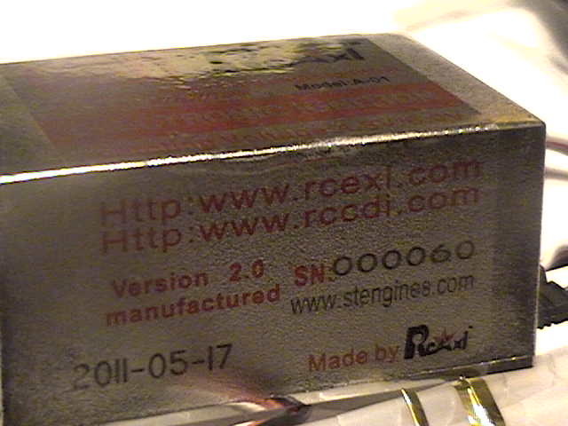

5. Connect the RCEXL ignition.

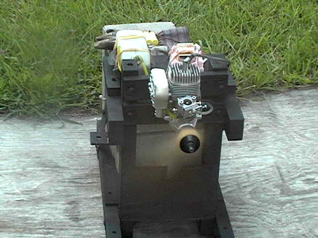

6. Connect you battery, add prop, gas, and enjoy!
7. I used a Zinger 18x6-10 prop. Here's the proff!

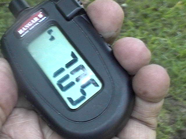

Here's the idle and high end rpm's. ST eninges also have conversions for 4-strokes as well as all the BIG Super Tigre engines. Check 'em out! Thanks Max!
www.stengines.com

The hub face is crushed...probably vise damage when the hole was drilled for the magnet.
The adapter plate groove for the re-used o-ring was far to deep and I wound up having
to make a paper gasket between the plate and manifold inlet.
