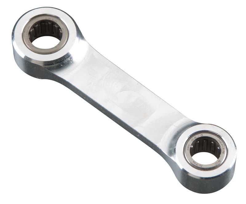

Check this out.

Do you have any details?

Default RE: OS BGX-1 Glow to Gas Conversion (Yeah!) Thanks Max
It's the connecting rod from the OS 33 GT engine. Apparently the BGX and the 33GT share the same wrist pin part number. I don't have a 33GT so I can't measure the crank pin but its half way there.
The stroke between the two engines is .015" different. Could be the bump in compression between the two engines, the BGX having a couple points less.
Interesting to say the least...
I'd be curious to see if the crankcase, and the cylinder head, had the clearance to fit the 33GT rod. I dast believe some serious study
is called for.

I'm guessing that the crankshaft on the glow engine is not hard enough to accept a roller bearing. We would need to get data on the Rockwell harness of the material the crank was made from.
The shaft hardness must be Rockwell C59 minimum and a maximum roughness of 15 microinch AA.
http://www.maintenanceresources.com/...ings/rbshf.htm
If you had to change the crank pin....A good machinist and a gage pin the size you needed would do the trick.

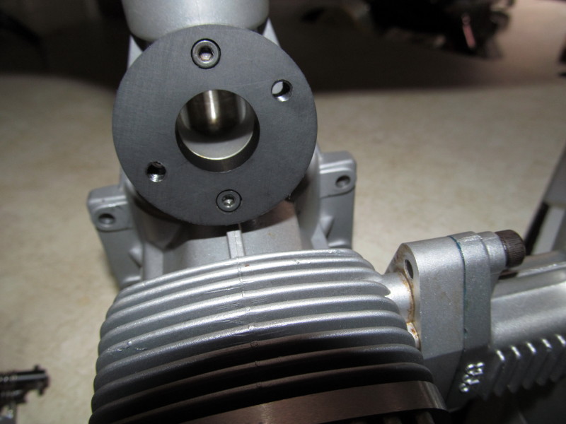

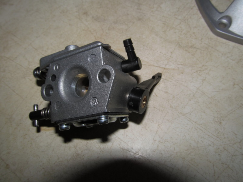

I've been fooling around with mine. I made a Walbro adapter out of Delrin and lapped both sides flat. I need to run a pulse line from the rear end of the radial mount to a pulse fitting on the front of the carburetor.
It's a Walbro WT-499 so I'm going to run it on glow and see how it works out. If it runs good, I'll add ignition and see about using FAI no-nitro fuel.

Old 08-02-2012 | 08:16 PM
  #40
Maximiliano Galvez's Avatar
Joined: Mar 2009
Posts: 163
From: Mexico, MEXICO
Very nice job.
What material you use for adapter?? is not aluminum
If you let me I can suggest a biguer venturi walbro
I can sugest too test 20X10 prop using 30:1 5w20 synthetich oil
my best regards
max
It's made from Delrin.
http://www2.dupont.com/Plastics/en_U...in/Delrin.html
It's pretty tough stuff, it holds threads well.

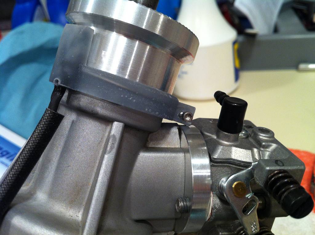

To anyone who is using Max's kit...
How is the sensor ring supposed to be mounted?
My sensor ring does not look like the one in the instructions Max e-mailed me.
Worst still if I orient the ring as per the instructions with the "adjustment screw" facing straight up in relation to the head, then the ring is restricted by the carb mount...
See attached picture.

Old 08-06-2012 | 04:05 PM
  #47
Broken Wings's Avatar
My Feedback: (20)
Posts: 2,090
Received 5 Likes on 4 Posts
From: Cocoa, FL
ORIGINAL: opjose
Worst still if I orient the ring as per the instructions with the ''adjustment screw'' facing straight up in relation to the head, then the ring is restricted by the carb mount...
You've got it about 90 degrees off....
Adjustment screw straight up and down like the way the piston travels.

Old 08-08-2012 | 09:29 AM
  #49
opjose's Avatar
Joined: Nov 2005
Posts: 12,624
From: Poolesville, MD
ORIGINAL: Broken Wings
That's just it.... I don't have an "adjustment screw" like that in the instructions.
Instead I have a tangential tightening screw that is much like a hose clamp screw.
I can't position it straight up, as then the tightening arm is blocked by the carb mount.
Click on the picture I posted and you'll see the problem.
Also note the position of the sensor when the screw is straight up.
Old 08-08-2012 | 09:34 AM
  #50
Joined: Aug 2007
Posts: 30
From: Sweetwater, TX
Orient the pick-up ring such that the screw is in the vertical plane. Not the tab it runs through.
