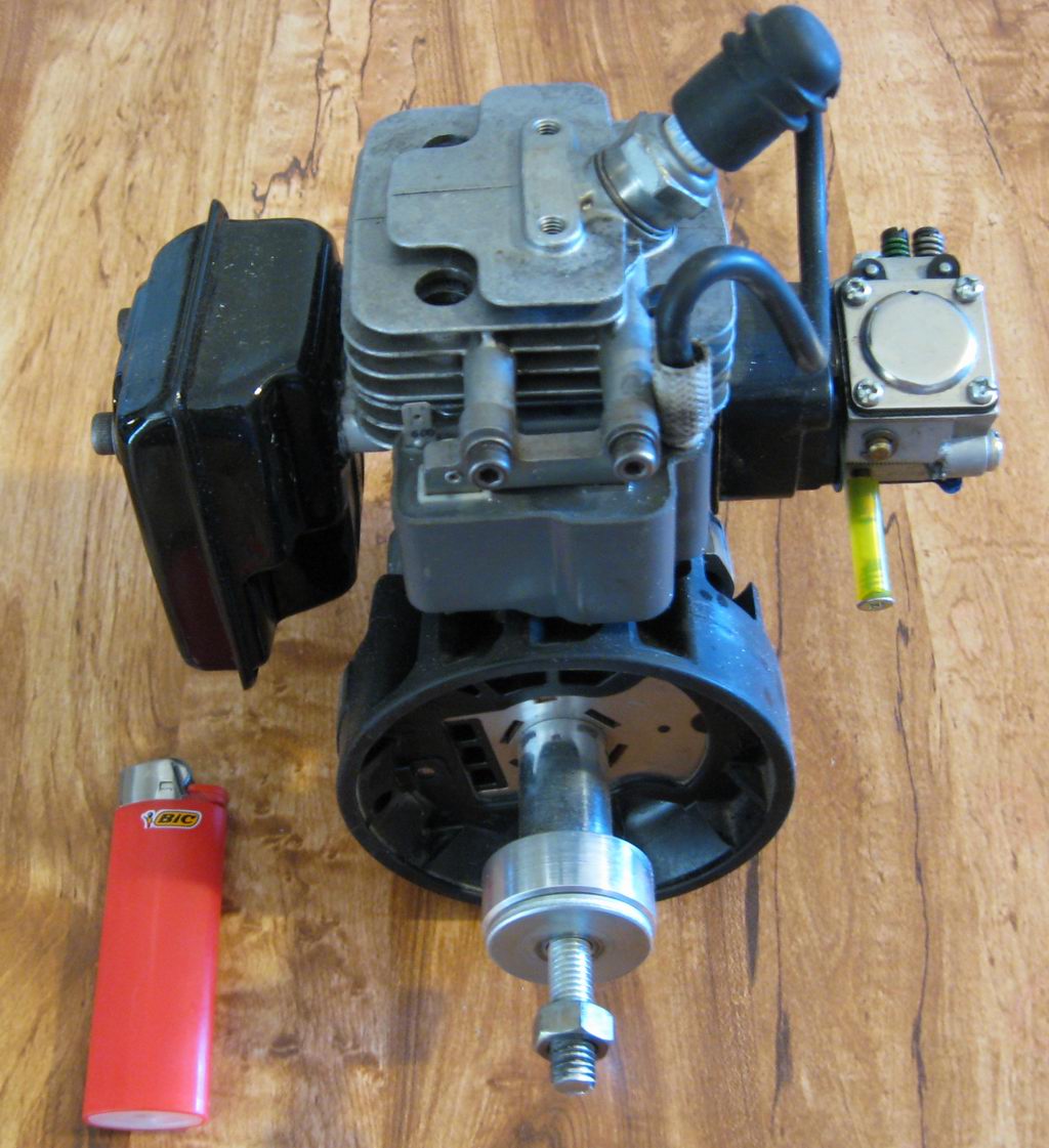

I've always wanted a smaller converted engine, so I just finished doing one. The engine is an Echo 16cc that was originally made to run clockwise. Lefthand threads at the flywheel end were of little concern to me. I made an adapter for the 5/16" shaft and just recessed the nut below the adapter's mating face. Made the prop adapter to bolt onto it with 2 recessed 10-24 thread allen head capscrews. Worked out perfectly and very true running. Installed a new factory ring and converted the engine to CDI.
Performance is improving as the ring starts to break in. I am using a MAS 13-6 plastic prop that was carefully balanced. On the second 8 ounce tank of 32:1 Pennzoil and regular gas, I took some rpm readings with an Ace Optical tach and got a reliable 1600 rpm idle, followed by 7200 rpm top end. I am thinking it could gain maybe 500 rpm after some more running. Is 7200 a good starting figure for this lightweight engine?
Made a muffler for it from 1 inch square aluminum tube about 3 inches long, with a single exit stinger from 1/2" aluminum tubing. Inside the muffler, I drilled about 8 or so 1/8" holes to pass the exhaust thru. Drilled a hole in the side of the muffler for a retaining screw into the tubing locking it in place. I cut 2 end caps for the muffler from 1/4" 5 ply aircraft plywood. Retaing those in the ends with small sheet metal screws. After almost an hour's running time, it's still together and no noticeable leaks and is very quiet.
Pictures are in order when I get time. Using a C&H ignition with one of my autoadvance boards to give it a fighting chance. Hand starts in 2 or 3 flips. Can't ask for much more than that, and total cost was just for my time and a factory new ring. A Bowman ring will make it perfect.

Now that I have the case opened, I found what is causing the noise. When I changed the ring, I also installed the back half of the prop adapter. In the process of tightening the left hand nut which is locking it to the crank, I gripped the opposite end of the crank with a visegrip to hold it from turning. Somehow while tightening the nut, the crankpin broke loose from it's press fit in the two crankshaft halves and now looks crooked. If I rotate it backwards, it straightens out and there is play. Then rotating it in the new running direction, it shifts and there is no play. I'm thinking there is no easy way to secure it other than setting it into a pair of v-blocks and welding it in the aligned position. Other than that option, the crank is now unusable. What a shame since the engine came out perfect otherwise. I could live with the click if it was just normal play, but as it is, this is going to wear the rod big end bearing.
Never expected to see this problem in a small engine. I now know I caused it and should have gripped the same end the adapter is mounted to. Maybe replacing the crank is the best option I have?

I indicated the problem bad crank till I got it all but dead true. Tack welded one end of the crankpin for the rod so little chance of warpage from heat. The other end was still tight but just in case of movement later, I put one small tack weld on that end also.
In the process of all this, I inspected the bearings and one of them has a chipped ball bearing. Are these a standard size between all of the Echo small engines? I'd like to replace both ends since I have them off. I asked all my local dealers but they don't stock them cause they never go that deep into repairs. Isn't that what a dealer/service shop was supposed to do?

Now that I have fixed the crankpin and found the chipped ball in the front bearing, I removed the bad bearing from the case. I had another case with good bearings that was unconverted, so I pulled one of those bearings and replaced my bad one. I reassembled the case, sealing it up with Yamabond (permatex ultimate grey sealer) and now the engine runs like new without any clicking and great compression.
I have a H9 80" cub I will put it on. The Nosen Citabria would have been too heavy for it at 14 lbs.
The ignition, battery, and home made muffler only added about 4 ounces to the total weight brining it to 2.5 lbs ready to run. Using the original WA-46 small bore carb. Tried larger carbs but they only made it run rich at top end and no improvement. This was a very rewarding project to say the least!
