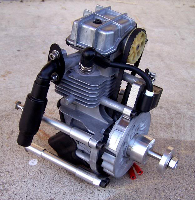

In the last month or so I have been talking to member Flyncrazy. He is very good at his craft, so what better person to get guidance from. I have a McCulloch I am going to send to him to do his magic. In the interim I have done a couple just to see what is involved. I can tell you, his fee is very reasonable for the amount of work it takes. My first was a 30cc homelite blower, and the second was a Ryobi 30cc 4 cycle.
[youtube]http://www.youtube.com/watch?v=bdd6q2JtMEU[/youtube]

What's the weight of that 4 stroke gasoline? Does it have an oil sump? What gas does it use? Any oil mixed in? I've converted a Stihl 4-mix to airplane, but haven't put it on a plane yet.

ORIGINAL: Pull Up Now!
It weighs 4 lbs 9 oz. it is a straight gas engine with an oil sump. the 4 mix is a better choice. this was just an exercise of construction. Many thanks to FlynCrazy for my pestering of 10,000 questions. Gary is really a guru when it comes to these conversions.
