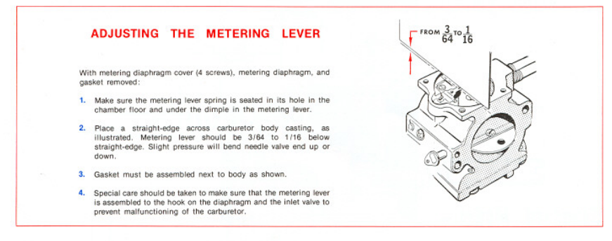

I now have the engine installed in the plane and I started it up this morning. It will start (with some difficulty) and run, but still not well. It will only run with the low speed needles open 1/2 a turn and the high speed needle fully closed. Even then, it runs rich at low to mid- range throttle.
It seems to me, that the lever now needs to be bent a bit more to reduce the amount of fuel being supplied to the carb.
The best advice I can find about the fuel metering lever setting is in this WB manual. Walbro advises that there is no manual for the WJ model!
As can be seen in the screenshot from the Walbro WB manual, the lever is set from 3/64 to 1/6 inch. The setting that I now have it is slightly more than this, and it is still not possible to lean out the mixture at any range other than idle speed sufficiently.
I am hoping that one of you Walbro experienced people will provide a comment on the above.
From the Walbro manual:
Edit:
By mechanic buddy Barry has just called in and we collaborated on the next change to the engine/carb/exhaust. One thing he mentioned is that the big exhaust (that is very noisy) might be offering too little restriction. Tomorrow I will fit the original chainsaw exhaust and give it a go without changing anything else. If it is still the same, I will adjust the fuel metering lever down further. The engine is obvious getting far too much fuel. But we agreed that one change at a time is a good strategy.
Edit:

Sorry, but your muffler is in no way a problem. It is a frustratingly persisting myth that engines "need back pressure". It is just not true. Off hand, the only benefit I can think of to back pressure is on a glow engine, to help keep the glow plug hot at idle, and this comes at a sacrifice in power. Before anyone says "what about an expansion chamber or other tuned exhaust?", those operate on reflected sonic waves, NOT back pressure.
Keep after that regulator lever adjustment, it is critical. You might also have a look at the high speed check valve in the carb
You might also beg, borrow, steal, or make a pop off pressure checker and do a pop off pressure check.
Edit: Last thought..... You are putting the regulator chamber gasket on first, and then the diaphragm on top, then the cover right? Lots of people put them on backwards, then have "too rich" problems.
AV8TOR
AV8TOR

I have actually made some progress this morning. Av8tor is on the money here it seems. I also have been suspecting that the pop off pressure might be the trouble, but did not know enough about it to tackle it.
I have two WJ57 carbs. So I pulled the fuel metering lever springs out of both of them and compared them. The new aftermarket one is noticeably weaker. This would cause a low pop off pressure and would explain why no matter where I bent the spring to, the engine could not be leaned out.
I now have the engine starting easily using the choke!
It will run ok and is good at mid-range and high rpm.
It will not idle and cuts out.
One of the suggestion in the Walbro chart for this, is sticking throttle butterfly. I will investigate after lunch.

I am delighted to report that the engine is starting and running nicely now. Three problems were found. First of all, the fuel metering pop off pressure was far too low! It was around 10 psi. The recommendation for this model Walbro is 15 - 25 psi. I adjusted it up to around 20.
Second problem was the spark gap was too big. Late last night I measured it a bit more carefully and it was close to .68mm. My pal Barry was here who has just built a race car and described the same problem with his modified Zephyr engine. Spark failure/flame out with throttle. He adusted his plugs down to around .020 (approx .5 mm). I did the same to mine, and now it take fully throttle without any miss-firing. Easy starting too.
The third problem was a leaking connection of the rubber manifold to carburettor connection. It slipped out slightly after I remounted it and ran it for a while also. I will machine a thin walled, flanged spigot to go inside it on Monday when I go into the Mens Shed. That will located it internally and externally positively.
We had the engine running nicely at all throttle levels. It was idling well, until the manifold rubber started to slip again and leak.
This problem will be an easy fix.
Many thanks to Av8tor for the pop off pressure test tip. And to Al for the intake leak. To Barry for the spark plug gap suggestion. And of course to Zagnut for his endless patient technical descriptions and corrections. To Bogbeagle and to all the others who have hung in there on this thread throughout this tiresome and sometimes boring saga!

I used a automotive cooling system pressure tester to test the pop off pressure of the carburettor fuel metering needle and spring assembly. I was able to push the pump handle in slowly, while watching and listening to the exposed needle and seat area. When it started to hiss I noted the pressure. It worked well. I will do a short video when I get to check the original carburettor in the same way.
edit:
I probably goes without saying that the very low pop off pressure is the reason that the engine would only run with the high speed needle fully closed. And it would not lean out properly. As a result, all my adjusting of the metering lever up and down was in vain; it did nothing!
edit:

I switched back to the original carburettor again after checking the pop off pressure.
It is running the best it ever has now with both needles fully closed! It is idling down nicely and taking throttle ok. Just running a bit rich at all throttle openings and revs.
I will have to bend the metering lever down more and give that another try.
Edit#2
Bending the lever did no good at all - again. I've been in this position before, and I'm going around in circles.
There is only one thing that can now be causing the above and that is the metering needle spring is too weak. (I did do the pop test and it seemed to check out within the specifications). However, I will stretch it 3 mm, replace it and try again next opportunity.
Another problem with the plane/engine combination is becoming evident. One of the batteries is running down in a rather short time. The elevators are vibrating at an alarming rate and at a large magnitude; I suspect that this is working the servos hard and draining the batteries. And the battery drain is only one consideration, needless to say; I hope the servos will take the punishment.
