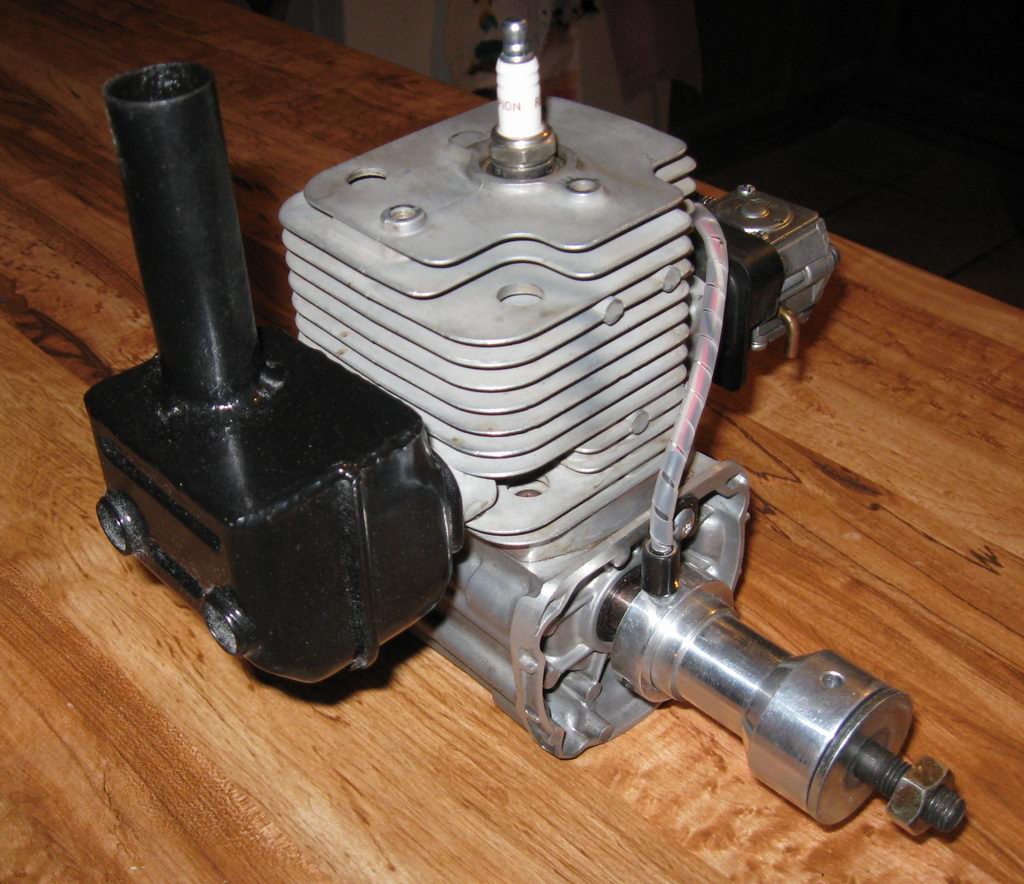

Does anyone know where I might be able to find an EI prop hub for this engine? It is the 33cc powerstroke engine from the Homelite Ranger and Bandit saws. I converted one years ago and ran it on the stock mag and it was a great engine with lots of power. I could even hand start it too though it had to be a very firm flip Lol!
I have no way of making this piece myself and I know guys have done it before. Thanks for any insight you could give!

I don't have a Homelite 33cc here to refer to to make you a prop hub. I've got one in storage about 200 miles from here but don't have access to it at the moment. Do you have your original magneto flywheel? I often make prop hubs using the center cut out of the magneto to fit the taper on the crankshaft, and then make a prop hub to fit against that. I then make a collar that goes around that flywheel center piece with a magnet in it, and it is adjustable for setting the timing. How are you going to mount your sensor, and do you have a pic of the engine??

I do have the orig. flywheel and I don't quite know how to go about mounting the sensor. I may just have to keep this one mag it looks like.

I turned down my flywheel and put in a magnet! Sethe my timing to 28 deg btdc. 18×10 xoar prop well in the 7000 range.
