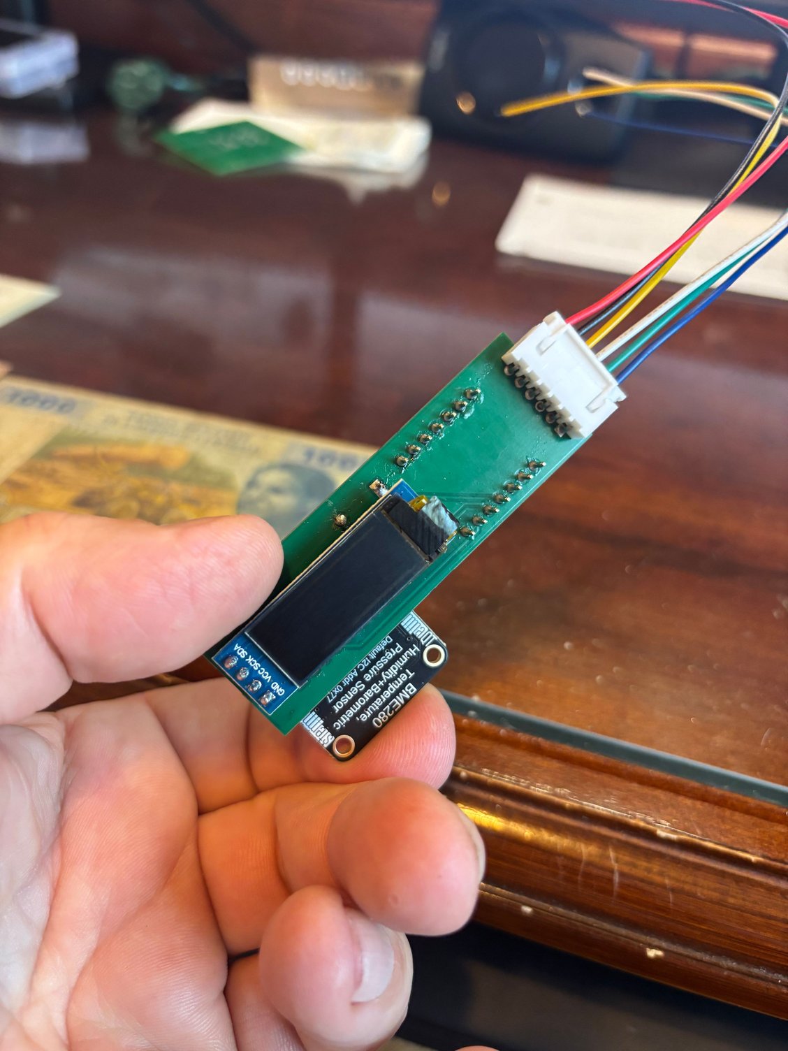

Bench unit for engine test stand complete.
Unfortunately I mirror imaged the pin layout on the BME sensor so now it sticks out above the board.
Back side with oled screen

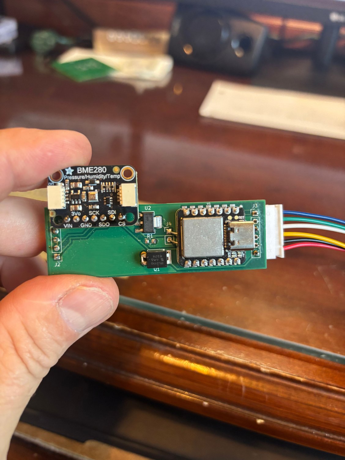

The inflight module with integrated BMP280 sensor and voltage regulator. I seem to have lost my spare seeedunios I had laying around so I have to wait until the new ones arrive to try it out. it is about half the size of the bench unit…

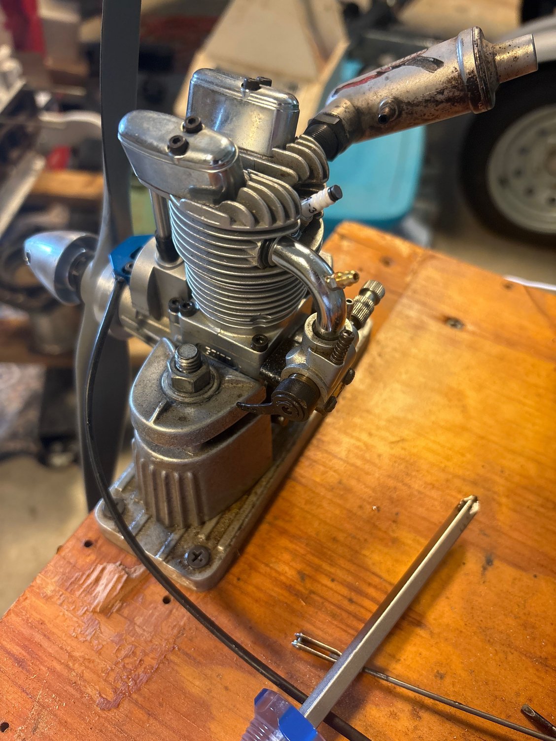

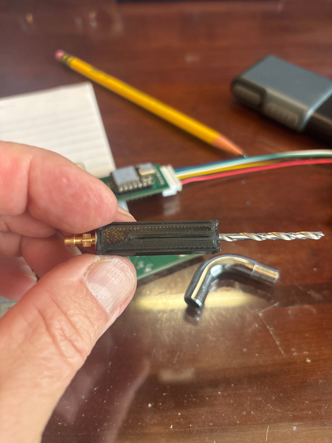

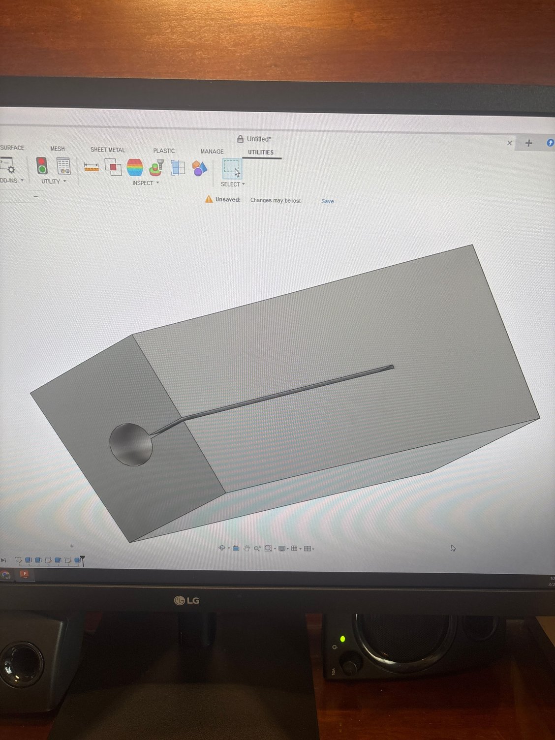

Simple air control for bench testing. I’ll use a drill bit shaft in the bore and a 6/32 pressure fitting on the “feed” end. This first test is with a .2 mm air slot. I’m not sure however if the 3d printer is going to like that.
Simple but……effective????

Air bleed valve complete. Drill bit shaft has a nice smooth fit after I drilled it out and worked it a little bit.
Now I just need to put an intake port on the Saito 72 intake.

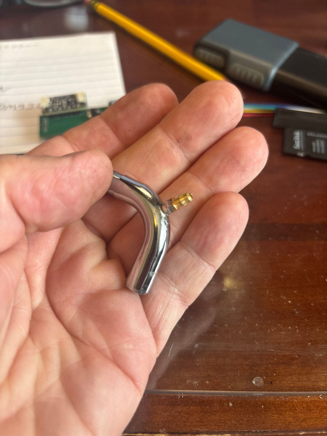

Intake tap complete.
Old 03-28-2026 | 09:40 AM
  #2894
xanaphyst's Avatar
My Feedback: (17)
Posts: 471
From: Montgomery, TX
Intake installed on Saito 72. Now I just need to rig it all up.
