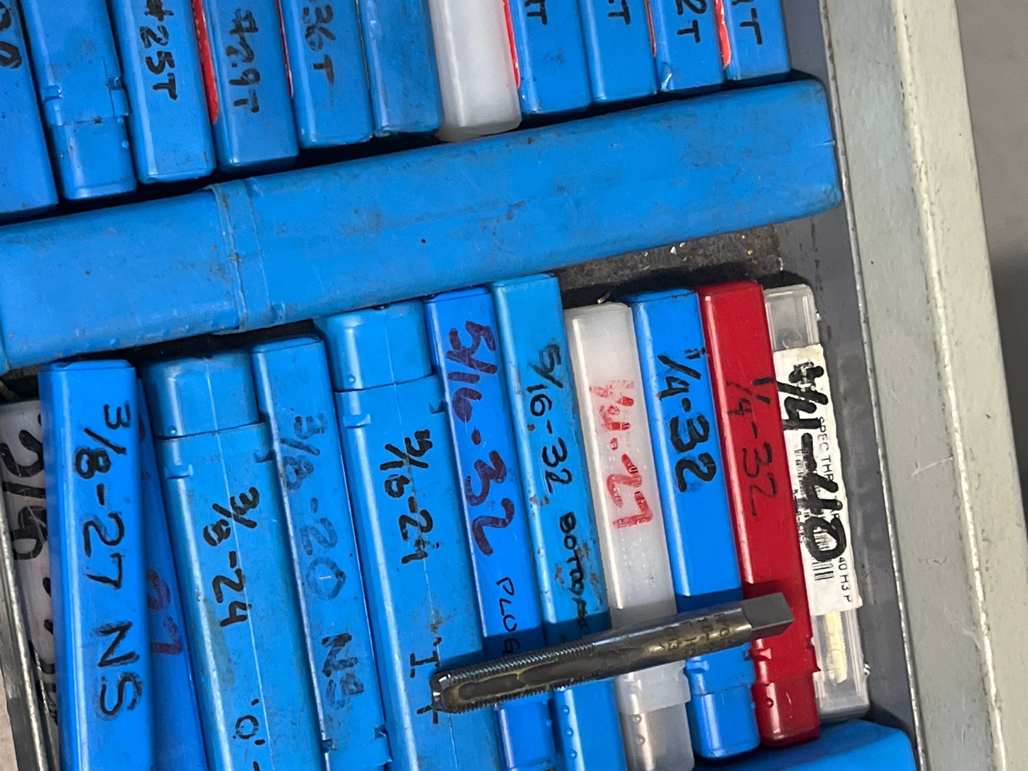

I have 7/16" C360 H02 brass, 5/16-32 plug tap and die on order. Should be here by week's end. I don't have a way to accurately synchronize/index the threads other than by trial and error, using an index mark on the tap. With a little luck I should be able to get them sync'd In a couple of tries and I do intend on short tapping the threads, a little more at a time, until the Timesert insertion tool swages the last couple of threads without excessive pressure.
The broken piece of insert I removed from the cylinder has a 32 thread pitch and the int/ext threads are not synchronized. My thread pitch gauge is barely visable once inserted into the insert bore but it appears to be 32.
You can use the 5/16-32 die as a guide to help you index the 1/4-32 tap.

Yes, an index mark on the tap and a light tap or two to set the tap so it bites straight away upon rotation should get the job done. May take a couple of attempts.
I found a club member with a 4" or 5" benchtop lathe. I'm sure it's good enough for this type of light work. I'd have one myself but need one so infrequently I can't justify the cost. I suppose if I had one I could create projects but have little interest in metal working. I do enjoy woodworking however and have a nice cabinet shop.

Yes I can cut single point threads and would only need the tap to create a go/no go gauge to get the outer threads right... I have a trick VFD drive on my old lathe and it makes treading a much easier task as i have the ability to drive very slowly and stop instantly.
This type of repair is better done with all parts on hand to get the fits correct - if you can find a "local" with the right equipment it might be easier - I am willing to give it a try though Lonnie but it might take me a while as I have a pile of work stacked up here..
#394
Thanks Jesse,
Here is how I would proceed - rough finish the insert and "short tap" it. Then using the tap as as a guide the setup can be made of the carriage to thread the OD . Because of the "flange" the setup would be a bit tricky and would have to be cut "upside down" and "backwards".

Rough the part, thread the OD and place a reference mark on the insert flange and the die, part it off, thread the tap into the die to tranfer the reference mark, install the insert into the cylinder and begin tapping the ID using reference marks. If the threading is syncronized I'll JB Weld the top couple of threads and let it cure overnight, then short tap the ID and swage the insert using the Timesert installation tool. If the threads are out of sync when I begin tapping the ID, it's a do over.
Am I on crack?
#396
Thanks, here's my plan based on my limited tooling:
Am I on crack?
Am I on crack?
I have no idea about your substance abuse habits, but I would say you're on track...

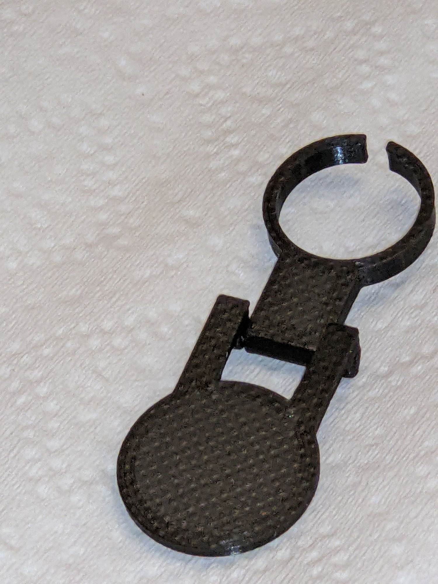

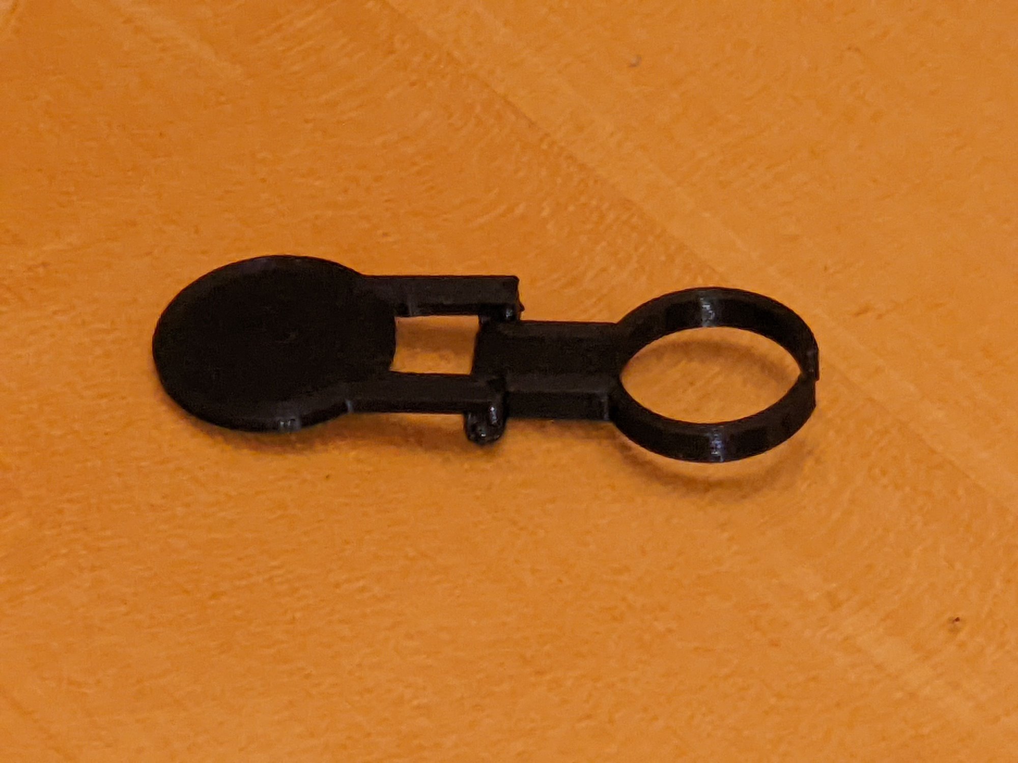

I had an opportunity to do a rather small print yesterday evening with the layer set to 0.12 mm thickness. Printing is fairly slow at this resolution but the output quality is excellent. I'll try to get some better photos for you. For reference, the open circle which clips around the lens on my web camera is 14.7 mm in diameter to the inside.

looks like the printing is progressing quickly.... making small parts is a setup and method onto itself..
Hope your not sitting there watching the machine print. I wasted about a year of my life on this endeavour
Its strangely addicting.
