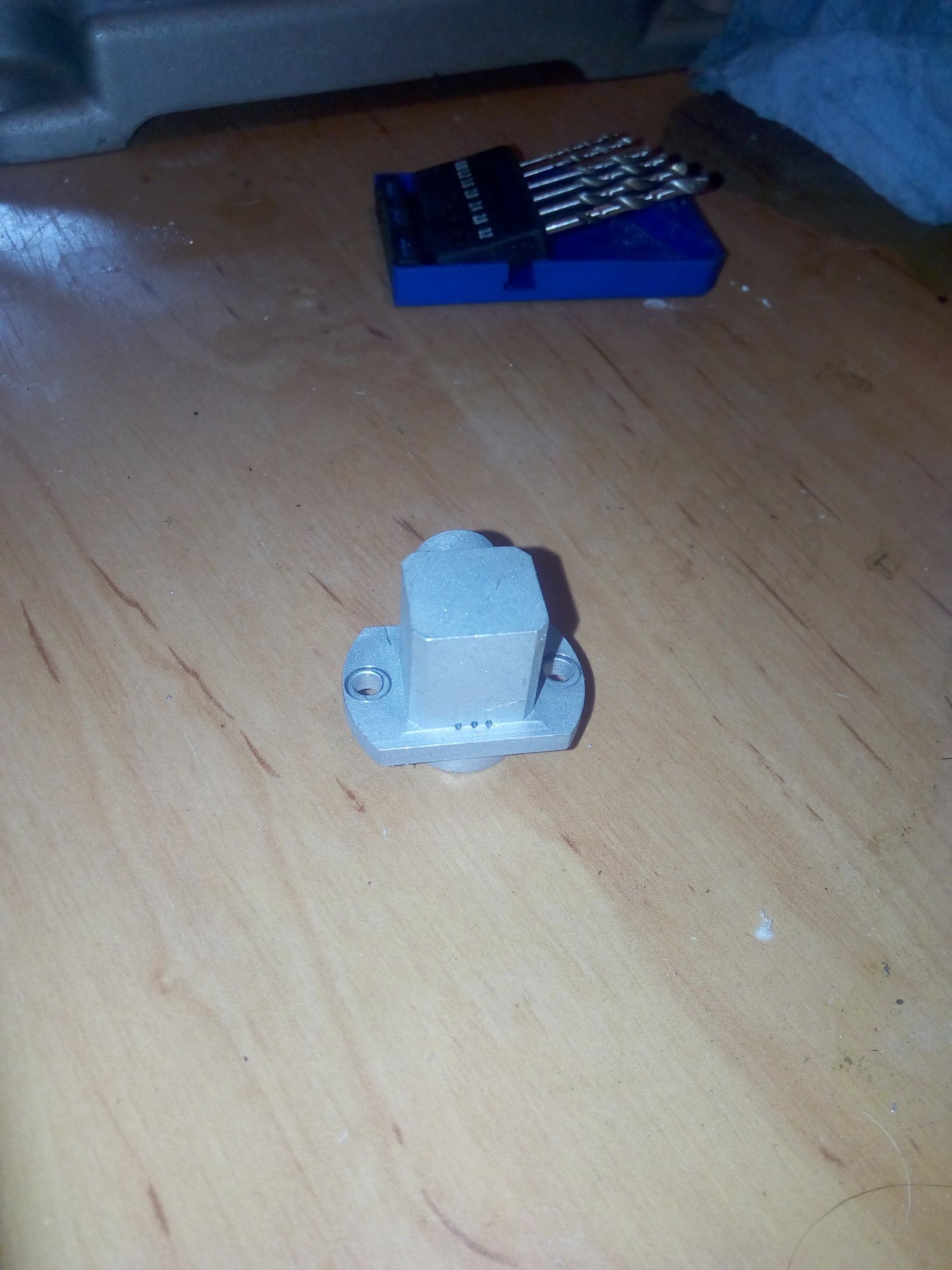

Looking at that peashooter, I would not worry too much, it looks like it won't be bothered too much with an additional 500 grammes.
My Seagull FW190A has the ASP radial, which weighs in at near 2,8 kilo. The plane turned out to be built such, that had I fitted a lightweight 40 or 50 cc gasser 2-stroke I would have had to add lead to the nose anyway, as it balanced perfectly with the radial on. So the plane would have ended up exactly at the same weight regardless of a lighter engine.
Then again, you can push forward the decision of which engine, after you have your hands on the plane, right?
As for those aftermarket intake mods offered, I am always a bit suspicious, because usually there are way easier and cheaper options.
My ASP also had a TERRIBLE fuel distribution, and I solved it by simply drilling 3 holes 0,8 mm in the intake elbow. The mod is basically free (OK... a drill bit set including 0,8 mm costs maybe €3,50) but the trick is to know where and how to drill...
Fixed it right up, from this:
to this:
The difference might not be all that audible, but it is not just 4~500 RPM more, it also is a throttle that responds over the full stroke and much more equal cylinder temperatures.
What basically happened was that fuel distribution would vary with throttle opening, so from about half throttle, cylinders that were rich to begin with would go lean and vice versa, resulting in basically no change of RPM, but a lot of change in temperature.
Before the mod, I saw differences in cylinder temperature of 80~100 deg C, after the mod, that reduced to 40 or less. Also, the oil residue from the crankcase cleared up noticably.
Sometimes, people think too much in terms of "I've got a lathe and machining skills", and not enough in terms of "what could be the actual problem"
to this:

On the ASP, the intake system consists of a central intake hole, and a set of spiral shaped channels. Looks like this:
Assumption on my side, but I think this is done to prevent that the lower cylinders flood with oil/fuel at standstill: there is not one single intake that has a straight downward path, so gravity cannot do its dasterdly deed,
The fuel/air mixture enters in the brass ring, which has 5 holes drilled into it.
On the outside, the carb is fitted with a 90 degree elbow, and oriented such that when the engine is mounted according instructions, the intake mouth points down.
Again an assumption on my side, but I think this also is done to prevent any fuel possibly syphoning, to run out, instead of into the engine flooding it.
The engine is pictured here tilted roughly 30 degrees counterclockwise. In manual-prescribed mounting orientation (cyl 1 vertical upwards), the carb is below horizontal by 54 degrees
Now this elbow, and the brass ring in the first pic, THEY are the problem: the fuel/oil/air mixture directly behind the spraybar is not yet a homogeneous mix: it's air, vapour and droplets.
When that mixture has to pass the 90 degree bend, inertial forces separate this mix, air/vapour follows the change of direction but the liquid ends up at the wall opposite of where the carb is.
So that liquid does not enter the brass ring in the middle, but at the circumference, favouring 1 or 2 cylinders over the rest, And because the carb is a normal glow carb, with a laterally moving throttle barrel, the throttle position affects which cylinders exactly are favoured, because as the FT160 demonstrated, the amount of throttle opening affects WHERE exactly that liquid ends up at the wall.
What do the three tiny holes do?
When the engine is running, there is intake vacuum, IN that elbow. So air will rush in through these three holes. These holes are by the way, drilled under an approximate angle of 45 degrees, they are NOT perpendicular to the intake bore. They are also drilled parallel, not radial to the centreline of the bore.
Now, mixture comes into the elbow, passes the 90 degree direction change, and the liquid fuel/oil ends up at the wall of the bore. when that fluid passes the three bores, the inrushing air blasts that liquid back into "suspension" in the airflow. Turbulence, velocity and kinetic energy do the rest.
It is not perfect, but WAY better than what it was from the factory.
That is how it works.
MAIN reason for taking this route was that I could do this in literally 10 minutes and a 1 dollar drillbit, as opposed to sourcing large barstock Aluminium and spending days behind the lathe (I can handle myself, but am far from skilled, so it would take me ages).
But thinking about it a bit more, I arrived at a few conclusions that make me feel, the expensive commercially availlable mods are not all that desirable.
To me, the downsides of a "negative crankase pressure modification" would be:
-Oil lubricates better than "fuel dilluted oil", Although this has in other engines never presented a significant problem, it remains a fact that a negative pressure crankcase means the crankshaft and rods are lubricated with diluted oil instead of undiluted oil. Personal preference.
-Radials do not, like 2-strokes (and most fourstrokes) have a labyrinth at the crankshaft, meaning that the entire functioning of the engine becomes dependent on the quality of the forward crankshaft seal.
This splits in two, IMHO rather nasty consequences:
-If the seal starts leaking, but not yet enough to disturb normal operation, the air ingress in the front of the engine, will scavenge lubrication AWAY FROM the cam drums and associated gears. So there is a real risk of accelerated valve train wear while it will not be immediately obvious to an operator, what causes this accelerated wear.
-progressing deterioration of this seal, will cause inconsistent adjustments, again, without its cause being immediately obvious.
-A full faillure of this seal will disrupt engine operation, period.
The big deterrent for me is, replacing this forward crankshaftseal (big words for "bearing replacement"
) requires a FULL dismantling of the engine, And there are assemblies in a radial that are sensitive and pose a certain risk when dismantling: A :censored: crankshaft seal replacement should NEVER require that kind of risk.
The literal only thing that could possibly go wrong with my solution is a clogging of the holes, and that can very easily be fixed without even taking the engine off the firewall... It has zero effect on the mechanical properties of the engine at all.

Basically, it is impossible to get an EXACT equal fuel distribution to all cylinders, and this distribution is influenced by many factors, in other words, it is most likely not the same at every RPM. As long as these imbalance is within a certain range, this is no big deal, after all, nothing is "perfect", right?
Fuel/air ratio determines ignitability of the fresh charge, and this is what we adjust with the needles. In a single cylinder, things are obvious: too lean is too lean and too rich is too rich. Not so in a multi: Leaning out, ONE cylinder gets too lean, making the entire engine appear lean, while in reality total average fuel/air ratio could very well be on the rich side. Fattening up that single carb, could very well make ONE cylinder (another one, no doubt) too rich, making the entire engine appear rich,
Usually, distribution is most equal at full throttle (not "perfect", because nothing is, but "most good")
Now what happens when for example at idle cylinder 1 is getting significantly too rich (so you lean out the entire engine at idle to make it run better), but at midrange and higher things even out? Then the engine tends to run lean at midrange at at least ONE cylinder, and again, that makes the entire engine appear to be lean. So you set the LS needle a bit fatter to have a good midrange, and you're back to that rich idle.
And all the while, it is very possible and even very likely, that the "total average" fuel/air ratio is within acceptable limits throughout the entire rev range. The engine is running, after all, isn't it? So at least SOME cylinders should receive an acceptable mixture.
The carb might therefore very well have an overall good fuel linearity, but if the fuel is not equally distributed, the engine is never going to run really well.
So efforts to keep that mixture distributed as evenly as possible, will improve running on ANY multicylinder engine.
The holes only are an attempt to keep the fuel suspended in the intake airstream as good as possible, making fuel distribution as equal as I can get it. They do not serve to correct rich or lean spots. But they definitely have an effect AS IF they correct rich or lean spots. Because the rich and lean spots you observed, are only "apparent", they are not real as far as the carb is concerned, they are caused by unequal fuel distribution. They are NOT an airbleed, and are NOT tunable, because that is not their purpose. Their total cross section as well as their effect on fuel/air ratio per se is negligable.
So, the holes do not serve to tweak the fuel linearity. That is the job of that electronic device that is at the base of the title of this thread. It basically makes that LS and HS needles and their correlation do not really play a role anymore. What we do is set a more or less "random but acceptable" LS setting and HS setting, and once that is done, these needles are left alone. The entire throttle range, fuel is controlled by a curve programmed in the transmitter, and basically we have for each conceivable throttle position a separate needle, in an indefinite number. I can literally set mixture independently for idle, 10% throttle, 20%, 30%, etc etc etc, all the way up to full throttle.
And when the weather changes, the ambient temperature, the barometric pressure, or even the flying altitude, this is corrected automatically.
