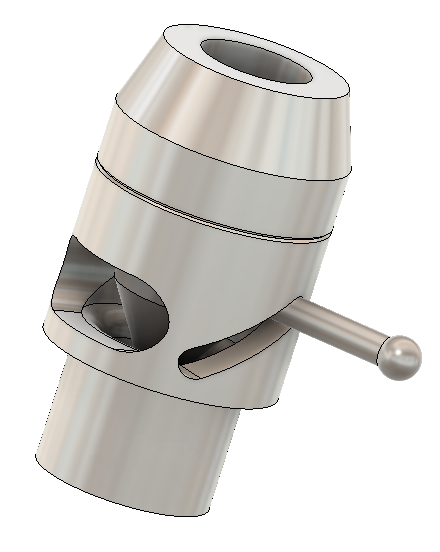

Originally Posted by cmulder
What are the cost to run a 5 axis cnc each hour? Including things like writeoff, maintenance cost, lifespan cutting bits, setup and electricity.
Add a reasonable wage for the operator, cost of packing shipping, order processing.
I would be verry surpriced if the price of a carb and electronics set would be less then €250.
There are many modelers who have no problem with spending this kind of money (cough turbines...) if it makes there planes fly better.
But you are basicly looking at starting a small company.
Comercial production does not have to contradict "open source" prusa for example is quite succesfull with there printers.
There design files are avaiable but its just cheaper to buy from then then to try to make the parts yourself.
I had the solenoid housings made and they came out around 15 Euro a piece. That is just the lathe work, not the finished product, BUT it has been manually checked for dimensional accuracy for that money. The side port we needed to drill manually and the tubing I glue in manually.
The CNC lathe takes about 5 minutes, a bit more, per housing. Going by that, and a throttle body being about 25 minutes for the CNC mill. I'd say that if I had to estimate, I'd think a body would at least be about 50 Euro, and probably there would still be some small finishing jobs to be done for that money, like the threads for the fuel nipple and the holes for attachment to the motor.
The insulator sleeve most likely would be mere euro's (5 or so, they are simple pieces, the lathe spits them out dozens per hour)
the throttle barrel is probably between 10 and 15 Euro, given that it is a rather simple piece to turn but also has a cross drilled throttle bore.
That is just a very careful estimation. I could ask my friend.
I would say, if I would change the design to say four sizes (7,5 cc/.45, 10 cc/.60, 12,5 cc/.75 and 15 cc/.90) I could keep the boss a bit small and supply different insulator sleeves, but that still is a huge hassle, and then there are engines that require threaded holes in the boss (like OS and ASP) and there are engines with a pinchbolt, but also engines with grubscrews (Irvine) and some dimensions are metric while others are imperial.
I keep butting my head against the wall of the need for these things to be made to fit a particular engine and I don't know how to make it more versatile (how to ensure that the .45 size will actually be able to be fitted to ALL .45 engines, etc...)
Have a look here: Perry Pumps - Carbs
I am aware of the Perry carbs, but those do not always fit ALL engines... And that is a bit my problem: IF I am going to try this, it needs to be affordable, AND it needs to be usable on ANY engine.
Otherwise it is better to buy a Saito FG series.
I mean, as it is now, a conversion costs the price of an ignition and roughly 60 bucks for the valve and associated stuff. That is doable, especially if there is allready an engine.
But if one has to buy a (used???) engine, an ignition, and the price of a throttle body, solenoid and electronics, the total cost is going to approach the price of a brand new gasser, and then it becomes pointless.
Something that COULD be an option, is to make valve housings with a threaded part that would fit into where the NVA screws into the carb body. It would maintain any possible airbleed or LS needle the carb allready has (solving the issues with idle stability), it would look "nearly the same" but again: not every manufacturer uses the same thread size for the NVA, and the absence of an orifice such as Chris and Rob use still would be a possible issue...

Originally Posted by 1967brutus
I Something that COULD be an option, is to make valve housings with a threaded part that would fit into where the NVA screws into the carb body. It would maintain any possible airbleed or LS needle the carb allready has (solving the issues with idle stability), it would look "nearly the same" but again: not every manufacturer uses the same thread size for the NVA, and the absence of an orifice such as Chris and Rob use still would be a possible issue...
Unscrewing the needle valve holder and screwing the solenoid holder in place would make for a simple low cost conversion.
You could even go as far to include a small screw to plug the fuel nipple hole and reuse the nipple on the solenoid holder.
O.S. appears to use the same size holder on a whole range of carbs for both plane and heli engines.
What could be done is have a 2 part holder design.
The (possible delrin? )cup that holds the solenoid would be the same for all and then pressed into that a (bronze?) tube that is made to fit the original needle holder.
Thinking of it a bit more why not reuse the needle holder too?
Make a cup design that the needle holder has a snug fit into and secure it with a setscrew from the side.
A small "O" ring inside for the holder to press against should avoid any air leaks.

There is a major flaw in this idea: taking the HS needle out exposes the full diameter of the valveseat to the fuel flow, in other words ALL metering has to be done by the solenoid. That will result in such low values of the fuel curve that there is no more resolution to adjust....
The solenoid is merely an "on/off switch" for the fuel flow, but there still needs to be a tailored to the engine fuel restriction in order to make the system work. In Chris' design that is the 3D-printer nozzle that is selected to size.
In my set-up that is the HS needle, in the Stihl configuration there are restrictors in the carb, but if we take out the HS NVA and replace it with simply a solenoid, there is no such restriction.

On request of Rob.M, first flight vid of his rendering of Chris' throttle body design.
He has, in the mean time drilled a 1,1 mm airbleed port according Chris' drawings, and reports a very much improved idle in flight: Without the airbleed hole he saw an irregular idle in flight, the airbleed hole stabilized that.
Personally, I am a bit confused by that, because Dave way back when he converted his Boxer had issues trying to use the airbleed that was OEM present in the carb of his engine, and in earlier experiments of mine, the airbleed adjustment also was problematic and that was putting it mildly. My experiments back then were pre-solenoid admittedly, but Daves tests were WITH the solenoid.
Whatever the case, to me this sounds like a pretty good running engine, and according to Rob, top RPM in level flight has remained the same (12K) but throttle response improved in that it is more accurate and predictable (and it was allready pretty good previously if you ask me).
What if there is a small plastic disk under the fuel nipple of the solenoid casing with the hole in it?
Also in setups where the solenoid is external from the carb just plugging the hole where the needle holder used to be might work too.
Then just use the original fuel nipple and possbly install the restriction disk under that.
Not having a needle stick out will make the carb much less vulnerable to crash damage like the os la series of engines.
On the other hand the simplicety of just mounting it on the needle holder also has advantages in other situations
It is a bit hard for me to do this from behind a laptop at sea because I have to do this all looking at it with "the minds eye" but thinking more about it, I would think that fitting a solenoid housing into the location of the NVA would stick out quite a bit and be every bit as vulnerable for crashdamage as a regular needle. I am less and less convinced of the practical advantages of such a set-up. Or at least, that they do not outweigh the hassle.
I am hesitantly coming to the conclusion that Chris' design for me is not feasible to have it made even in limited production. Too many variables. Very suitable for anyone with the capabilities to make one, or access to somebody that is willing to make it. Maybe Chris can do something with this, but I cannot. Not within a "reasonable amount of effort" and not for a price I would myself be willing to pay for it.
I am very sure that in time, I will have at least one of these Chris-Tech Throttle bodies (how's that for a brand and product name? ) and I am sure, more people will at least try and do this.
But for, just as an example, the fourstrokes, I'll probably stick with the separate solenoid housings as before. Because fourstrokes are a different animal alltogether when it comes to heat isolation of the carb, and what's worse, they near literally all have different designs for carb attachment and stuff, WAY too much trouble to redesign for every separate brand and type.

OK.. was trying to think of a way to make a throttle body that is adaptable to a wider range of displacement. That triggered a memory of the Martin (M&H) carb that used a unique arrangement that offered what is essential a variable Venturi. The original had a complex system of fuel passage to regulate fuel supply but I think it adapts well to having a solenoid stuck on its head. Three parts - solenoid mount/fuel nozzle - Body and rotating "plug" valve. The plug moves up and down using an angles slotted path for its actuating arm.
might be a winter project this year... I don't think it solves the problem of making these for general consumption but I think it looks cool
Back in the day, I spent hours trying to figure out if this design could be modified to use gasoline (pre-solenoid days).
Never thought about how it might work with the solenoid incorporated.... Interesting new light on things....

Thats a pretty neat idea Cat, certainly keeps it compact, definitely worth the effort..
