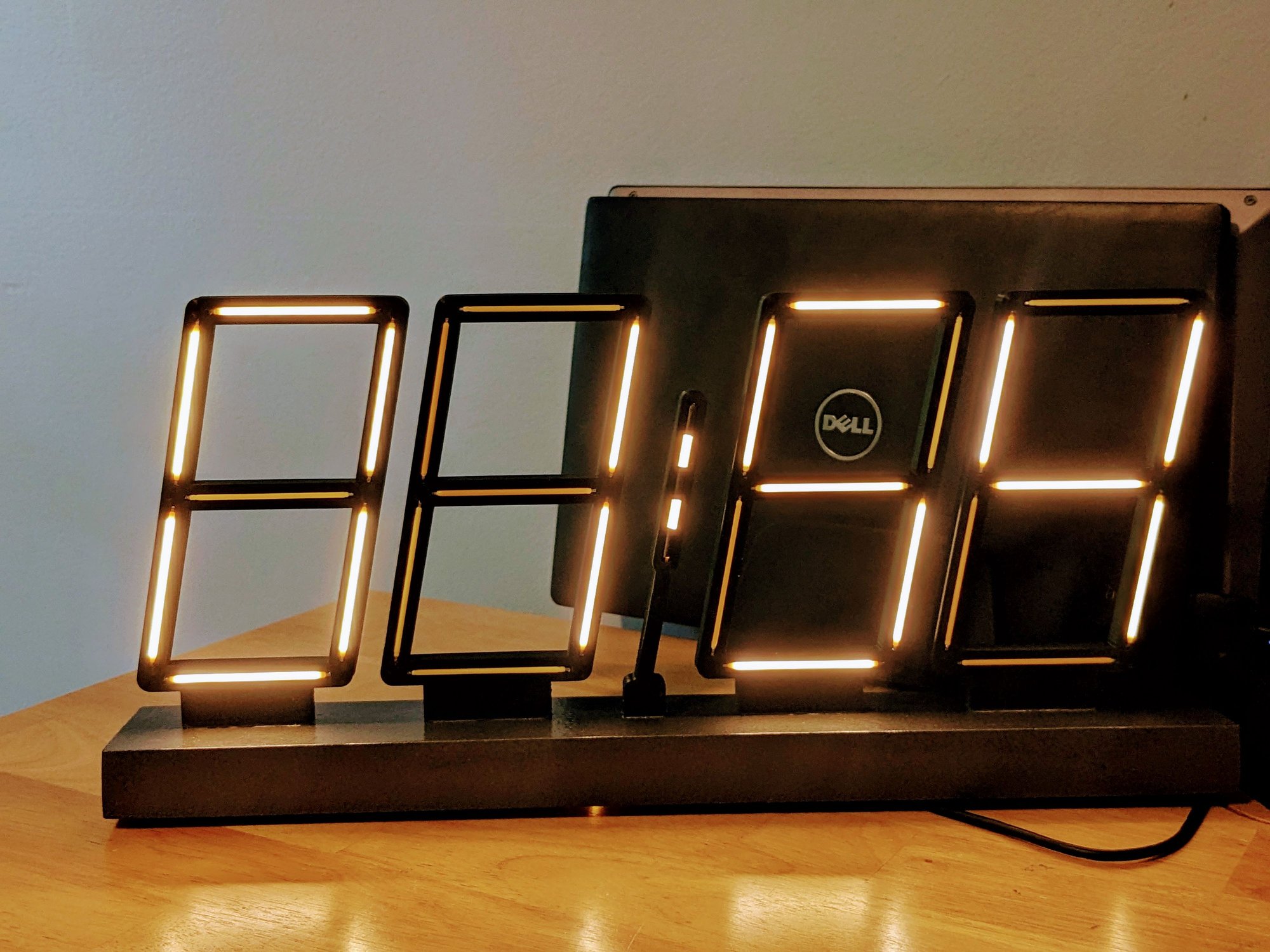

I just finished this clock...
with digit driver's using uln2003a chips which are 7 Darlington transistor pairs with base resistors all wired up in a 16 pin dip package. It'll work great with 3 extra Darlington pairs unused (for now). This should make wiring very easy.
I'm off to breadboard the circuit and write some code....
