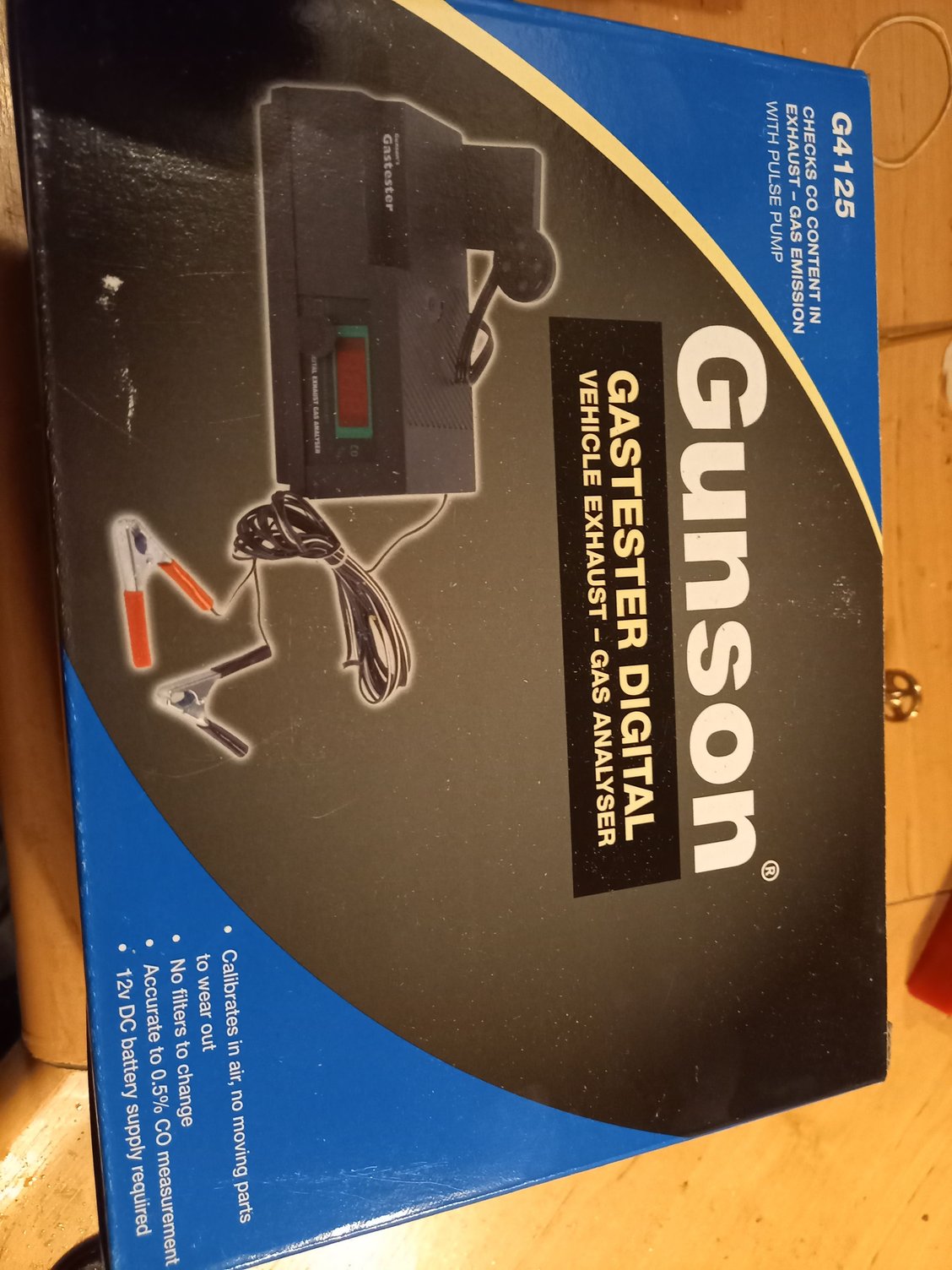

Hey guys, look what I got....
primarily for adjusting the carburettors of my bikes, but definitely going to try measuring the exhaust gas quality of our toy engines.
Not because it is somehow better, but because I would like to LEARN... which numbers make an engine run good, and which don't. What range of mixtures actually are "acceptable", what effect results from which modification, etc etc.
Most important of course: WOULD such a device be "usable" or not?
Remember folks, we're testing this so you won't have to
Haven't even unpacked the thing yet, but here's what I think: Most likely it will be pretty difficult to get consistent readings, and most likely an adapter of sorts will be necessary in order to get reliable and repeatable numbers.
But hey, I won't know unless I try, right?
It can take a while before I'll get around to it, but will keep you guys posted as soon as I have any data.
Edit: on the trusty old Ducati, it seems to work fairly decent and repeatable.

In a minute or so, gonna try if I can get a decent reading on my little gasoline powered launch.
5 cc (.30 cu.in.) at fixed 1500 RPM... Curious if that is going to work...

At least, once I managed to figure out how to get a halfway decent reading with such tiny amounts of testable gas (about 1/6th of a cu. ft. per minute is not much), I also immediately learned that a change in setting, with this measuring principle, takes TIME to effect a change in readout.
I also learned that this engine too, needs several minutes to stabilize its behaviour after a change in settings.
The engine is externally governed, which means that when changing the needle setting, the governor immediately counteracts, so the RPM stays the same, the exhaust note stays the same, and tuning by ear becomes totally impossible. The only tell tale signs basically is the stability of the governor output signal (how much the throttle servo has to correct to keep the engine on set RPM).
Long story short, it took me about 10 minutes to get a reading I could thrust. It turned out that CO level was very high at 10% before adjustment.
It took 5~6 minutes of carefully manouvering with the needle to get the CO level down to 2,5~3%, and once that was accomplished, it took another 3~4 minutes before the new setting took effect and the throttle servo gradually became less nervous and active.
Exhaust effluent also became near invisible and a lot less smelly.
Going to let the engine cool down completely, then do a 2nd run on the same settings.
I expect a bit of a stubborn engine as long as it is cold, because I had the needle leaned out about 7 or 8 clicks, leaner than I can remember it ever was...
What can I say? It SEEMS to be a viable way of adjusting model engines, but I still have to figure out a way to get good exhaust gas sampling on a plane engine (I expect the propwash to be a practical difficulty to overcome).

build a chamber that attaches to the exhaust pipe and connect the exhaust gas monitor to the chamber. make it small so there's less volume/dead time in the readings. make it big so there's minimal added backpressure to the engine. make it small so it travels easily. make it big so you don't lose it. i guess the only constant here is to make it. is that good enough direction/input?
All options passed my brain, haven't picked one yet...The device claims to be "pumped" but actually it isn't, not really. It has a diaphragm chamber with non return valves, and it relies on the pressure pulses of the exhaust gas to make that membrane oscillate. The clicking noise indicates positive gasflow to the measuring cell. But the thing definitely needs something.
So most likely I will make something like a small T where the feed from the engine is opposite to the line towards the device, so the pressure pulses directly hit that "pump" thingy. Should not be too hard. More like it needs to be dimensioned such that I can hook up a great variety of different engine sizes.
I'll figure something out.
In all fairness, I expect the aero engines to run pretty decent. I more hope to be able to get some sort of "baseline measurements" from that, that possibly would allow to for example set curves such that CO levels remain by and large constant over the entire throttle range. But honestly, I first have to learn what kind of CO levels these engines feel happy with.
I don't expect needing one to set up my engines, but it COULD be that I will be able to provide additional info. I have seen a few people now that for one reason or another never managed to develop the "ear" to tune an engine. Perhaps for those it can be of help to figure out how to set up a fuel curve using this or a similar device.
It's not a cheap device, but also not prohibitive expensive. I don't know what these things cost in the US, I paid about 200 Euro. Fair bit of money, but I am going to use it on the Ducati as well, so I figured it was worth the money anyway.

Bert, this is probably obvious to you but sitting here thinking, I ask myself, why would one of Bert's engines be running heavily rich? Do marine props unload? Does it vary with surface speed? Maybe the engine doesn't unload at all in the water at 1500 rpm? I mean, I can see running rich on the ground to compensate for unloading in the air but I honestly don't know the first thing about marine applications.
It is literally as if you are blindfolded in the middle of a room, and you only know you're at the wall when you bump into it, but as long as all the walls are outside of arms length, there is no way of telling where you are: Left, right, centre, it's all the same untill you reach a limit and then the engine stalls.
Measuring the exhaust gas "quality" for the first time ever allowed me to make targeted adjustments.
The only thing I knew were "lean=> hard sudden stops" and "rich=>stops that more or less announce themselves" but inbetween, as long as the engine was running, no way of telling where I was. Because of the "lean hard stops", the natural tendency is to err on the safe side and that's how I ended up with a rich running engine.
Of course, there are tell-tales like the colour of the oil residue, or the pollution level of the spark plug, but those indicators literally take HOURS of runtime to reveal themselves, and are at best suitable for confirmation, not as a basis to make adjustments.

That's a neat little co analyzer Bert... what did it cost you if you don't mind me asking... if it's accurate, will give you a lot of info on air / fuel mixture combustion efficency... I have one of snap-ons handheld 5 gas analyzers, only issue with using it on premixed fuels, you have to protect the probe end from the oil contaminating the tip... I tried it on the GF40 with the exhaust tube placed inside a glass jar and the probe end separated by some cotton wool... it seemed to work well, just the cotton slowed down the sensors response time, but for carburation, not really an issue.
#2073
All in all with delivery it was about 200 Euro, and it's a single gas tester (only CO). But it is said to be maintenance free. No cleaning, filter replacement, wearparts or anything.
It has a built in moisture separator.
Stated accuracy is about 0,5% but it reads in 0,1% increments.
So far only tested ONE engine, but it allowed me to "adjust the unadjustable" from the get-go, and I learned a bit about fuel linearity that I had no way of knowing otherwise (this engine has "accoustic" carburation (fully analog, no solenoid enhancements or anything), and with a bit of luck, I will be able to get an improved fuel linearity by tweaking the air restrictor that maintains fuel draw when the throttle opens.
Without that restrictor, the carb lost draw when the throttle opened, causing the mixture to lean out and in turn this required an overly rich mixture at zero load. Not good.
The restrictor cured that as far as I could tell, but apparently I overshot the linearity a bit. Gradually opening the restrictor while repeating measurements might result in an even better tunability.

That's a reasonable price Bert... the readings are + or - 5%, from the 1% scale, still accurate enough to tune with... any mention or precautions regarding oil vapor using pre-mixed fuels, or 2 stroke oil injection... the water separator will catch some oil vapor, but I would still take measures to protect the sensor from oil contamination.
It will also show a change in CO with base ign timing changes, especially with your custom cam profile grind & valve timing changes you made with that particular putt putt boat engine... post another video when you get it all setup, I enjoy watching your boat projects.

Very interesting project branch Bert... I think this could be very helpful it finding the set on those hard to tune conversions. I have noted a few times that these conversions have a wide band of acceptable "running" adjustments that will only show secondary issues in the form of dirty exhaust or running changes with Ambient and engine temps excursions to high our low. The ability to tune and observe actual mixture conditions is a very good capability.
On the item of the sample not being actually pumped - do you think one of the little air pumps I use for tank pressurization might be of use?
