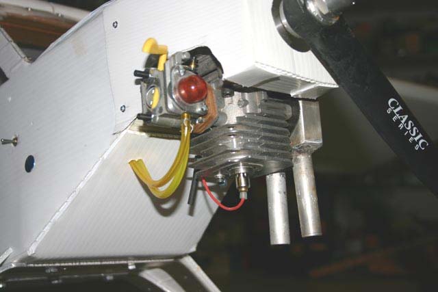

The carb is mounted that way, that the regulator hole is facing backwards (the firewall). I wonder what kind of effect the moving air might gave on the preasure measured in there. Look at the picture below.

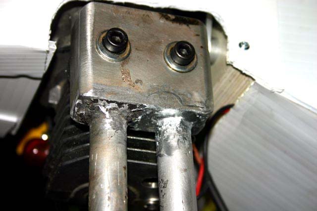

On the good note my muffler is holding up. This time I used welding rods I bought at Harbor Freight Tools. First I cleanded the muffler well with dremel (sanding drum) and brake pads cleaner. Then I wrapped the muffler in glass cloth to prevent from heat to escape and mounted in vise I used standart butane torch. I was able to heat it to the rod's melting point. Working with the rod for a couple minutes I achieved wery good spread and looks like a solid bond. So far I had 5 flights and the muffler is holding up (on the picture the pipe on the right side).

RysiuM: Forgot to say...that is a strong looking weld you done on muffler. Maybe I will get some aluminum sticks from Harbor F. Capt,n

I'm to cheap to do that While my son was answering the door and children were screaming on the street I run my late and in not long time I made my own piece. I used derlin (lighter and cheaper than aluminium) as I did not have such big aluminium rod laying around. On the picture below you can see it already mounted on the plane. On the second picture you can see a a vent cover that is facing the firewall. I will modify this if velocity stack doesn't help.
