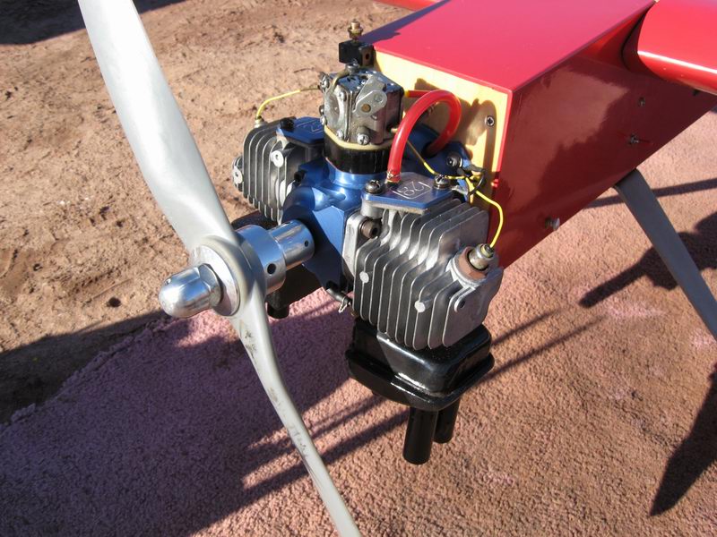

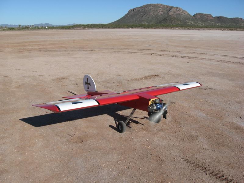

av8tor1977's Avatar
Joined: May 2003
Posts: 7,245
Received 6 Likes on 5 Posts
From: Tucson, AZ
Default RE: gas fuel with glo plug no ignition
Congratulations! It's a neat system. I have now put my Echo twin cylinder engine on my Giant Stik, but I had a Poulan 42cc on it running Gas/Glow. It pulled really well. That Giant Stik is fairly heavy, but the Poulan didn't seem to notice and would pull it straight up until I would quit. Very short take off runs as well.
Here's a couple of pics...
AV8TOR

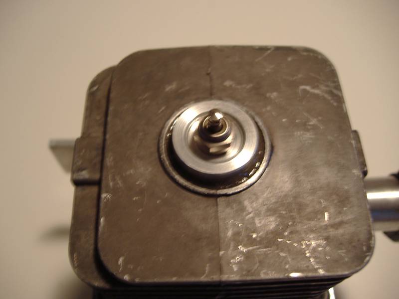

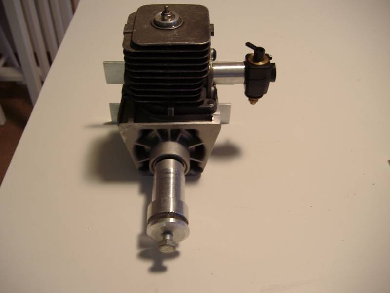

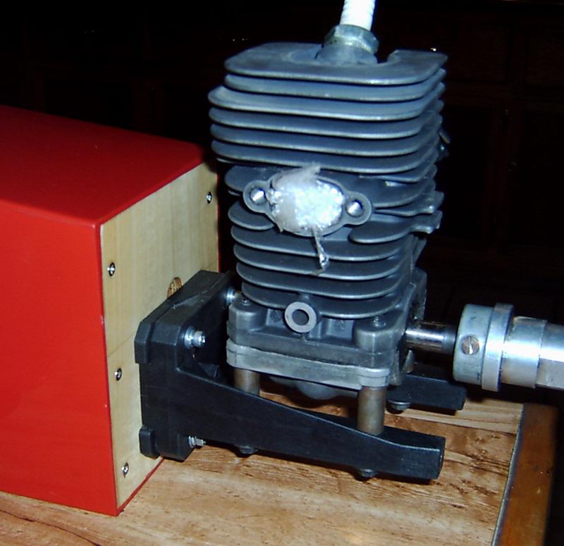

Joined: Dec 2006
Posts: 390
From: , GA
Hey yall, I have a 25cc Homey on glow running a Perry carb for 25-35cc engines. It runs very well, turns a 16x8 around 7800 it is much lighter than a Walbro and much easier to set. I have timed fuel consumption through 3 entire tanks @ WOT and it burns slightly under an ounce a minute. The Perry is easy to find and the intake is easy to make. I made the glow adapter from 3/4 rod stock and machined it as thin as possible to keep the plug low in the head. I run no gasket under it, it is red Loctited in place. I have enclosed a few (not real good) pics.
ID:	836331   Click image for larger version
ID:	836332   Click image for larger version
Old 12-29-2007 | 05:29 PM
  #1898
KI8FR's Avatar
Joined: Feb 2004
Posts: 976
From: Ovid, MI
You did a grate job on that one. Now you have that one running on just glow no gas in it at all?
Nice work.
