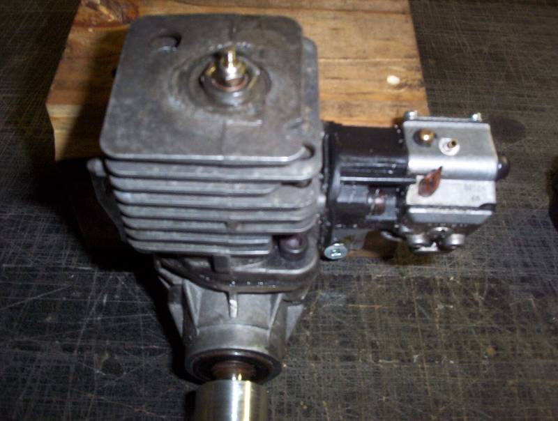

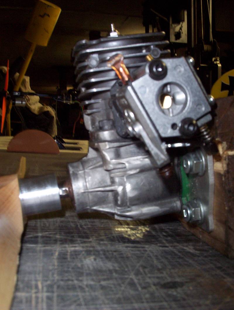

Here are some pics of my weedeater conversion. Captainjohn, see the pic of the regular automotive sparkplug and my glow plug adapter, you will see that i cut it in two places and then ground two flats so i could use a 9/16" wrench, once cut the ceramic will almost fall out, you are left with a 3/8" hole at the top but there is a shoulder at 5/16", i drilled this to .36" and pressed in the 3/8" aluminum rod then tapped it to 1/4-32. Still no muffler or velocity stack on this engine yet and i'm getting 7200 rpm on a 17x6 which looks like it will be good for my 9'-10' B2 bomber spad that i'm getting ready to build.

OK fellas yall convinced mt to try gas/glow in my Homey. Without searching back thru 77 pages, tell me exactly what to do. I have a new jug of Cool Power 15% synthetic. Am I understanding 33% glow, with the balance gas? Regular, premium? Anything methanol/ethanol is not common here. Also what size bucket should I get to catch all the money coming out of the exhaust? lol!

Planepounder, your supposed to use 1 part 10/10 glow fuel and 2 parts premium gasoline, make a glowplug adapter, use a 4 stroke glow plug, richen the needles and away you go, as for the 10/10 fuel, in my first runs i actually used some 20% nitro / 12% oil fuel from a car/truck that i had laying around and it worked fine.
KI8FR my engine only starts backwards about 10% of the time while using a chicken stik, i have a nylok nut on the shaft so i don't have to worry about it coming loose, i'm sure with a starter the chance of starting backwards would be reduced.
