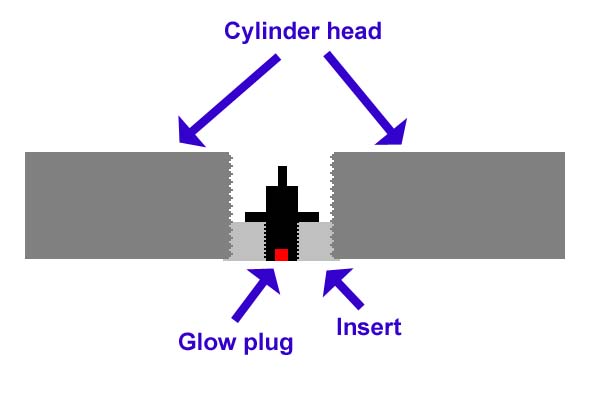

Old 07-26-2007 | 06:15 PM
  #1631
RysiuM's Avatar
Joined: Apr 2003
Posts: 1,490
From: Elk Grove, CA
Default RE: gas fuel with glo plug no ignition
ORIGINAL: Ralphbf
If you can make one like this I'd buy one......
I'm thinking about quite different approach. Instead of making a removable adapter it's better to make a permament insert. What I mean is an insert that will screw into the sparkplug hole from the inside and set there forever (not sure if loctite would work). The depth of the insert would be the length of the glow plug treaded part. This way the glow plug would go straight into the cylinder and there will be enough spaca between the glow plug and the old spark plug's thread for you igniter or wrench. Something like ere below.

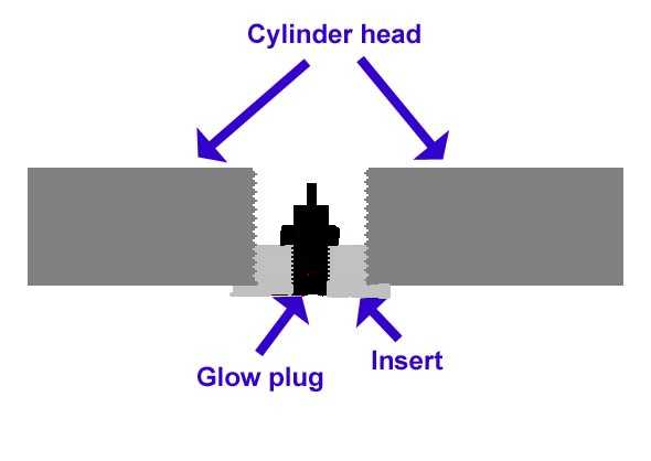

Old 07-26-2007 | 08:14 PM
  #1632
Ralphbf's Avatar
My Feedback: (27)
Joined: Mar 2004
Posts: 1,450
From: Woodland, CA
Something that would thread in from the bottom would work well.
There would be plenty of room to get the glow power adapter in.
The glow plug would be in a great place.
You could even raise the compression if done right.
But God help you if it came loose in flight.

Synthetic burns cleaner.
Old 07-26-2007 | 09:49 PM
  #1636
RysiuM's Avatar
Joined: Apr 2003
Posts: 1,490
From: Elk Grove, CA
ORIGINAL: Ralphbf
Just thinking, how many times the spark plug got loose during the flight If done right it shouldn't be an issue.
I'm going to make one to see it it's possible. I will cut the external thread (spark plug thread) on my lathe a little oversised. That should do it. Anone know what kind of "greese" would keep this thing forever?
Old 07-26-2007 | 10:12 PM
  #1637
Ralphbf's Avatar
My Feedback: (27)
Joined: Mar 2004
Posts: 1,450
From: Woodland, CA
When I was a pipe fitter we used a joint compound called "Expando"
You mixed it with water and as it dried it expanded.
It is some good stuff. I may still have some around.
Let me look and I'll PM you. We could meet, I'm over in your area often any way.
Or I could put some loose power in an envelope and send it in the mail, News at 6 o'clock.
P.S.
What do you think of my version of your drawing?
Old 07-27-2007 | 12:06 AM
  #1638
av8tor1977's Avatar
Joined: May 2003
Posts: 7,245
Received 6 Likes on 5 Posts
From: Tucson, AZ
I've heard of JB Weld being used to hold cylinder sleeves in diesel engines successfully....
If it was made with the flange as in the second drawing, it could be properly tightened as well.
AV8TOR

Old 07-27-2007 | 09:04 AM
  #1640
RysiuM's Avatar
Joined: Apr 2003
Posts: 1,490
From: Elk Grove, CA
ORIGINAL: Ralphbf
No need to hurry. We can meet some day anyway.
ORIGINAL: Ralphbf
That's exactly what I ment - in my drawing there was a flange - just hardly can see that, as jpg compression took it away This flange would be used to also to tighten the insert in the head. A little tool-wrench something like 1/4-28 screw driving the insert from the insideshould do the job.
I'm not affraid of insert falling of when engine is running, but I need to prevent it from unscrewing while you tighten the glow plug.
