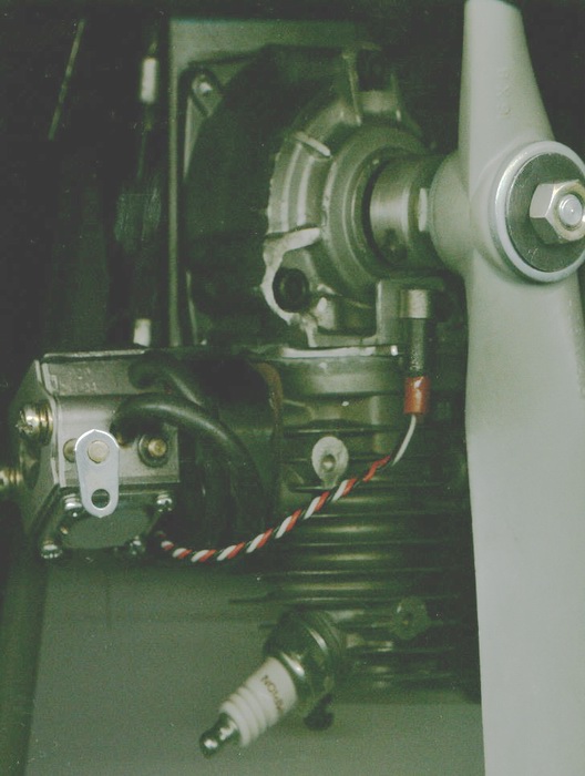

Here ya go Mike.
I had to make a spacer to "jack up" the cylinder to accomodate the increased stroke. It is made out of .085" aluminum. I made a tab to stick out front on the spacer, and mounted the sensor to a piece of angle bolted to the tab. The tab has a slot so I can move the sensor back and forth and fine tune the timing.
On an engine without the spacer I have, you could use some standoffs, (or a stack of washers), and some longer bolts on the top two crankcase bolt locations to bolt on an aluminum angle to mount the sensor.
What do you think of my engine?
AV8TOR
AV8TOR

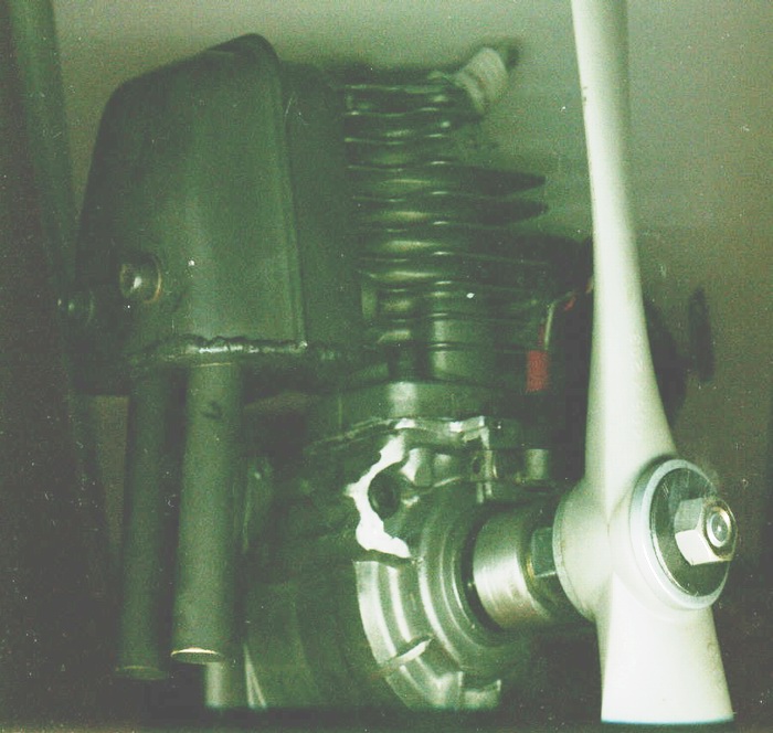

av8tor1977
decided on a front end mount for pickup. After using the CH prop hub on the Homie, figured that reversing the crankshaft and cutting off the long aft end would save some weight. Retapped the short end 5/16-24, (what is the actual thread on Echo? Do not have any metric pitch gauges and it sure looked SAE, surprize, but it will work)
The G-10 prop hub also saved some weight over an alum version.
The exhaust will be loud, just a 1" square alum tube totally open on one end.

Hi everyone,
Haven't had a lot of response to this thread, so I don't know if anyone is interested. I had to go to an engine class for a week for my work, and now I'm kind of tied up with the "holiday thing." However, when I get back to this after the holidays, I will post my results of further testing on my little 23.6cc stroker engine, if anyone is interested.
Happy Holidays,
AV8TOR
Happy Holidays,
AV8TOR
