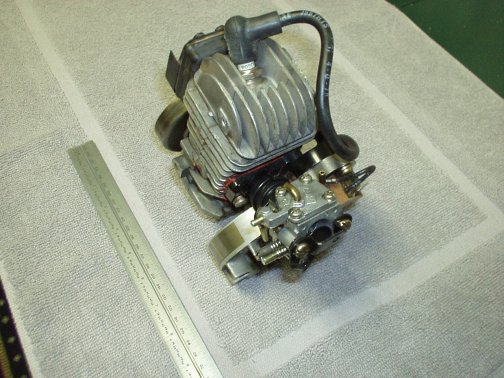

I disassembled the Power Mac 330, it's much easier the second time around. I forgot that this saw is "solid state ignition" equipped. The crank has no end-play and is actually tighter than my like new 33cc homelite. I wish the carb was located in a different location...
Hmmm... I wonder If I could modify this flywheel/ignition system to work on my ryobi or homelite 33cc conversions ?....
Heres a couple of pic's, tell me what you think!
Ron

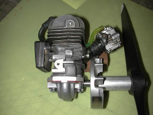

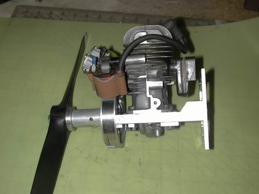

Here are the photos that I promised

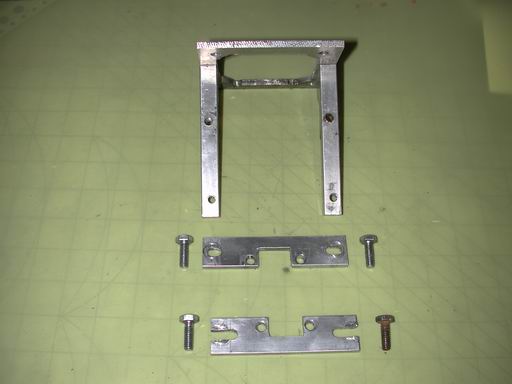

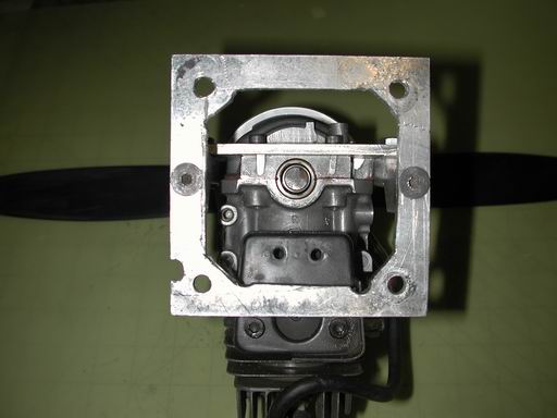

here are some more photos

Thanks for the pic's, aero nut.
That's a cool looking conversion, the motor mount is ingenious. With the carb mounted directly behind the prop I wonder if you get some sort of "Ram Air" effect?
That would be great if you could post some numbers on your Mac powered Ryans Rebel when you get her going.

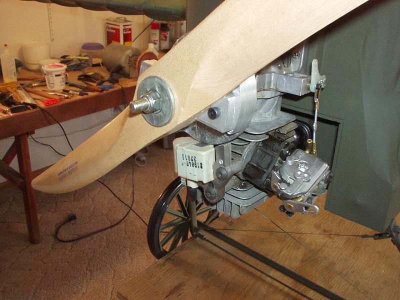

Old 07-14-2005 | 07:33 AM
Joined: Jun 2005
Posts: 73
From: gold coast, AUSTRALIA
Default RE: Mcculloch Power Mac
that engine is a 2.1 cu. in. (34.4 cc)
just looked it up
got one myself was going to use a homie 25cc but this thing looks like it will be better suited to my purpose than the homie
Old 07-15-2005 | 01:48 AM
Joined: Jun 2005
Posts: 73
I just picked up some of those mac motors
having a look in side its good to see proper tansfer ports
was worried about the lack of thrust support but figured it out and its easy
there is room on the crank to put a needle style thrust washer as well as shims.
they will only run on the bottom half of the case but this is fine
You will be able to shim the engine so its right
its a cheap and great solution and will last forever.
the good thing about this engine for is how thin it is
of course it gets wider with the exhaust on the back
but the front mounted carb looks great and with a velocity stack on it will look awesome
ok am trying to load some pics to explain what i mean but i cant
