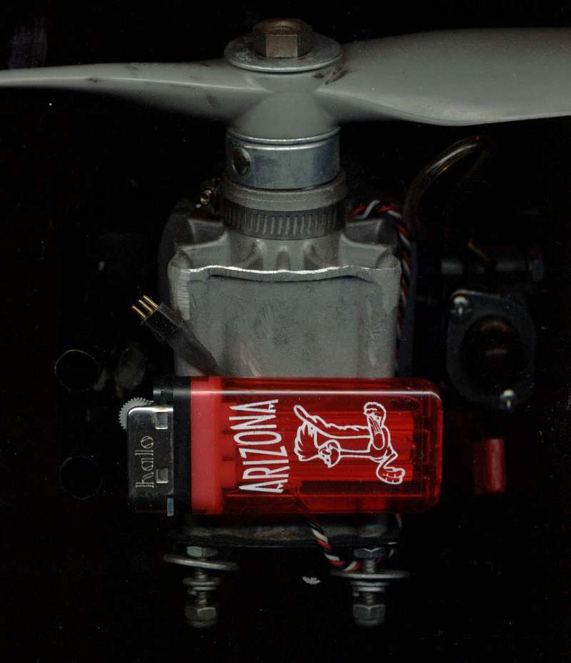

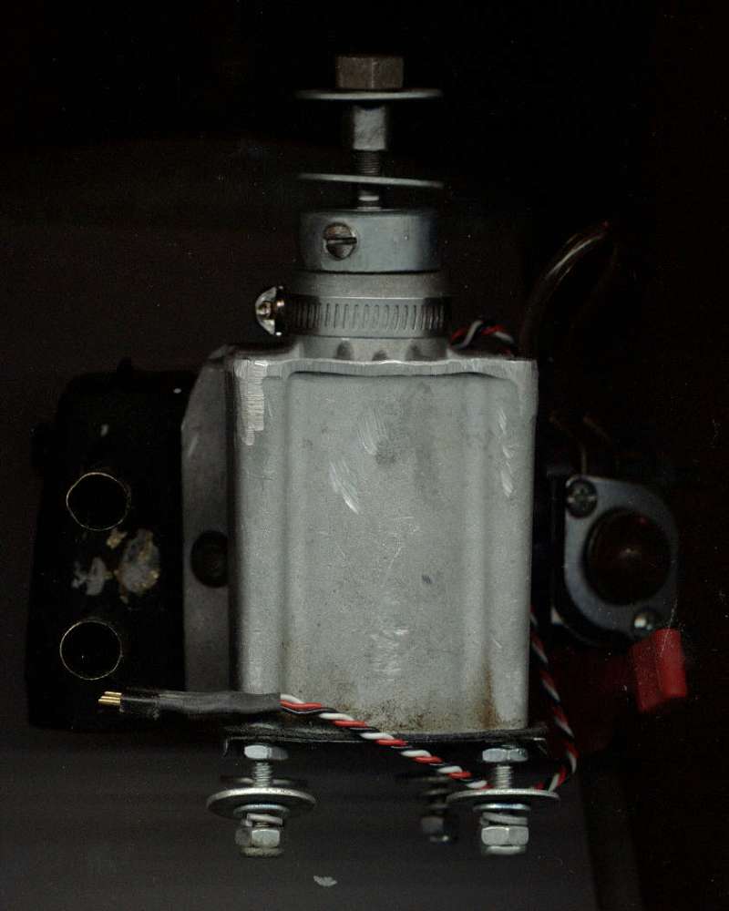

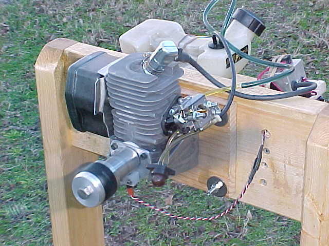

Hi,
Here's those pics finally. The one pic is of one of those long necked nuts that originally went to the weedeater cable. I cut it down slightly, and drilled/threaded it all the way through. Then I drilled the prop out slightly larger to accomodate the shoulder of the nut, and put the nut on "backwards", so that the neck, or shoulder, of the nut went through the prop. The other two pics show the rest.
The sleeve with set screw that you see, is something that I picked up at the hardware store. After I cut the center out of that particular flywheel to use to mount the magnet, it turned out to be slightly small in diameter. So I found that sleeve with set screw at the hardware store, and used it over the top of my custom hub, and mounted the magnet to it.
Hope it all makes sense,
Take care,
AV8TOR

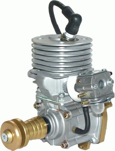

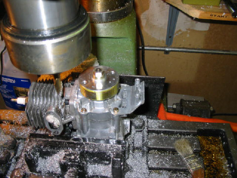

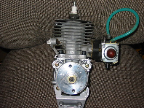

HI AV8tor: Looks like a good idea. I thinking maybe all of us could turn this series of posts into a picture collection of all good ideas RCer,s could get too all in one place. The engine in the mill has Zenoa 1490 on the cyl base. (red max?) The engine on stand is a Poulan 46cc. The other photo is a close up of how to make a carb vent tube. Thanks Capt,n

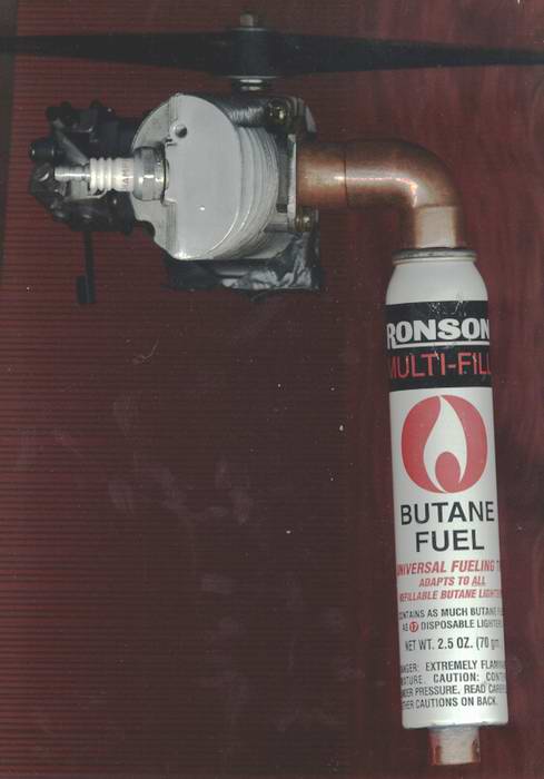

More engine photos The top photo is a 46cc Poulan with RCIGN ignition system. The third photo is a Ryobi running on glow.

Old 08-10-2004 | 07:53 PM
Posts: 424
From: Naples, TX
Default RE: ENGINE & HARDWARE PICTURE POST
The engine on the stand is the 42cc Poulan. With a different muffler it turns a MA 20x10 at 7360rpm or a Pro Zinger 20x8 at 7560rpm.
