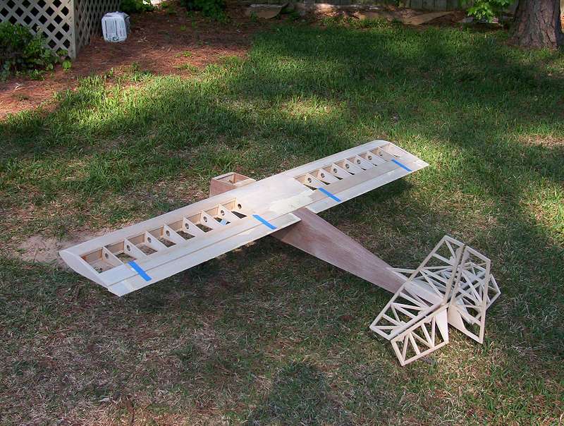

I did the modification that RCIGN! described. The Garolite I bought was Garolite CE. It was a little less expensive. I have a 12" X 12"
sheet, minus a 1.75" square. The mod went as RCIGN1 instructed. I'm waiting for the JB Weld to cure, so I can clean up the inside of the carb inlet throat. It sure seems solid. I made the mod to the Carb as well. The local saw shops didn't have a fuel fitting, so I got a 10-32 Brass pressure tap, and mounted it on the boss I drilled out. The inside dimension is the same as the 8-32 I put on the bypass port, so it should work fine. I'll let ya'll know how it ends up. If anybody wants to buy some Garolite, send me an email and we'll come up with something. I can't imagine ever using all this.

I finally got to run the engine with the new Garolite carb manifold. I'd have to say that it seemed to start easier than before, although it is getting warmer here, and I am getting used to the starting characteristics of the engine. Maybe having the carb closer to the factory distance from the intake helps starting? The pulse coming from the back transfer port to the carb works well, and I can't imagine that the Garolite manifold could ever come loose the way I have it mounted. It is rock solid.
I have the tail group of a Ryan's Rebel framed up, and the fuselage parts are ready to start assembly tomorrow. The wing ribs are cut. I'm using 1/8" luan veneer for the fuselage exterior. I plan to stain it mahogany and give it a few coats of clear Poly, then cover it with clear Oz cover. The wings and tail group will be yellow. I'm going to put POULAN POWERED across the top of the wing. With the wood finish on the fuselage, I think it will look pretty good for a stick type design. Kind of cool to highlight the origins of the engine.

I got a digital camera so I'm posting some pictures. Some are my Poulan 46, and a Ryan's kinda Rebel I'm building from the magazine article.
