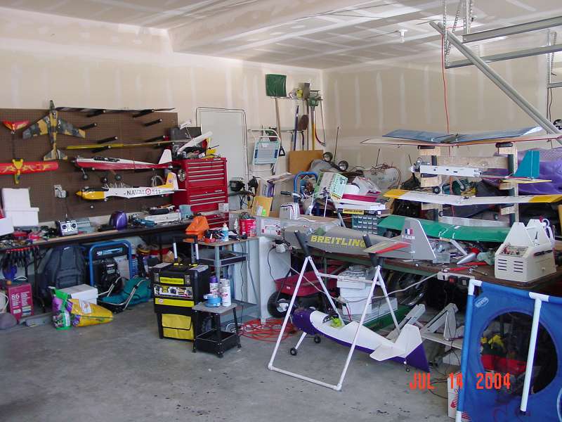

OK, here are the pics I promised (at least a couple before my camera pissed me off [:@]). The pics of the engine are of the 38cc Echo. The rest of them are of my nonexistent workspace [:'(]. rcpilet, I sent you an email.
Dave
