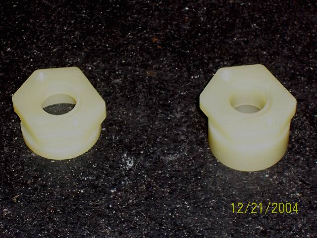

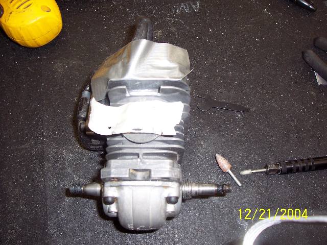

If i put the carb mount on with epoxy can i take it off later and put mount on another motor. I've got carb mount made. I made it out of G10 epoxy board that i got from our supplier. I have two made one that is 9/16 thick and one that is .900 thou thick. I'm going to use the short one so i can get a motor in the cowl of a plane. I'm going to have to cut one of the cooling fins on the motor to get mount on. Then i'm going to put two 6-32 screws in from the sides. I will not have to pull brass pressure tube out of motor because i milled it out of my mount so that it will line up with the pressure hole on my carb. I will try to put pics on here when i'm done.

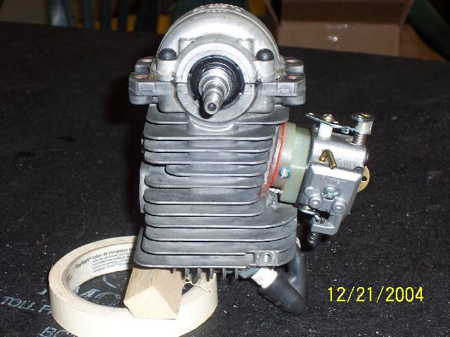

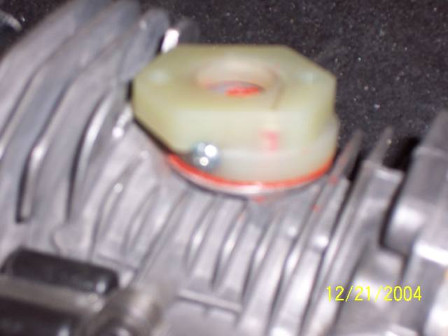

Here is the carb mount i made for my poulan 46cc motor. I made them out of G10 epoxy board. I notched one fin out for carb to set then i put red high temp silicone around mount pushed it on an drill and tapped the set screw holes in motor and mount. I made my mount to where i could still use the brass tube stiking out of motor for carb pressure. I milled a 1/16 slot in mount to intersect with hole in carb. After making this mount it instailled very easy. Here are a few pics.
