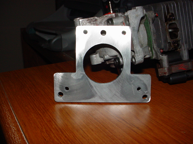

Old 02-02-2005 | 09:22 PM
KenLambert's Avatar
My Feedback: (107)
Posts: 886
From: Augusta i i IL
Default RE: converting a stihl
here is a pic of the mount I have done so far if it will work for you .
Old 02-03-2005 | 03:05 PM
Joined: Dec 2004
Posts: 253
From: Memphis, TN
Awesome Ken, You're the man

Old 02-10-2005 | 03:58 PM
Joined: Dec 2004
Posts: 253
From: Memphis, TN
Ken, you are definately a master machinist. The parts look great and I love the pitts style muffler you designed! The only problem I am having is I think the hub was tapped to fit the stub shaft on the back rather than crank threads on the flywheel side which are slightly larger. I am still very very impressed with the quality of your work. Could not look any better!!! THANK YOU!
Old 02-10-2005 | 07:13 PM
KenLambert's Avatar
My Feedback: (107)
Posts: 886
it is taped 8mmx 1.00 I used the engine you sent me and it fits this one if yours has a different thread I will have to make another one but it is for the flywheel side . Are the engines the same or could one have a different crank ? you can call me at 903-628-9837 if you want
