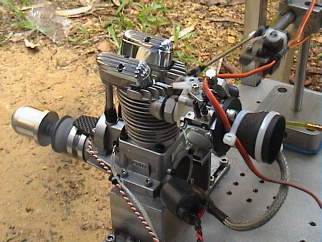

Hi
We're trying out the Saito 150 Prospark conversion.
Prior to conversion, I've used this engine and ran-in very nicely.
We're 16x8 prop, running 92 octane fuel, with 1:8 Textron 2 stroke synthetic oil.
We've incorporated the Walbro carb WT-9-1 and installed a velocity stack at the air.
The ignition is installed according to the recommendation (the spark occurs just after top dead centre)
So far, I've fired up the engine, running only at part throttle.
But I'm having problems.
Symptoms
1) The engine runs rough and uneven at part throttle
2) The engine runs, but stalls after 3-4mins, showing signs of lean mixture (engine spinning up before stalling).
=> increasing 'L' fuel mixture didn't help.
Has anyone else done the same conversion or experiencing problems?

How do you have the impulse signal from your engine to the pump side of the carb hooked up?

How are you making the Walbro carb pump work??

Hi
Attached pls find my setup.

BTW, we installed a Perry Gas Regulatory Pump.
Also, we lean out the Low mixture.
Engine is running fine now. Will put the muffler back later.

ORIGINAL: tkg
Hi
Are there many steps to make the walbro carb work?
The carb I've seems very simple. Fuel line in, L and H needle .........
Also, I installed a big 3W stack ... just in case.
Very keen to run the engine in pusher form .... with the air ramming into the velocity stack.
Wonder how much more power can I liberate from the ram air charging?
Or would the ram air cause problems?

The Walbro you are using is desiigned to work on a 2 cycle engine. They use the +- pulses from the crankcase to make a very small diaphram pump work The pump is built in to the carb. If you look at the manifold side of the carb you will see there is a small hole, this is the pump port.
There is a 4c Walbro carb WT456 it is used on a 26cc Ryobi 4c weed trimer. Thes carb is designed to get the pump pulse from the intake port.

Ok, I see where you are coming from.
BTW where can I read more about Walbro carb?
I am not sure if my Walbro is installed properly.
I could not fire properly without the additional regulatory pumps.

That's what we've been worried about. Your carb has it's own pump. If it's hooked up correctly, it doesn't need a Perry pump to run it. However the pump in the usual Walbro is run from the changes in the crankcase pressure on a 2 cycle engine. There is a place on the Walbro pump where you can tap into to supply it with this pressure signal.
On your four stroke engine the crankcase needs to be vented to the atmosphere. It might possible work to have a TEE in the crankcase vent line but the best bet would be to get the carb that "TKG" suggests.

The correct numer of the Walbro carb is WT456 as told by TKG above. Walbro carbs are sold the all over the world. You should be able to get one at a lawn mower/ weed whacker/ or chain saw repair shop. They come on the four cycle weed whackers. The US street price is in the $40 USD range for a new one.
