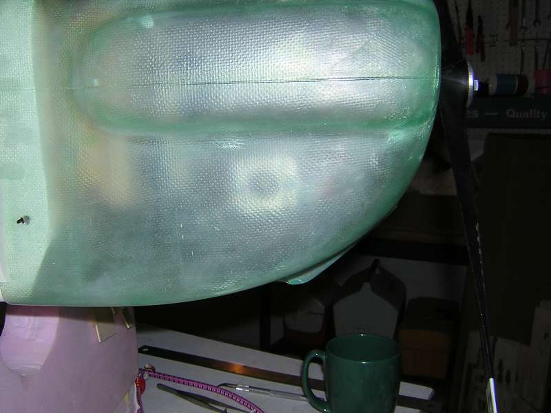

I'm on the final stages of my Byron CAP 21 with a converted 45cc Homelite. My carb is about 3/4 inch from the side of the cowl. My velocity stack is twice that length. Instead of cutting a big ugly hole in the cowl, can I just leave the stack off? If I have to put it on, would it hurt to cut it down so it fits inside? Which direction should it face? Angled part forward or backward? Thanks guys.

Randy, you've opened up a gray area. You may just try it like you want to and see what happens?
The velocity stack's one function is to keep the pressure wave of fuel that stands just outside the carb entrance from blowing down the side of the plane and have it go through the engine.
The other function -- often, the air blowing by the carb entrance creates a vacuum at the entrance of the carb. This messes up your mixture sometimes and will cause the engine to surge.
The venturi is sometimes cut at a angle. This angle is turned toward the front, but sometimes, you may find the engine may run best with the venturi in most any other angle?
There is a lot of air swirling around the area and it just depends.
Some venturi are not cut off towards the front.
There will be some different opinions here.
The bottom line is that there are a lot of variables and you may need to try several different methods before your engine runs the way you want?
You are the one that needs to be pleased?

Thanks for the reply. This would explain why I couldn't find a definitive answer with my searches. Bad thing, is it is on a Byron's CAP 21, and I really would rather not have a deadstick on this snap-happy plane. I guess I will be doing some major ground testing.

The main problem is that the air flow will be much different in the air than on the ground. Get the engine to run as well as possible on the ground and try flying after. Plan your testflight well, think of each eventuality and what you will do. If needed, get an experienced pilot to either call for you or to do the testflight for you.

I have a 29% edge 540 with a FPE 3.2 (52cc) on it and i did not put the stack on it for the same reason you don't want to put it on. I have been flying it for a while now with out the stack and it works perfect. I have never had a dead stick or anything bad happen form not running the stack. You will have a cowl on the plane and that will help the carb. I think you will be fine to fly the plane with out the stack, you just need to get the motor running a little rich the first flight or two then lean it down a little at a time.

Agree that the best path is try it as is, get the engine running well statically then start a test sequence with slowly increasing aerobatic maneuver intensity to see if the flow through the cowl is adversely affected... (with deadstick altitude always available )
With any luck, the cowl will act as a plenum, providing positive pressure to the carb inlet with most maneuvers .. with bad luck, the flow will be so fouled up that the carb will see negative pressure, and the engine will respond accordingly...

If you are concerned that the cowl might not act as an air box then a small air box or plenum chamber could be fabricated. All you would be doing is preventing air from rushing across the face of the carburetor and raising or lowering the pressure seen by the carb. Many get by without a cowl and without a velocity stack.
