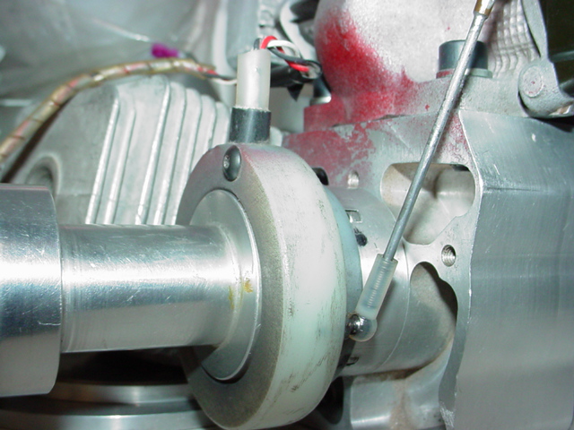

I don't have any photos, but what I do is machine the prop hub. Then machine a collar that is a nice slip fit over the outside of the rear portion of the prop hub. I mount the magnet in the ring then hold the ring to the hub with a set screw. I adjust the timing by loosening the set screw and rotating the collar.

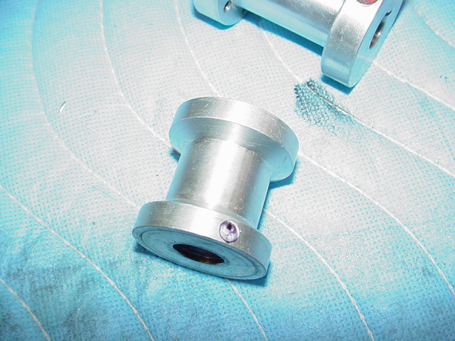

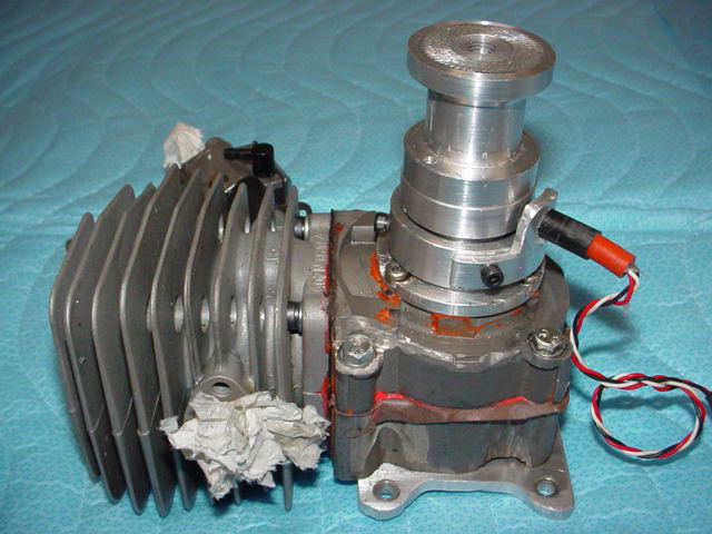

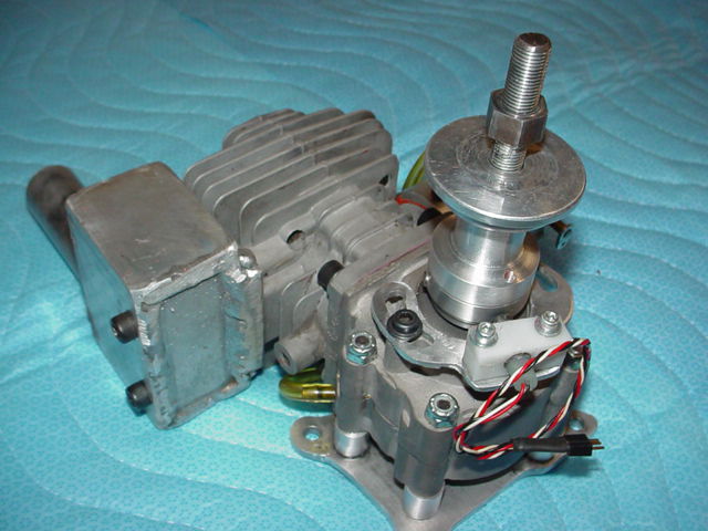

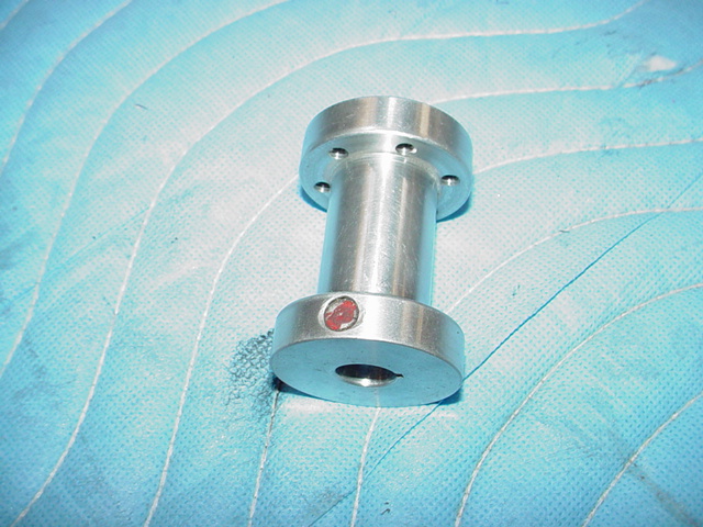

KenLambert's Avatar
My Feedback: (107)
Posts: 886
From: Augusta i i IL
Default RE: How to make a prop hub with magnet
Ok Zafer these are just for you

Old 03-03-2005 | 10:32 PM
Joined: Feb 2004
Posts: 293
From: Timmonsville, SC

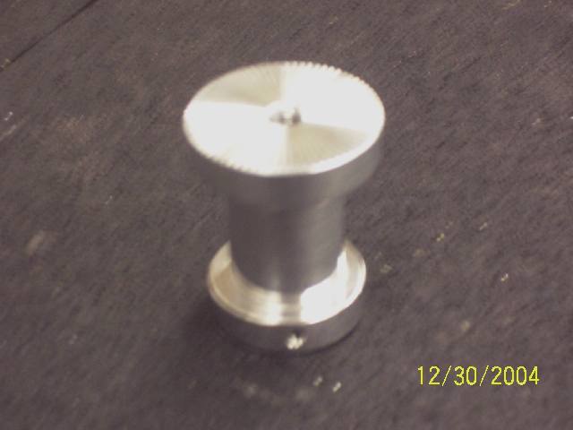

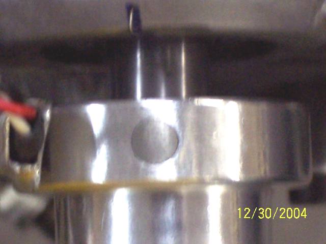

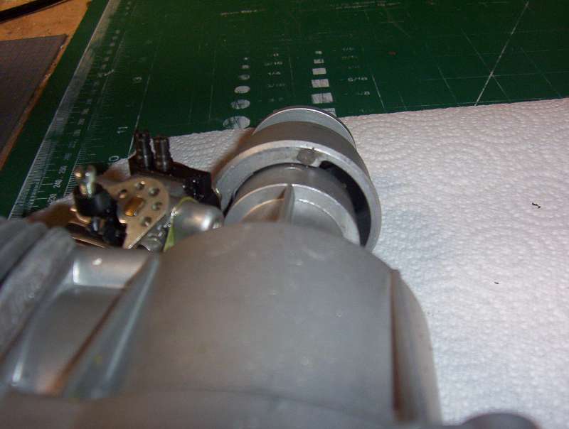

Hear is a few pic's i might need to take another for you. I made the prop hub in the pic its on a 46cc poulan chainsaw. Time it at 28 degs.
smallplanes
KenLambert's Avatar
My Feedback: (107)
Posts: 886
here is a couple more just incase=

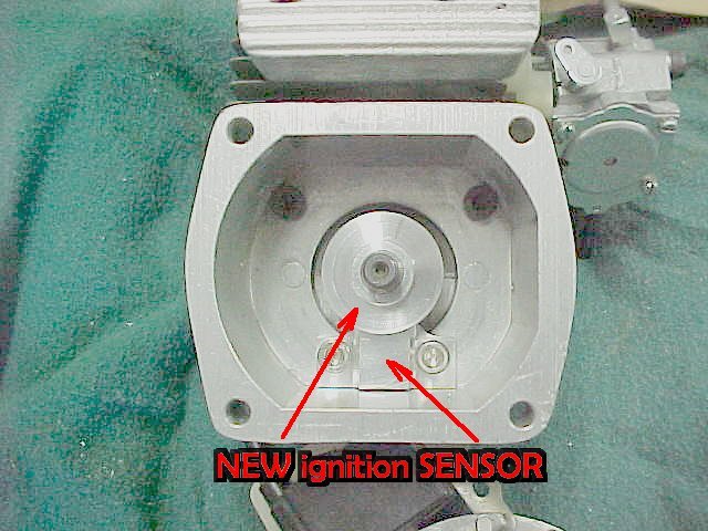

Hi guys,
Thank you very much for the photos, So I know how the magnet is positioned generally.

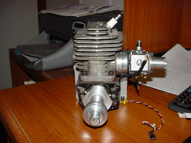

I have a JWE ignition which I bought on EBAY. I have also some kind of ignition for 2 cyl. 3W engines. Here is the photo of the ignition. I think it is new. I plan to use this with a 21 cc Robin Weedeater engine ( must be a kind of Fugi - but it is nice, light and with 2 rings) which has a place in side the mounting plate. It has Walbro WY 25 carburator with 10,54 venturi . Maybe I change it since it lacks high end needle. ( I have also WT 20 and WA 46) I also saw a photo of a round magnet put on the shaft(back side) directly. But in that case I dont see how to adjust the timing....
Anyway, the only thing I need now is a hub with magnet.
Thanks and Regards.
Zafer

you do not have to adjust the magnet if it is put in the correct place for timeing to start with
The ignition in your photo looks like one of the older 3w jmo .

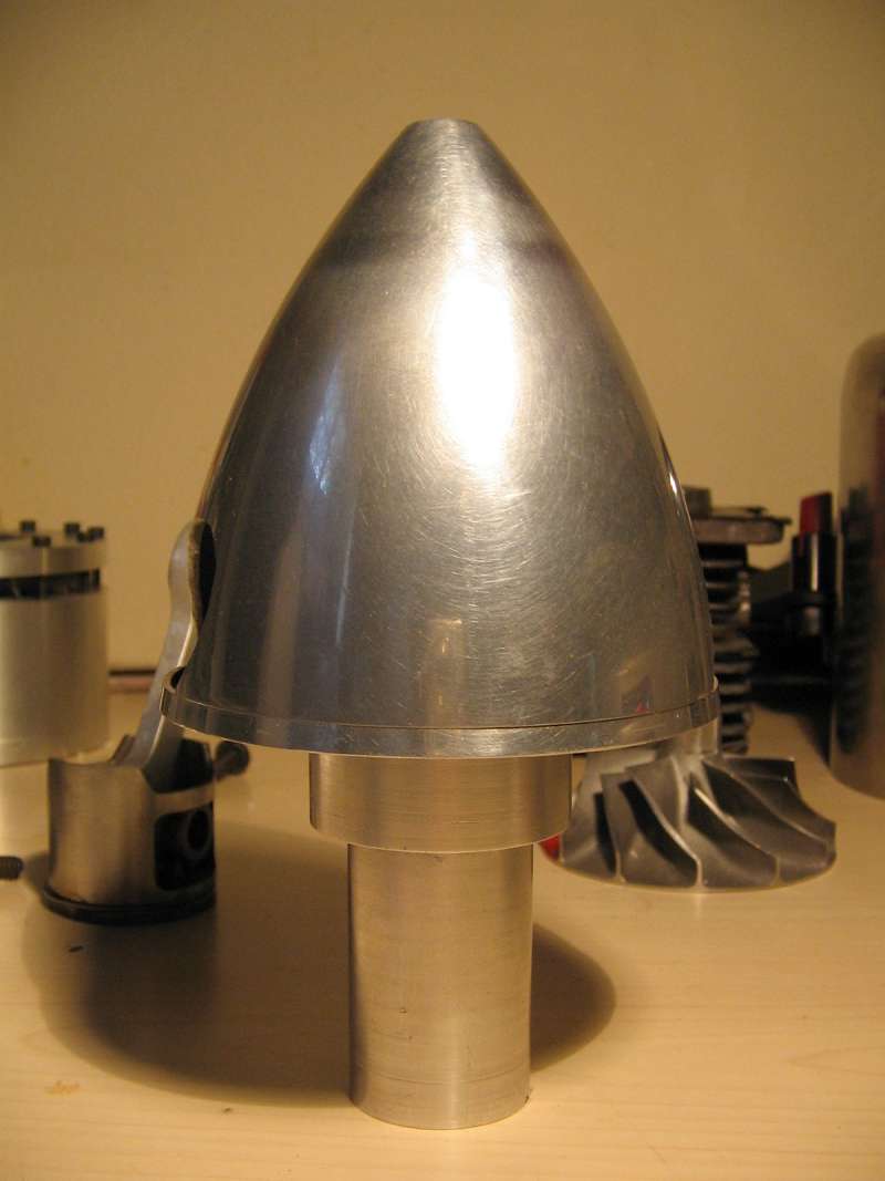

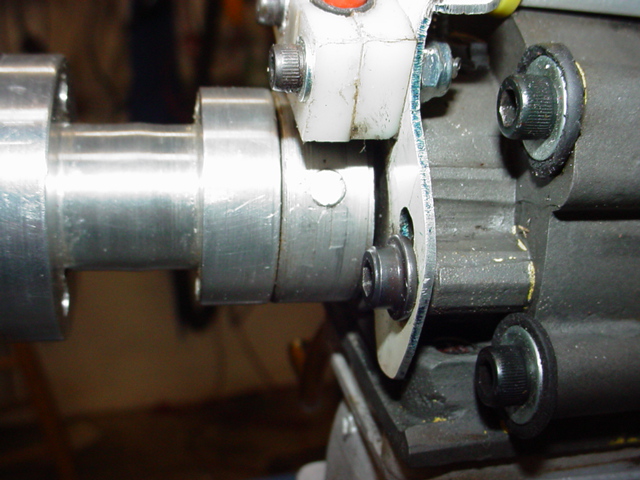

Old 03-04-2005 | 12:06 PM
Rupurt's Avatar
Joined: Apr 2004
Posts: 694
From: Cape TownN/A, SOUTH AFRICA

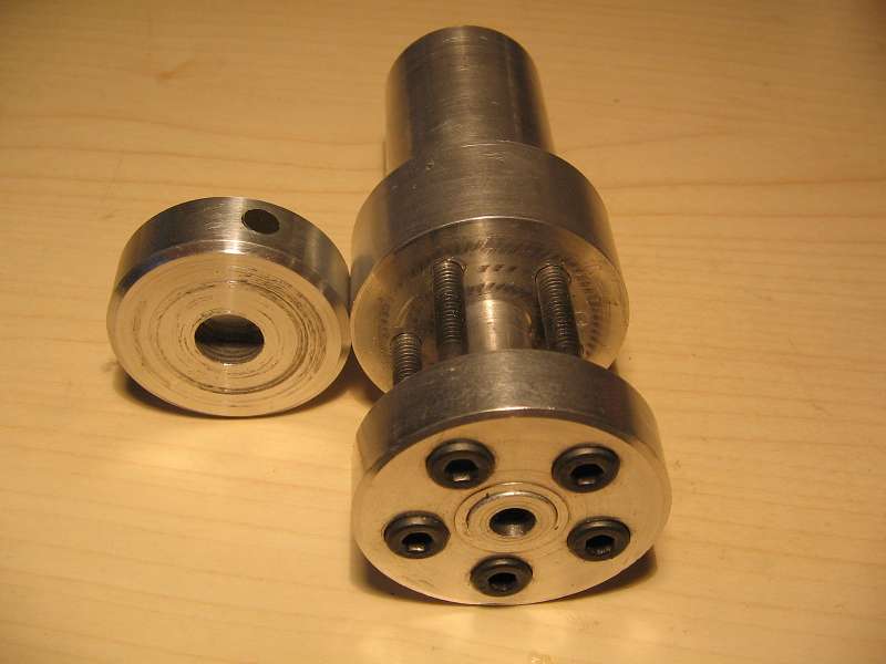

I made this hub so I could use tru-turn type spinners, it's in two parts because it was supposed to go on with the orginal ignition but when I broke the coil mount off I decided to go with a cd ignition.

Old 03-04-2005 | 12:16 PM
Rupurt's Avatar
Joined: Apr 2004
Posts: 694

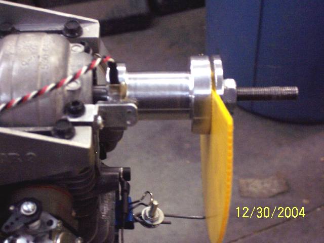

Here's a shot with the spinner.
