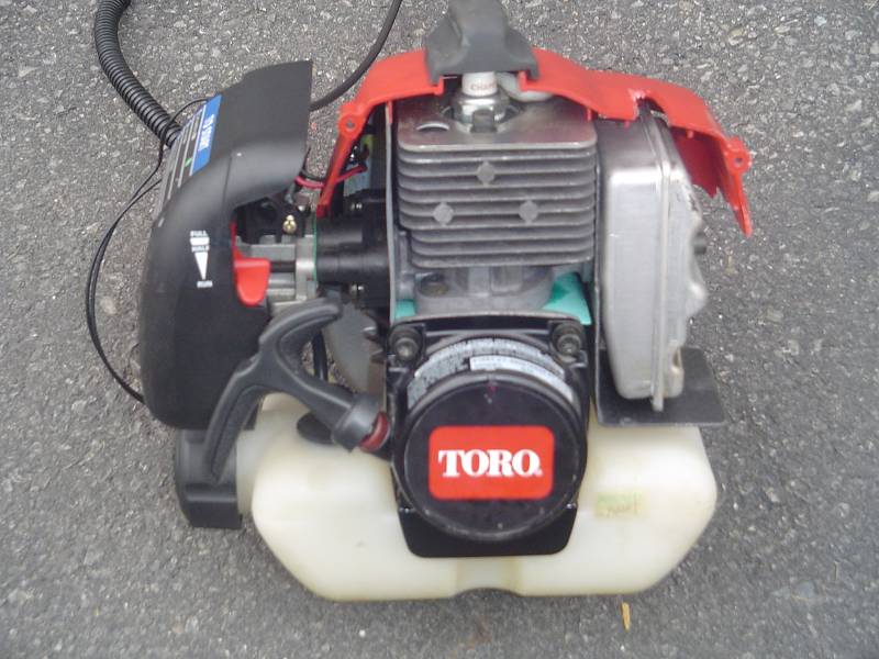

Hello all of you Toro fans,
Here are some pictures of how I did my 2 bbl Toro. The first group will be stock before photos, and then after mod group. Some before photos are from the forum.
Dave

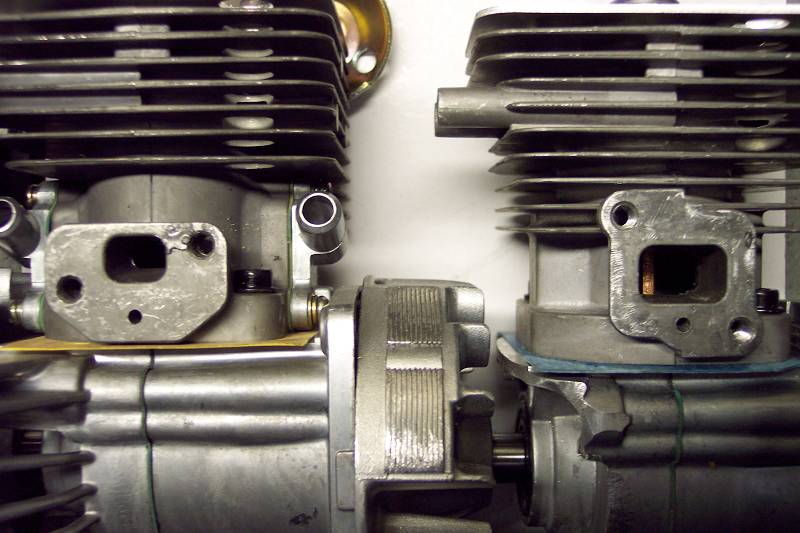

The exhaust bolt to bolt dimension is 32mm or 1 1/4"'
Ryan

Ryan,
A Zenoah G23 compatiable header should work fine. At the most you wil have to make a minor adjustment with a small rattail file. I put a Toro muffler on a G23 with only minor filing.
Dave

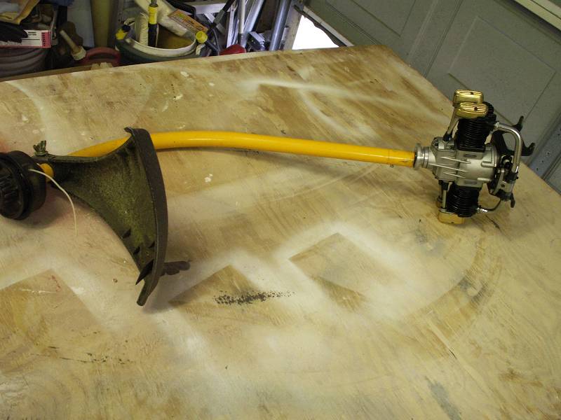

well here is what my toro is going in! well, I did actually use a pic of my mac 25 instead of the toro,
and ACTUALLY I am using a LESS scale plane..one of the cheap cmp clones ...when I get it done who knows, I have WAY too many projects going.
