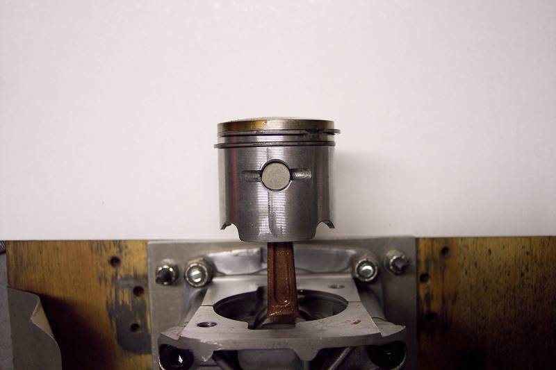

One of the things that I noticed about the Toro is the extended piston skirt blocking the transfer pots to the case. This is done I beleive to assist the reed valve function in the two barrel configuration. Since all of my engines have the normal single barrel setup this hurts performance. Have you modified the pistons as seen in my photos? I ordered two two barrel versions from Doug. I hope that I get at least one two barrel. The engine has much potential. I thought I would pass along some info on port timing. You may already have this, but here it is anyway. Single bbl: Intake opens 60 degrees before top dead center. Exhust opens 65 degrees before bottom dead center. Transfers open 51 degrees before bottom dead center. These are fairly conservative timings. Most chain saws exhust open at 75 degrees BBDC and trans fers open at 55-58 degrees BBDC. Saw intake is about 70 degrees BTDC. Thanks for all of your input to the thread. It is much better then I thought It would become.

Thanks for the Info Dave. I think you are correct. These engines have way more potential than we even know. I was going to check all of the port timing but have not done it yet. Your info helps alot. I will have to try the piston trimming you showed. The only thing that worries me about it is engine ballance. These engines are very smooth running. I machine and ballance the flywheels. I do that on all engines. The Toro once on a plane, even mounted solid, does not have much for vibration. I wonder how much cutting down the piston will effect that. I suppose a person could gring a little on the counter weights to even it out. It would only take a small ammount.

Hi dave, Soon as I looked at your photos, I wondered about balance like Scott is thinking. What your doing is interesting. Any chance to run it yet. Everyone mentions how smooth these engines run, and they do, but I have noticed a resonant vibration as the engine is accelerated. This is common with all single cylinder engines as you must already know. The connecting rod looks like it is light enough and who knows you could have very well come up with something. It is possible than it could run even smoother. Have you run your Weedeater yet. My Weedeaters run smoother, even more so, than the Toros and I love that about them. Any way to weigh what you removed for future reference?, It would require a powder scale or equivalent scale. I am going to look at my engine, I have the jug off and am getting ready to take about .020" from the bottom because I got a bit aggressive with raising the intake ports. I also need to write down your port timing measuements, I just can't keep that kind of stuff in my head anymore, thanks for giving them. I printed your photos and they came out great. I just noticed that your piston now resembles some automobile pistons. This is for a single barrel engine, correct? I can't wait to hear a running report. Good job so far.

If you think about it, The percentage of weight that the material removed represents is very small. When balancing a single cylinder engine, the lighter you can make the piston assembly the better. The wrist pin is a solid bar and the top half of the rod is steel also. These to items alone equal way over half of the recipitating weight. If the piston losses 15% of its weight, that is probally less than 5% of the total recipitating weight. Over the years manufactures have produced glow engines in ringed and lapped versions using the same counter weight and shaft. The ringed engines have aluminum pistons and the lapped have heavy steel pistons. Both run fine. I havn't run it , because I don't have a prop hub yet. I'll let you know when I do.

We use to cut pistons like this when we ran a pumper carb on a raceing Hodaka Ace 90.
It didn't seem to make any difference in the balance at all, and they turned around 12,000rpm.
For a time we cut windows in the in the piston, where the intake manafold aligned with the piston.
This only worked with reed valve motors. This weakened the piston quite a bit but made good power.
