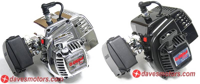

Hi RCIGN1!!! I was looking into DavesMotors page and saw that hey are selling a long block for a CY27 engine that's suppose to be if not identical similar to the Zenoha g26; my question is: Have you heard or know anything about those engines?? because for $99.00 for a long block is not bad at all!!!!, they also sell same engines with a spirall billet head shell that increases compresion ratio to about 14:1,. Their web page is the following: www.davesmotors.com/store/engineparts.htlm

Aero nut: thanks for the web-site. Lots of neat goodies there. I like the prices on cyl and pistons ...ect. Nice looking engines too!!!

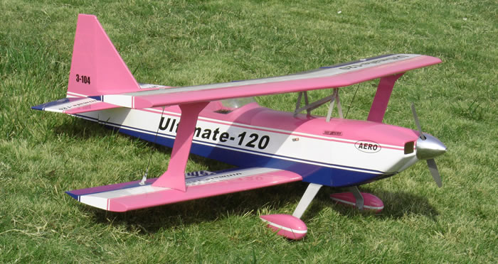

Aero nut. That sure is a nice looking plane in the photo. Is the Arf a solid built plane? Thanks Capt,n From up north way....freezing to death...wll it seems like it anywy!!!!

The airplane is built like most ARF's it's very light (about 5Lbs) my 25 weadeater plus weights 2lbs 3oz including engine mount and vibration isolators, so that puts the the flying weight at about 8 lbs including radio, the planre comes complete, the only thing I hasd to fix was the stab slot opening because the stab was dropping to one side so I had to level it other than that the plane builds very fast and should be a great flyer, I'll keep you posted when it gets it's maiden flight just waiting to buy a new radio for it (tax returns)

aeronut, yes very nice plane, but I think you are off a little on the weight according to the website 10#
is the weight of the 120 Ultimate, plus the engine 2+ lbs. servos battery etc. looking at 14lbs. on the runway.
Sweet plane though. How about a Homelite 45 for power? How big is the engine compartment?......Craig

The 10 Lb weight is final flying weight that's including engine and radio: I weigh the assembled plane 5 lbs then I weigh my engine with muffler engine mount and vibration isolators 2lbs 2 oz, my radio system weighs 1.0 lb so thats 8lbs 2 oz, unless my weighing scale is off then!!!!. Definitely the 45 Homy is to big of an engine, the most that I would go with it would be a Ryobi 31CC or similar displacement and that's putting a lot of an engine, this plane is similar in size to the Carl Goldberg ultimate
