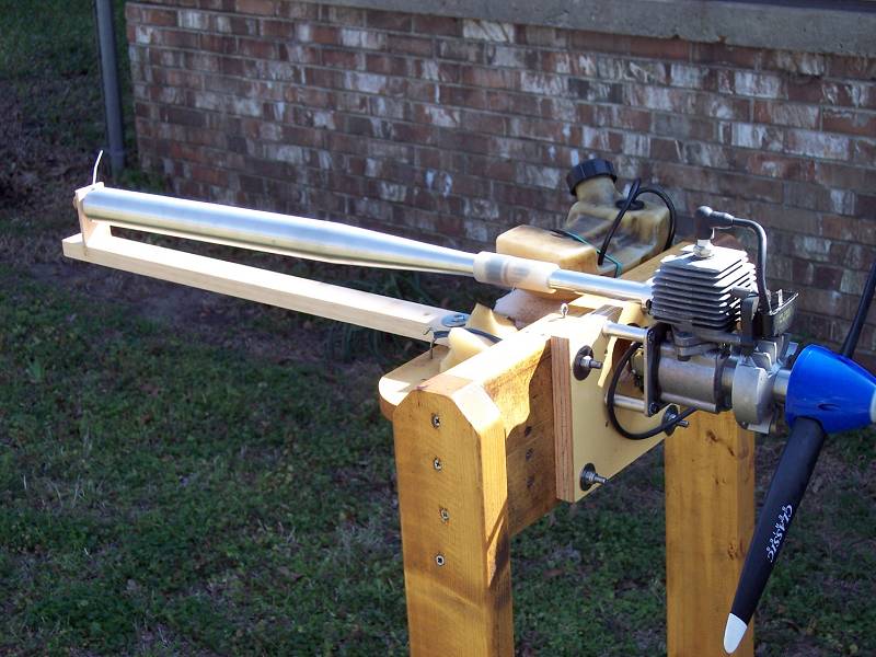

This is the easiest way to get a big boost in horsepower. The $62 tuned pipe for the Evolution 26 from Horizon. Homemade header, ran it for the first time this afternoon. Didn't get any tach readings, the setscrews that hold my header together kept coming loose (I'll have to get the header welded) I did get the carb adjusted well enough to see that this is a combo worth pursuing. Run it about a minute, adjust carb, then I'd have to tighten the setscrews in the header. MACS used to make headers for the Ryobi, but I haven't seen them listed recently. This thing was turning the MA 18x8 WAY faster than it's ever ran before.

flip flop let me know the numbers after you tach it .how much was it? looks cool

I would also be interested in the prop numbers. Incidentally my calculations indicate that a 16-8 prop represents about 5% greater load than an 18-6 prop.
A ST 90 muffler to engine piece will almost fit. People throw those away.
