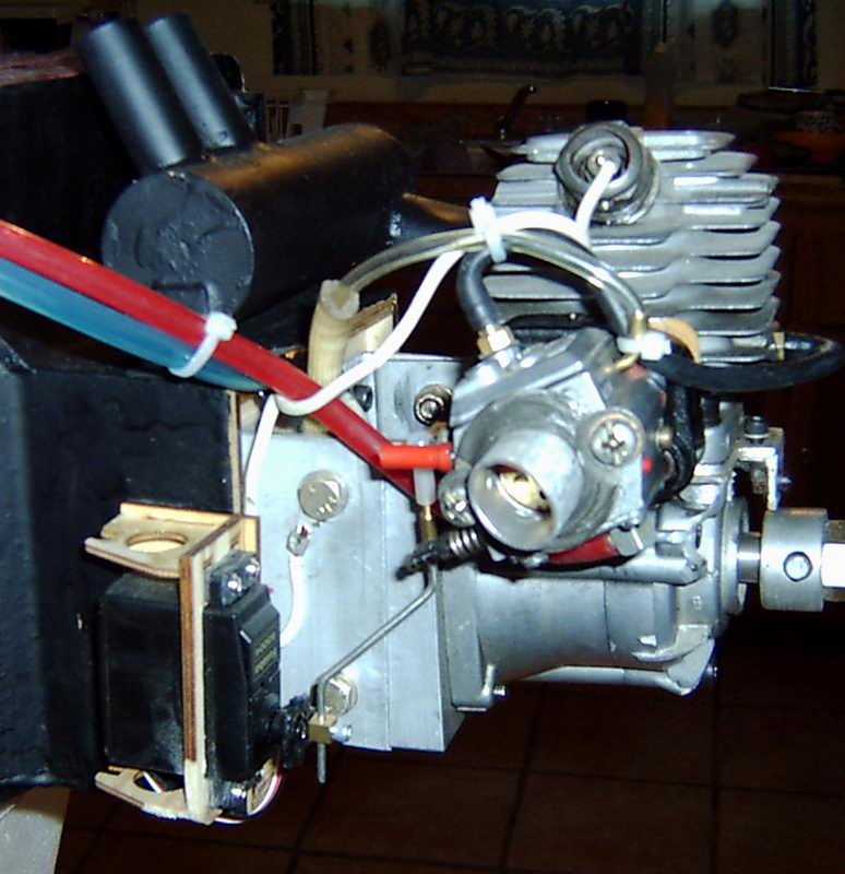

I use the bell crank and golden rod to absorb the vibration.
The reference potentiometer will go first in the servo causing it to hunt and stick close to the intended set point. So most of the time You get a little warning.

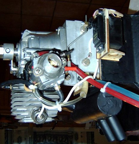

I've seen your setup before and considered it carefully because the layout is near identical to what I will have. The biggest difference is that my carb is mounted the other way around so the needles are accessible for tuning, this means the linkage has to go the other side and I am hesitant to drill holes in the crankcase to suit the bellcrank pivot.
Hmmm, just been carefully looking at my engine and yours. Perhaps there is a way to bellcrank it using a spacer off the lower engine/firewall bolt. I could make a sleeve to sit over that lower bolt, with the sleeve having the pivot point threaded into it. I'll let you know how I go.

the homelite has a lip where the cylinder bolts on, you can drill and tap in this lip and install a bell crank and not drill in the crankcase

Thanks Ken, that's another good idea. What intake manifold are you using there, it has the carb in a totally different orientation than I've seen before (I have a 25cc Homelite with a WA-167)?

Two setups for your review...
Whatever setup you use, try to keep the linkage as tight and slop free as possible. Otherwise you will have problems getting a reliable idle, and also if you set it for full throttle and there is slop in the linkage, engine vacuum can pull the butterfly past full open, closing the throttle partly and losing power. (Don't ask me how I know this...)
Some carb/manifold combos can be "turned over" as you mentioned to put the needles to the rear for easy adjusting, and some can't because the carb pulse hole is then blocked. Check yours because if the pulse hole is blocked, the pump in the carb can't pump fuel. If this is the case, you can drill and tap the pump cover on the carb, and route a hose to a fitting drilled and tapped into the crankcase to make the pump work.
It looks like Ken's setup in the picture above has a "twister" manifold. They cost around $15.00 bucks.

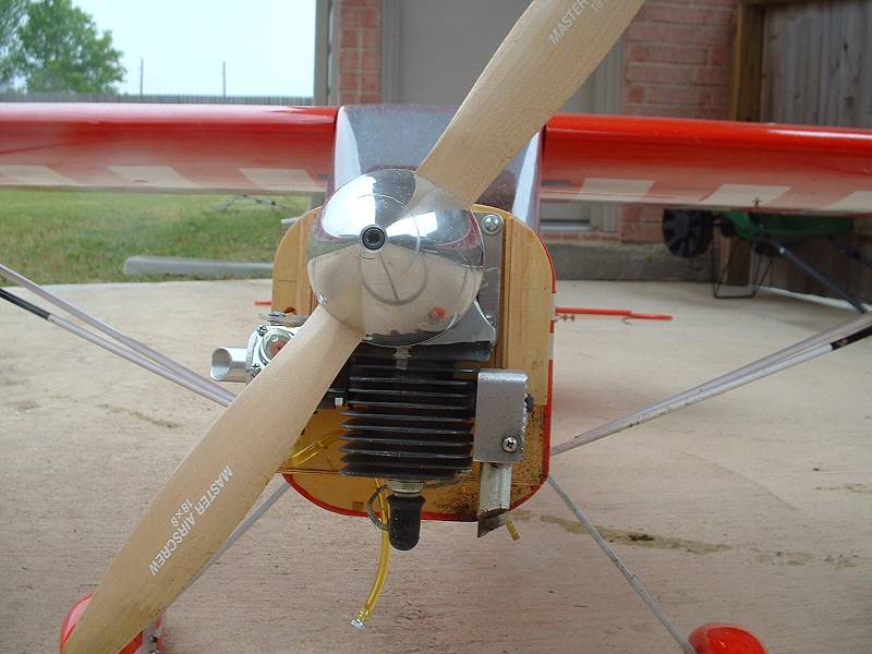

Av8tor: In you 2 photos, it looks like both engines are mounted with the piston up. Is it just a preference or would the engines run just as good inverted? The engine with the pitts looks like the exhaust must flow over the top of the airplane or is that just a illusion? I inverted it with a couple of clicks to see how it would look inverted!!! Capt,n

I'm attempting to add pics of my engine so you can see my setup. Hopefully you can see them here and they aren't too big.
What I intend to do is extend the lower standoff by adding a metal sleeve. The sleeve will become the mount/pivot for the bellcrank. Then a conventional setup back into the fuselage.

Thanks Ken, will look for the adapter but I'm starting to think I can get away with a traditional bell crank (see my post with pics - they worked!).

Usually if the engine is uncowled, I mount the engine upright as in the picture of the Homelite 30cc on my Ultra Lite Stik 120. If the engine is cowled, like the picture of my GSP Katana with the Kioritz 23.6cc, I mount it inverted. The plane was inverted on a work stand when I took that picture, hence the confusion. I've never noticed any operational difference whether they are mounted upright or inverted.
Actually, it also makes me a bit nervous also to mount the servo next to an ignition engine. The ones I'm running with the servo next to the engine are running on "Gas/Glow", and don't have an ignition system. A lot of people do mount the servos next an engine with an ignition system with no problems however...
