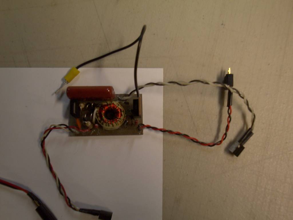

I now have 4 complete CDI boards with timer boards.. They all show the same problem. Battery voltage must be at least 5.3 volts and no higher that 5.6 or the units malfunction... Is this the voltage regulator chip (LP2950cz) causing this?
When I use my bench power supply set at 5.5 volts, everything works fine for hours. When I connect a charged ni-cad pack (4 cells) it will only work correctly for 3 minutes before voltage goes below minimum of 5.2 volts. Any ideas?
John
John

I think you have a battery problem or the small regulator can't handle the noice.
I use Lithium-Ion cels and don't have any problem with it.
Can you see how much current the CDI is using ?
Maybe you have to place some capicitors to eliminate electronic noice.
The capicitors must be placed between + input/ground and + output/ground

I just checked the datasheet for the LP2950cz. I agree with your assumption that it may be the problem. It is clearly low dropout, but it also shuts down at about 200 mA and has very little current capacity (100 mA) and heat dissipation in the TO-92 package.
I would try a standard LM7805 or similar VR, even a standard LDO and see what happens. With the 7805, you will need more head room voltage for the battery, but at least you can localize the problem. Another possibility is that your VR is oscillating. Do you have a scope to check it? Note, the pinout for the 7805 is different than the LP2950cz.
John
John

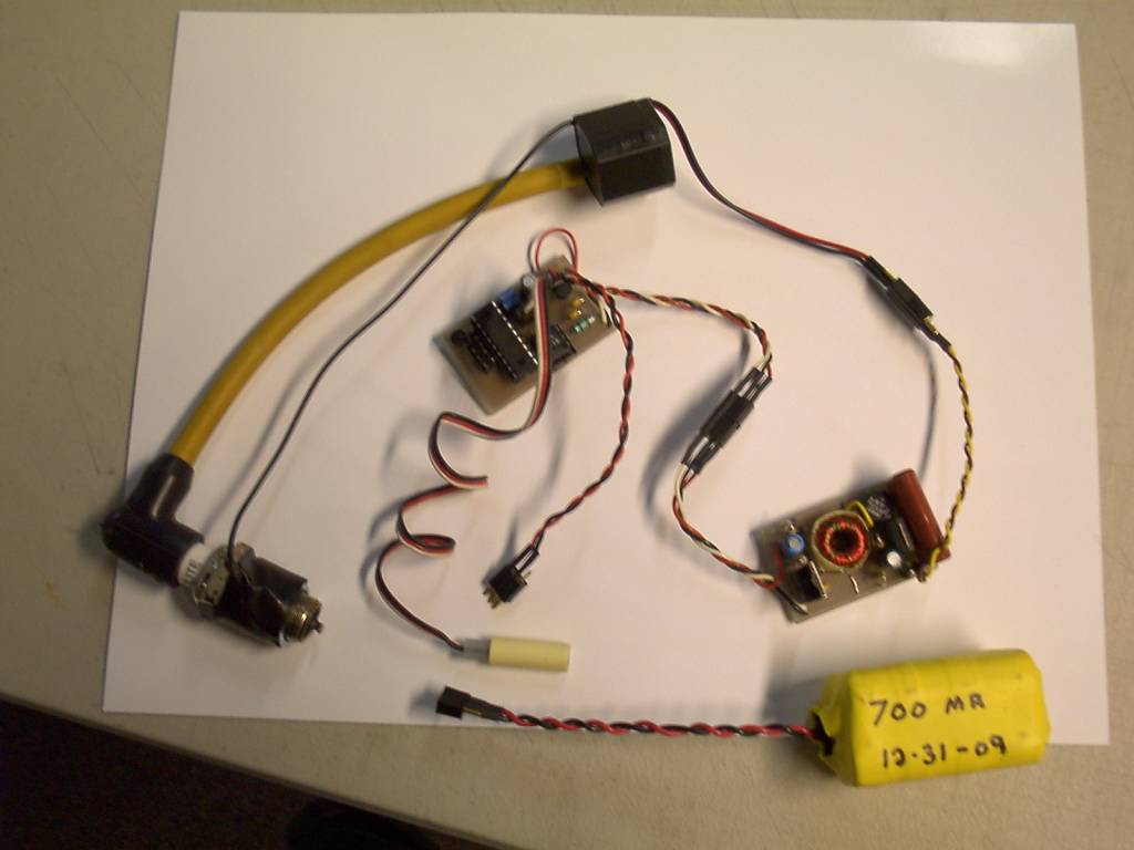

As I looked at the voltage drop on my VOM, it showed me that my theory was correct. I jumpered out the regulator and all functions are now normal down to 3.8 volts, at which time the pic chip's internal brownout detection takes over and powers down the chip...
I am getting almost 3 hours continous running time now without a problem, on a 700 mah 4.8 volt nicad pack! Excellent performance as far as I am concerned..!
All I did was jumper the VR out of the circuit altogether, which eliminated the dropout problem.
T106d is a 400 volt-4 amp unit.
TIP42 is almost a direct substitute for the BD242 which I did for the fact that I can buy it at Radio Shack. I think the Hfe on the TIP42 was a little less but it functions well in it's environment.
Doing the 2 changes I made to the CDI board itself concerning components was to substitute a TIP42 for the BD242, and a T106d for the BT151...current consumption dropped from almost 900 mah to 300 mah with this change on one of the 4 boards. Maybe I should change all my boards? Voltage regulation doesn't seem to be needed.

Rob, it is a battery supply problem, I agree..
I might try 2 cell Lipo pack with an external regulator (LM317T) as suggested by Kermit, to keep the supply steady at 5.5 volts. I love to experiment, but the cost of parts is killin' me right now..$50 this week and since I am currently unemployed, that hurts a bit. Still have to change the initial curve in the PIC16f628 I am using..my 20cc motor with the 15" prop can take it but the 2.4 cu. inch chainsaw motor I converted doesn't like the steps in timing..

Rob, I jumpered out the regulator in the timer boards.. All working perfect now! Since I only will use 4.8 volt battery packs, it won't be needed.. thanks !
Question for you.. what does the 2 pins marked BREAK on the component picture do? can't get anything out of these two pins.. other than my initial problems with battery voltage, everything is working great now..except for timing light feature, but I don't use that anyway.
Making more boards for the rest of my planes that had fixed timing. What a joy it is to have the engines easily start now.!

If you put the two schematics together (TCI and CDI) you canb see the differend output of the opto.
The opto was placed to protect the pic for backslash from the scr.
You can try to remove the opto, the signal from the pic will be the same of the signal out of the opto.
A better idea, take signal from the flashlight for test.
A resistor of 150 Ohm between and the flash-out, from the pin flash-out you have now the same signal.
