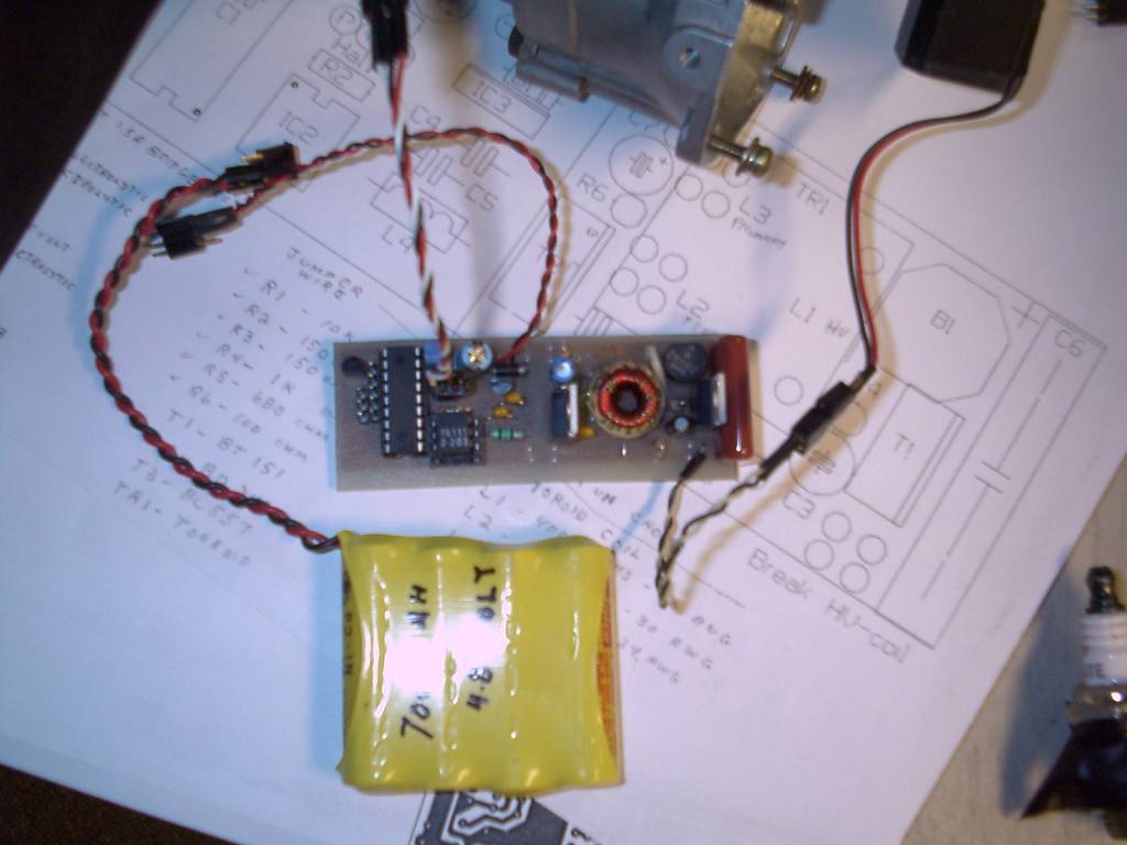

Rob, I have everything working for the New CDI as a single board....built the RCD version 2.3 programmer and it works fine..loaded the hex file, programmed the pic16f628 chip. installed a TIL111 optocoupler. Installed the PIC chip, powered up with the top jumper removed, got fast mode test just fine. Reinstalled the top jumper, removed the bottom jumper, got the slow speed test function working...unplugged the battery, replaced the lower jumper and powered up again. Tested the CDI with the hall effect and magnet..worked perfectly !! Thanks..
Only one problem afterwards...with all jumpers installed and battery plugged in, it shouldn't be sparking..but it seems like the low speed test jumper is removed and it gives a slow tick....tick...tick...spark on it's own...what should I be looking at, a bad part or is there a problem elsewhere in the programming? Any help would be appreciated... At least it worked perfectly the first power-up..thankful for that... I have used the LP2950CZ 5 volt low dropout regulator which is that same size as the BC557 transistor...it's rated for 800 milliwatt..should be fine for the chip power.. maybe the BT151 scr is leaky??? Had a few off spec parts give me that problem a few years back...anyway, thought you and the rest of the forum members here would have liked to hear a success story for a change.. It worked, and I owe it to you and JMJ for a great project!

It looklikes the scr (BT151) live his own life, try a other one.
I know from others, if the Voltgae from the HV-coil is to high, the BT151 can't handle it.
The high Voltage can only when the CDI is running in low RPM - test 300 RPM.
I'll change the low-test in the program to 1000 rpm, maybe this will safe the scr.
Others use a FET or a IGBT, I don't have problems wih the BT151.
IGBT - IRG4BC30K0 or some other N-channel IGBT

Rob, it seems I have found the cause of the unit sparking by itself!!! As I tested it the first time the battery was fully charged fresh from the charger and voltage was 5.6 volts... after first testing was completed, about 20 minutes time had gone by. Well, as it seems, the unit is very power hungry and consumed enough voltage from the pack (4- 700mah nicads) so that the end voltage after the LP2950CZ regulator was below its dropout voltage and the unit was resetting the pic startup. As I see it now, I can't go to 5 cell pak because overvoltage does the same thing as under voltage..creates it's own sparks.
So I have found the cause... now to find the cure! Oh, by the way..I used the New Cdi to run my newly converted weedeater motor today...P E R F E C T !!! Absolutely flawless! Now if I can figure out the voltage drop problem, I'll have a perfect running system.... Everything you have changed over the last 6 months was added to this PCB and I must say, if someone followed this forum and knew how hard we all work...especially you Rob... Thanks a Million !

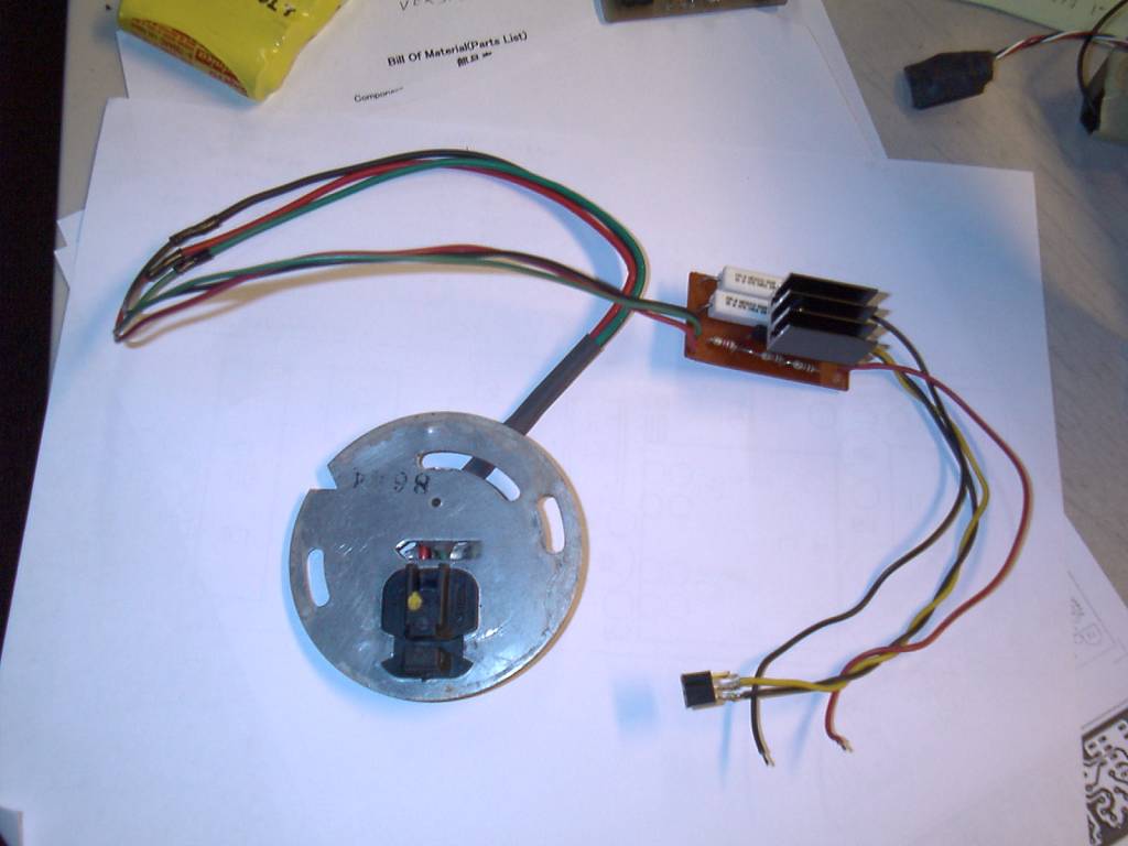

Here's a TIM-4 TCI hooked up to my Harley Hall effect sensor timing plate which I have been running on the '73 Sportster for a year or so. Used a 6 volt regulator to step down from the 12 volt ignition voltage to 6 volt for power to it. Anything's possible if you have an imagination!!

If you have a spare timerboard, you can use it.
You can also connect the exist timerboard to the Vellemankit.
IGBT's are hard to get here, I ring a lot of shops before I found one (!).......I can't make mistakes with onle IGBT [

At the time be I use a BUT12A to do the job.
I make space on the PCB for C6, you never know, but I don't think you have to use him.
Into the Vellemankit is also a C (0.22uF).
BTW, you can use the Vellemankit too, connect the output of the timerboard on point 2, remove R1 and R2 and replace a dummy R (0 Ohm) for R3
Attention, you have to make some changes into the C-code if you gone use the TCI !!!
A normal sparkcoil will fire-up for 45% of the time, CDI-fire-uptime is 56us to fire-up the scr.
If your engine runs 16000 rpm, the pulstime wiilbe ~4ms for the hole puls.
If we don't change the fire-uptime, the sparkcoil isn't fire-up long enoufg.
The dutycycle we have to make is ~35 till 45% if we change the delay to 1500us
50Hz = 3000 RPM = 20ms = delay_ms(10) or delay_us(10000)
3000 rpm = delay_ms(10)
6000 rpm = delay_ms(5)
9000 rpm = delay_us(3300)
12000 rpm = delay_us(2500)
ONLY CHANGE THE RED TXT INTO YOUR CODE - DON"T COPY THE CODE BELOWE !!!

OK...typed changes into c-code..saved it...now to finish the board!
Scope trace would show changes too.. thanks Rob !
Trying to locate my scope program to display signal trace on the computer..now where did I save the program??? Hah !
Must be having a memory lapse in my old age..
