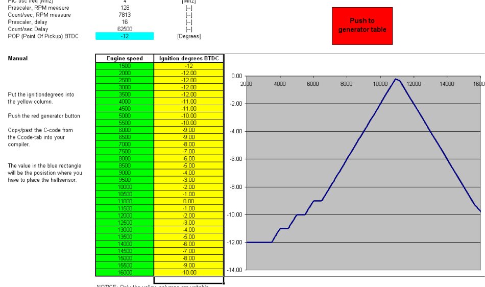

yes i get errors....before when i hex file was there there were no errors but hex file was to small
im stuffed if i know what im doing wrong.....i need a kid to show me haha
#536
What are the errors? copy and paste them here. There were some errors on the code I have sense fixed mine and Rob has sent me a updated version. I can email it to you if you want.PM me your email.
#537
Hi Rob,
Brett got me straight. I have another question. in the latest version of excel sheet the POP is 36 degrees. What if my engine has the hall set at 28 degrees? how do I compensate for that? can I change the POP ?

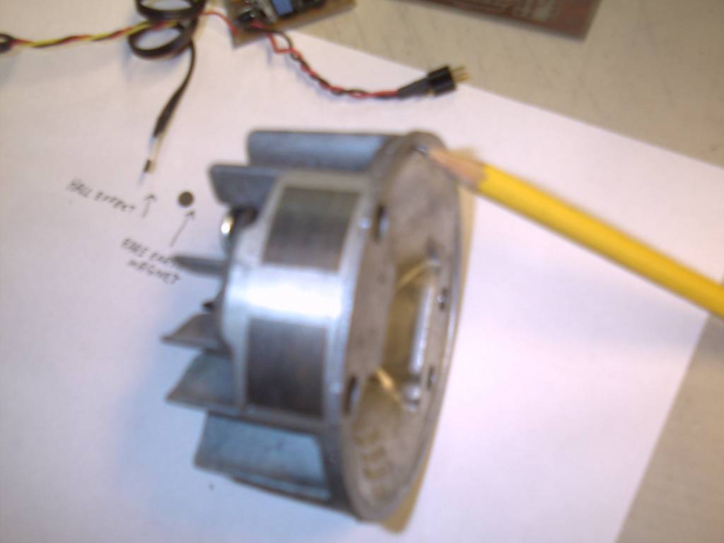

Brett, If these pictures made it here, take a look at the pencil pointing to where you'd drill your hole for the magnet.
Just an example of what part of the flywheel to drill for the magnet..not at that exact spot..you'd have to determine that by TDC and measure of course..just an example. I've done it and it worked..you have to figure out if you have the room and how to place the hall facing that spot..hope this helps.
John
John

Joined: Nov 2009
Posts: 109
From: AK, NEW ZEALAND
John i like that idea..... so i just tested where i need the magnet and its right where the other magnet is (south pole) plus
with the hall pick up on the inside of the flywheel it still picks up the first north pole magnet and fires the spark
if i could get Rob to adjust the xcel file my life would be simpler
my pickup is 122mm BTDC that is 90 degrees on a 85mm diameter flywheel
3.14 x 85mm (Diameter)
266.9 / 360 = .741mm
.741 mm per degree
brett

#542
Joined: Nov 2009
Posts: 109
Oh yes i see it your way,
i just find it hard to mount the pickup anyway else than where it is,
which is 122mm from TDC
or 90 degrees
Rob is there any way to make the exel program change the pickup point if chosen to be say......90 degree
or insert a minus number into the exel sheet like -65 degree
or 90 degrees
#543
Joined: Dec 2005
Posts: 548
From: Alkmaar, NETHERLANDS
I hope to explain it better where to place magnet and hallsensor.
Set the engine in TDC and mark the boddy and the shaft.
Any place on the body or the shaft is TDC !
Pick a point anywhere where you want to place the magnet.
AND NOW HERE IT COMES.......tatatataaaaaaa.
Calculate 40 degrees backwards from the point you where you have place the magnet and you have found the place for your hallsensor.

#545
Joined: Dec 2005
Posts: 548
In the Netherlands we have snow, huminity 12%, -1.5C and it's 12 AM
The sheet calculate the timetable for the pic, and the pic calculate with the table the sheet makes.
Into the pic there are also timers and prescalers who calculate with the sheettable.
If I change only the sheet, the pic will be lost his calculation.
This is one of those things I want to have to change in a new code.
BUT, I'm not a real programmer and I can't write a real program todo this.
#546

#547
Joined: Dec 2005
Posts: 548
You are still using the old Exelsheet........and this sheet produce wrong tables !
If your using this old sheet, yopu have to calculate backwards.
36 degrees delay is calculate from 40 degrees wqtih this old sheet.
Please use the new sheet.
#549
Joined: Nov 2009
Posts: 109
which ever one i am using do you think i can input ( - ) minus numbers to make it work ???
the new exel sheet will not let me put - minus numbers into it but the old one will
