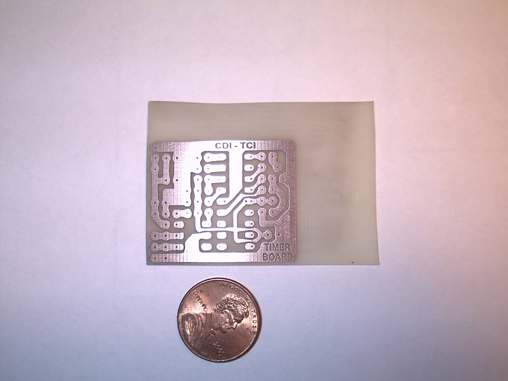

Rob, looks like you were very busy over the weekend! More stuff to tinker with. I downloaded all the files, making the new timer board. I see where you added the resistors to switch the pulse from negative to positive..nice work!
I'll add 2 jumpers to mine so it will work either way just changing jumpers..wonderful idea you had!!
I did this already on my power board, so I could use your board..now this makes it really nice and universal.
Only thing now is finding the other parts. Not a problem here where I live..many parts stores close by.
Great job on the CDI curves too! Easy to see what needs to be changed. Yahoo !!! You Da Man !!!

I just finish the TCI-boards and find out not all the components can good fixed on the boards.
The TIP162 on the TCI-powerboard is not on the right place, I can't fixit to a coolframe.
On the timerboard the regulator takes to much place and have to fit at the bottom of the board and 90 degrees turnover.
Also the C 220uF is to big, it can be a 47uF/16V
A few little problems can't distroy my day [8D]

Brett... If you can use the timing light feature (flashlight led), You may be able to see the timing change after it reaches 1000 to 1800 rpms. First spark sets the delay, then it follows the curve set in the software.. but it must see rpms as stated in the c-code to track it and change the advance..
My test setup only started to read at 1000 rpms with the timing light, but it does work. Setting the delay lower causes problems since that would yeild negative numbers and give an assembly error when you compile it.
Just my point of view.
I spin my motor with the plug out of the head with an electric motor (these are weedeater motors I convert), no chance of the motor backfiring or having preignition till I get the timing set.
As I vary the motor speed, I can see the degree wheel rotating in the timing light. That's how I tested mine.
I know your setup is different, but they all work the same from what I have seen..built 9 of these now and all function for me.
I just etched the newest CDI-TCI timer board..will have to see how that one works tomorrow..

@gr8flyer55, thanks to explain the output of the new board.
I'll change today some layouts so everything can be placed on the pcb without braking the parts.
With the pcb you have nao, nive pcb you have make, the 5V regulator didn't fit on the board.
The 220uF capacitor can have a value of 47uF/16V and the 47uF/16V can be replaced by a 10uF/16V.
On the TCI-powerboard, D1 must be 1N5406 for a small sparkcoil and a (10A diode) if you use a big sparkcoil.
TIP162 must be replaced and the 220nF capacitor will be placed to the bottom of the pcb.
