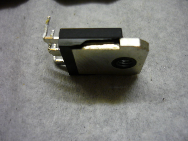

i put a 33 ohm resister on the gate and ground to earth and it still goes hunting......silly SCR
even when i ground the SCR gate to earth it does not stop the hunting ***
i changed SCR, no difference
brett

Some basic electronics.
U = I x R (Voltage = current x resistant)
U = ~300 Volt from flyback transformer
I = ?
R = 0.7 Ohm
I = U / R
I = 300 / 0.7 = 428 Ampere......I think the scr can't handle this current (?)

OK so i need an old points coil to test ....... with about 4 ohms,
i try tomorrow....its late now and all this testing R&D is tiring
If i reduce the input voltage down to 3 volts it sparks every 2 -3 seconds and i can then also trigger the gate from the positive pulse

Ok i tried a .75 peice of plastic between the mullard former and that makes the transformer very quite.....but still self runs,
Charlie i tried changing the RC value to 1 k it slowed down the trigger, then 2.4k that stoped the circuit runing and overheated the BD242 (tip125)
I dont think my isses is on the RC side of the circuit, Charlie what did you do to fix your problem ( HV cap is 630 volts)
the more volts i use the faster the spark self runs,
brett

I have my power board working on the test bench
i used part of "sportsDevices" circuit and bigboats
triggers fine, but over 3.7 volts the tip125 gets hot, i chose the tip125 because its a 5 amp device
brett

I also ran into that problem with the transistor getting hot. Do you have a base resistor in the circuit? I have found that a 100 ohm is a good value. I found that in my experiments that if the transistor gets hot I Needed to reduce the amount of turns on the feedback windings.
Old 02-04-2010 | 09:38 PM
  #649
Joined: Nov 2009
Posts: 109
From: AK, NEW ZEALAND
Default RE: New CDI - opensource project JMJ and Bigboat
that was not nice having the site down......i felt alone haha
I have found if you current limit the input voltage the compontents run alot cooler
i just fitted a 10 Ohm 10 watt resister in front of my 7 volt pack, have now stolen couple fast recorery diodes from a TV in place of my IN5408
seem's nice now
brett
yes base resister is there,
circuit runs at 180 ma's and triger is about 250 ma's ( very hard to read triger)
