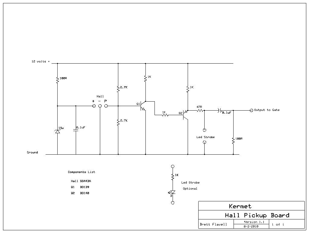

Hi All,
ive been testing a circuit a modified for the hall SS443A last night and just finished it,
it can go in front of the power board, ive used this sorta circuit before with CDi ignition and gained 2000 Rpm even with fixed timing,
cheers
brett
Caution i have updated this Circuit
cheers
brett

Joined: Nov 2009
Posts: 109
From: AK, NEW ZEALAND
Hi, Bottom right on this page second file up
http://www.modelbouw.gompy.net/newcdi/newcdi.htm
Check this out
Range testing
my 1975 Power board project now hooked up to my hall pickup circuit above
http://yfrog.us/09dscn2475z
im getting 30mm and sometimes more.....
brett
