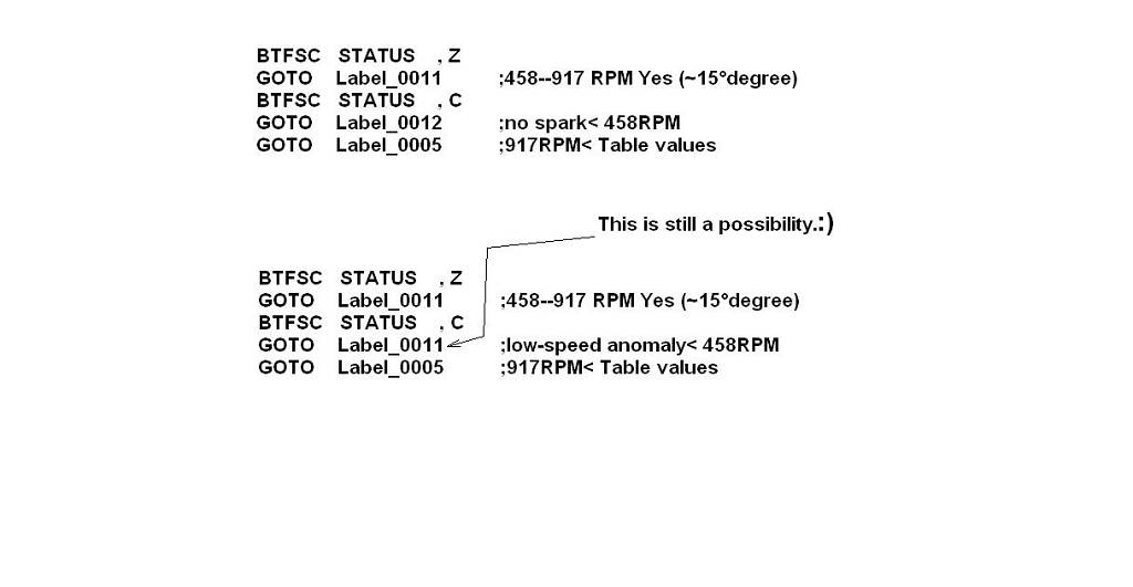

Nyemi, I need the starting degrees to be at 6 degrees. If I try to start my engine with the curve set the way it is, it kicks back hard when trying to start. Maybe setting advance from 458 rpm to 1000 rpm to be 6 degrees would work better.

Hi Nyemi,
Thanks for all your efforts. Inital or POP(point of pickup) timing is 28 - 30 degrees BTDC. At starting rpm(rpm > 500) the curve needs to be at 5 degrees BTDC to avoid kickback. once the engine starts and idle then the curve can begine to advance. Thanks again.

Default RE: New CDI - opensource project JMJ and Bigboat
Hi COM
I asked. 458 rpm under a green or black curve?
Motor bicycle works: no spark &lt;458 RPM
You manually operate the engine.
I, therefore, deals with low RPM.
<span lang="en" id="result_box" class="short_text"><span title="Kattintson m&aacute;s ford&iacute;t&aacute;sokhoz" class="hps">I count reverse.</span><span title="Kattintson m&aacute;s ford&iacute;t&aacute;sokhoz" class="hps"></span></span>

Hi Charlie...
It seems to work for me now that I reduced max static advance to 15 degrees. Need a reliable excel sheet.
John

Hi John,
with the inital timing set at 15 degrees you won't be getting all you can out the engine.As I am sure you know.
I know Charlie, but at least it's not kicking back now. The advance should actually start after 1,000 rpm. That seems to be so hard to accomplish with this program and excel sheet.

Charlie, have you had any luck editing the excel sheet for Nyemi's new assembly program?
I had tried awhile to get it to stay at 0 degrees until it reached 1000 rpms. Every time I try, it seems to revert back to 458 rpms. Wish I knew the trick to get the edits to stay what I changed it to. That's all I need to complete the hex file to make it perfect.

Charlie, we have perfection! Absolutely perfect!
I am getting 1 flip hand starts without a chicken stick.
1800 rpm very reliable idle and beautiful top end performance of 6800 rpm on my 25 cc conversion engine.
That's down from my normal idle of 1950 rpm and over 400 more top end from my usual 6400 rpm max I had before!
Excellent results I think.
I am in the process of getting everything finalized for a complete package ready to go and cheaper than an RCexcel.
