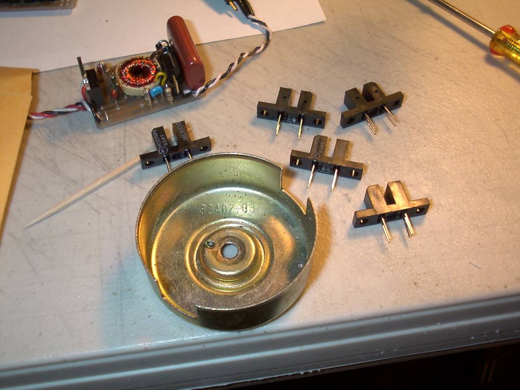

Gentleman, I have a question.
Why we all use a hallsensor and not a opto like they do into the automotive ignitions.
http://www.elektronik-sachse.de/ZDG3...4_guzzi_en.htm
I use for tests also a optosensor becourse hallsensors aren't acurate for testpurposes.
I need a real TTL-signal and not a wave like hallsensors do.
Maybe a reflection opto sensor can be use ?

Hi John, I don't need the component.....I've a loot of those components in all kind of sizes.
I only want to know if a opto is also a option to use ?
I think a hallsensor is not acurate enough, and thats also the problem with this designe and software we use.
I test some new hard and software and see the differend between a hallsensor and a optocoppler.
The opto trigger every turn in the same degree, a hallsensor depent on the rotation speed.
At low speed the magneticfeeld of the magnet is bigger the at high speed.

Rob, I've noticed that result also. as you saw in the picture, I already had a slotted cup which was used to trigger the devices. It works quite well actually since it was infrared, No light sources will affect it and they are very reliable. The devices I bought are just a little large but I had made mounts for them easily. As for the circuit to accept them as a trigger, it is easily made.
I'd say if you have a design to accept them, go for it! I am willing to change anything needed to use them.

I have used the opto device as a test to replace the hall effect and it is very reliable. The devices I use have 5 leads..the led side has 2 connections, one of which I couple to the other side for power of the reciever. the 3rd line on the reciever side can be eliminated which is the base for the transistor...essentially giving you 3 leads.. power ground and signal, just like the hall.... only faster.
John
