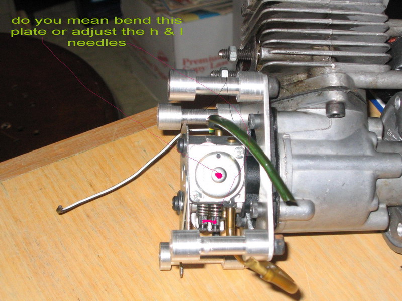

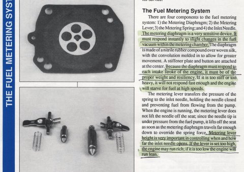

aero nut
2 quetions
1) Can you explain by what you meant by lifting the carb a little bit. I am not sure I understand
2) What is the harm with running greater that a 3 % oil content other than more goo over the plane? If you use 18% oil like, in standard glow fuel, and mix per you recommendation you end up with 6% oil. That is still a big reduction.
Dave
2 quetions
Dave
Joined: Mar 2005
Posts: 266
From: Branchburg,
NJ
Captinjohn
My assumption is you need to lift the needle higher to allow for more fuel flow through the carb. Since you have alcohol in the fuel you need more of it per stoke.
How much higher do you need to lift the diaphram and how do you accomplish this? Do you just bend the little lever?
Dave
Dave
First, I recommend that you try the carburetor stock, (as is). Some carbs I have had to raise the lever a slight amount, others were fine without modification. If you can't get it to run rich enough without turning the needles out excessively, or if it won't get rich enough at all, then raise the lever a touch and try again.
The alcohol/nitro/oil mix in a standard glow engine burns cooler than gasoline. The oil itself doesn't burn, it just gets shot out the exhaust and blown all over the plane. Gasoline burns hotter, and most of the oil is burned with the gas. Therefore, if you run an excessive amount of oil in a gas engine, it will carbon up. This will cause problems with the glow plug in the short term, and ruin the engine in the long term. What happens is that eventually, the rings carbon up and stop moving in their lands, or grooves. Then hot combustion gases blow by the rings and burn the oil off the cylinder walls. The engine then seizes up, and it's good bye piston and cylinder, and if it happens on a low inverted pass, maybe good bye to an airplane! Please, use the mixture we came up with; it's a tiny bit heavy on the oil as it is.
AV8TOR
AV8TOR
