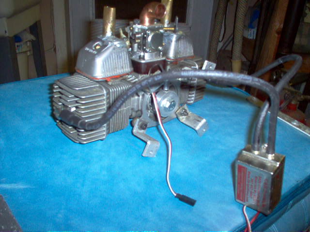

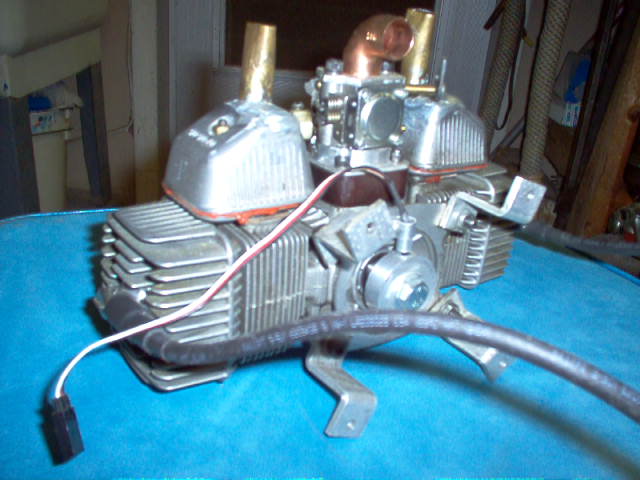

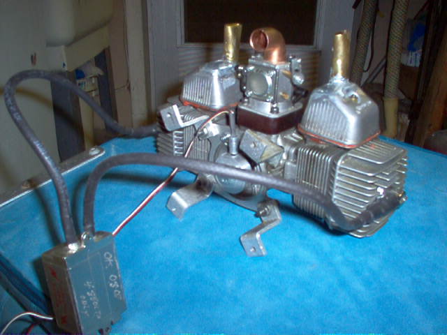

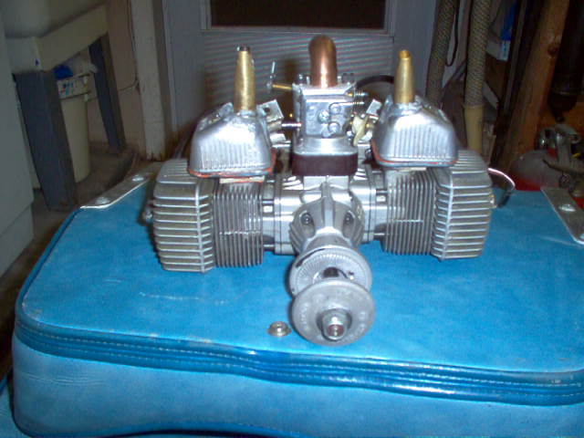

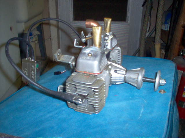

I have modified my TT to work with CDI. I bought the chinese twin CDI from CH ignitions ( about $110.00) drilled and tapped heads for CM6 plugs. Really worked well. Have only run on test stand so far, idle is sweet and low. Didn't change original carb, just readjusted needles. Good luck, red

Old 11-21-2007 | 08:13 PM
Joined: Apr 2004
Posts: 312
From: cape coral, FL
Default RE: Super Tartan Twin
Am going to try posting pictures for 1st time. Here goes.
I'm not sure if the pictures worked... I'll try to fix them if nothing comes up. red
