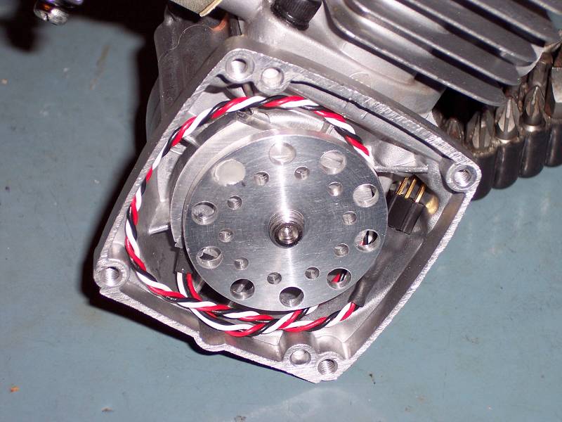

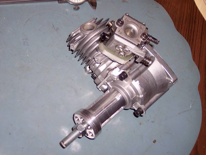

Number 2 will be ready to go this weekend.

Flipflop nice work. What WA carb are you using? Also, looking back at the posts I can't understand what holds the bracket with the senor on the case and keeps it from moving. How do you keep the timing hub on the back of the crank?

Looks like the timing wheel just threads on...and maybe some locktite! Just a Guess. Capt.n

That's an old G-23 carb that I'll use until I get another 11mm. Walbro. The sensor ring is a light press fit on the nub on the rear of the motor (that is identical to the nub on the front of the motor) It fits tight enough that I can use a drop of locktite or a tiny dab of J-B weld to make the final permanent installation. You've got to fit all of this together "dry" and check the timing to find the exact location for the pulse switch. Stock crank, LH external threads on both ends. Motor rotation will keep the timing wheel tight on the rear end (no jam nut needed) with just a drop of locktite.

Captin, Thanks for this website. Question: what holds the "timing sensor support" in place? Just a locktite press fit? Seems like vibration and heat/cooling would loosen it. Can you clarify? ,,,,,,,,,,,,,,, R

Antique: I just looked at the back-side of my Echo 2400engine. Around the crank seal you will see a perfect round part of the case around the seal. The O.D. is about 1.010 inch DIA. Now if the right size hole is made in sensor mounting plate...it will press on to that. A little locktite and it will stay. There is one web at top on my engine that would need to be removed. I think you will see what I mean. Capt,n

Aluminum crankcase, aluminum timing ring, even if they are different grades, I'd bet that the coefficient of thermal expansion is going to be very close. Vibration, well this is a very small part located around the C/L of the crank, any acceleration/deaccelerations are going to be very small. This little part only weighs a few grams so it's not going to take too much to hold it in place. If you were hanging a 4lb shop hammer off the rear in this fashion, then I'd share your concerns. Anyhow, mine is now attached permanently and I'm not the least bit worried about it coming off. Guess you could use one of the high temp RTVs if you are worried about the heat and vibration.

Nahhh. Loctite and a press fit is fine. For that matter the press fit would be fine too. If you ever tried to remove a prop hub from the crank you will trust the Loctite. Takes near 400 degrees of heat to break it free. Been there. Nothing near that temperature in that area. FWIW I use the 620 Loctite for hubs. Expensive but a small bottle lasts a long time. A little on the thread and a little on the crank and thats it.

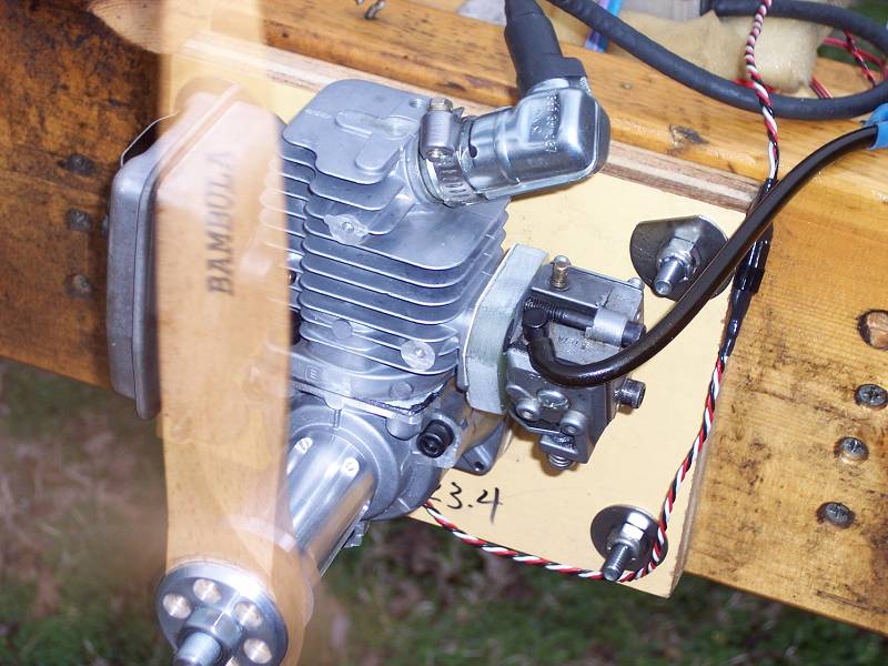

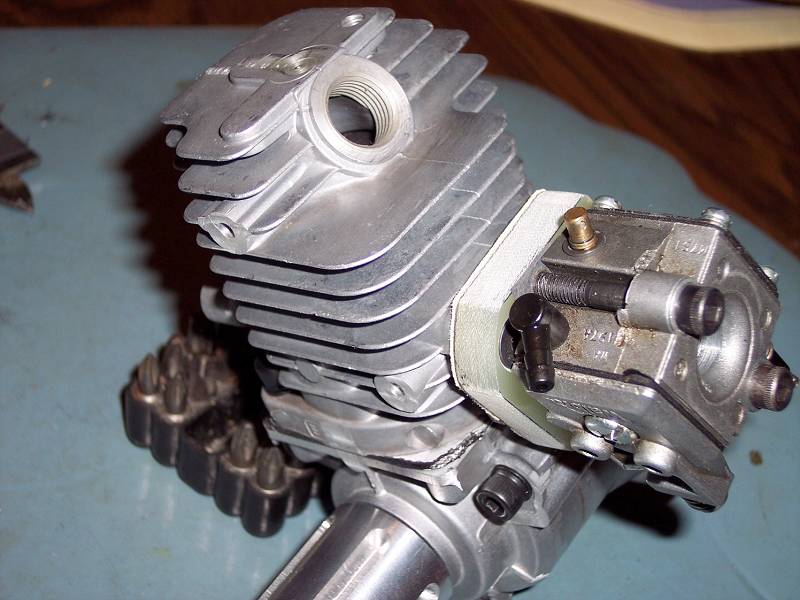

Got another winner here, sweet, smooth running little motor. Time to start saving up for a Funtana X 100 or a Jerrys Big Boy.

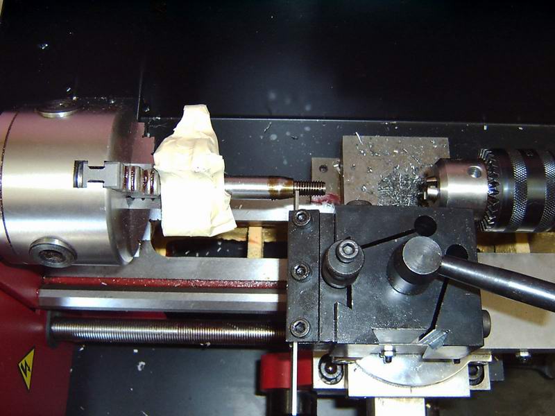

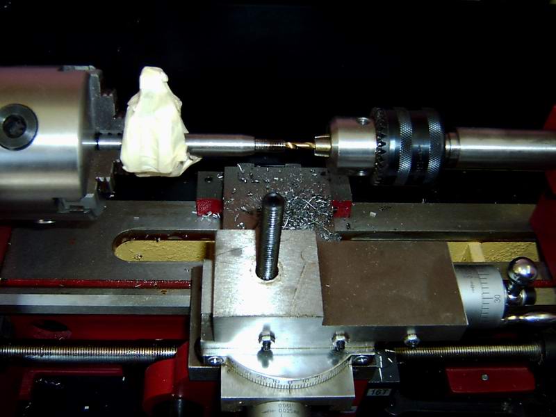

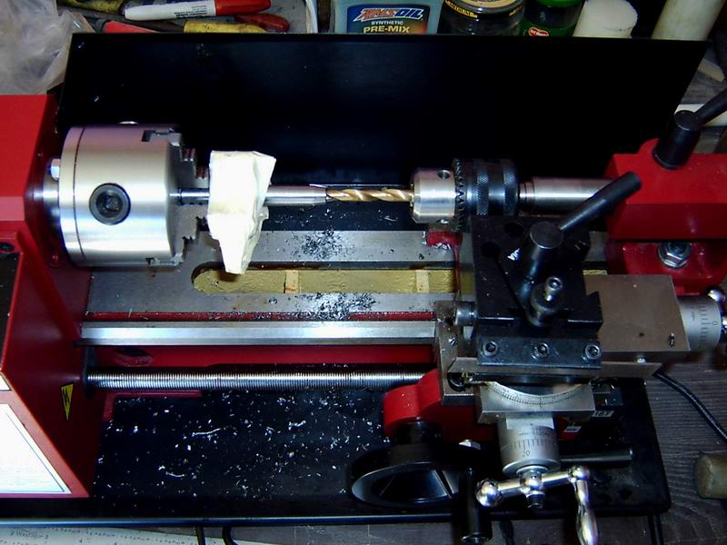

Ok, about those left hand threads.... I rather did this for Captain John, but I think he's on vacation.
Anyway, here's some pics and instructions on a good fix.
The first one shows the crank all taped up to keep the bearings somewhat clean, chucked up and centered in the lathe, and being drilled down the factory center bore with a number 29 bit. I drilled this pilot hole as deep as I wanted the stud to eventually go, which is approximately 1.5". I ran the lathe very slow; so slow that I could almost count the revolutions, and had no problems. Just go slow, don't force the bit, and use a little cutting oil.

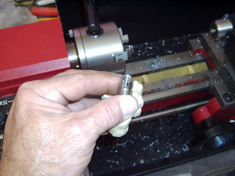

The second pic shows getting ready to part off the left hand threads. There are two advantages of using the factory counterbore to pilot drill the crank first. One is you don't need to use a center drill to start your new stud hole, and the other is that the left hand thread portion can be parted off easier after you've drilled the pilot hole.

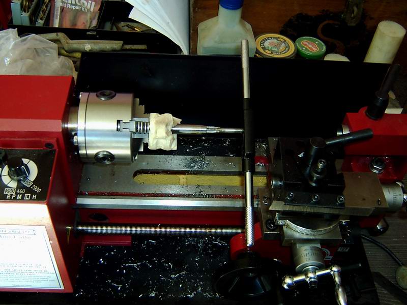

The third pic shows re-checking the centering after the parting operation. The crank is now ready for drilling the hole to be threaded for a stud, right down the pilot hole drilled in the first step.

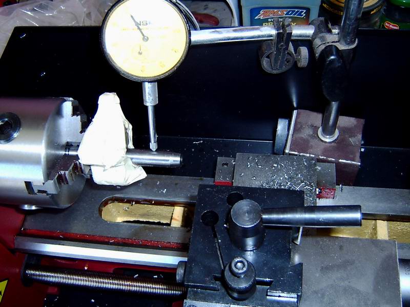

Pic four shows drilling the hole for the stud with a "I" drill. (This is for a 5/16" x 24 threaded stud)
Pic five shows tapping the hole 5/16" x 24. Be very careful to get the tap started straight, as the hole will most likely have just broken into the bottom of the key slot. It's no problem, just work carefully. (That's why I made the hole about 1.5" deep into the crank; to have good support beyond that key slot.)
And pic six shows the completed crank, ready for a stud and a normal prop adapter setup. Now when I start this engine up, I won't have any worries about the prop coming off, and I think this is an easier operation than making a custom prop hub to accomodate the left hand threads. Also, no matter how well you taped the crank up to keep it clean, I recommend a thorough cleaning, blowing out, and re-oiling of the bearings before you assemble the engine
Hope this helps someone,
AV8TOR
