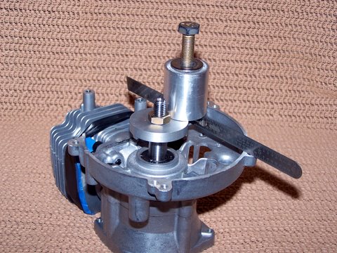

Capt,n Flipflop is referring to the area between the back of your machined flywheel and the seal in the front of your engine. Basically all the forces or loads are on the threaded portion of the crank. Not too stable and can break off. Ideally the hubs should fit closely over the area behind the threads on the crank and be an 1/8th inch in front of the seal as in this picture. This is a 16cc Echo I did some time ago. You don't need the key. Just use a good Loctite type sealer. I use 620 and it is tough stuff. The taper on the crank and hub will lock together even without Loctite.

tim220225: That is a very good looking job you did on that engine. Also a very good job on explaining about the possible breakage. Do you plan on the same set-up even if you cut and re-tap crankshaft for right hand threads? I am wanting to get to another project. I will put the Echo on shelf for now. I have 2 of them and will take one to the next swap meet. I want to trade Echo 2400T off and get a big Moki or something simular. I plan to make a gas head and see how that works. There is a place that will install needle bearings in rod. May even try Gas/glow in one. Just want to try something else right now. Capt,n
