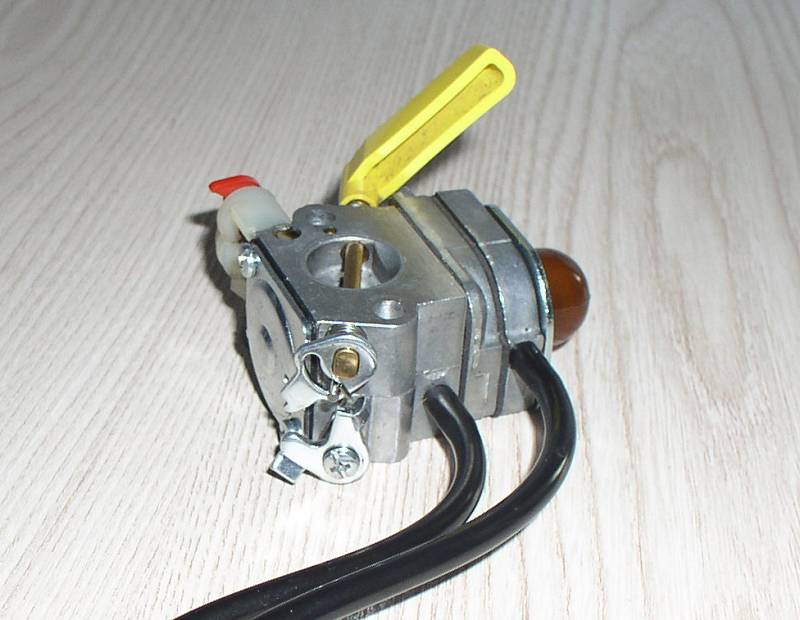

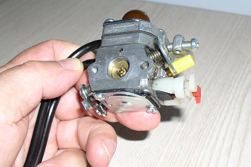

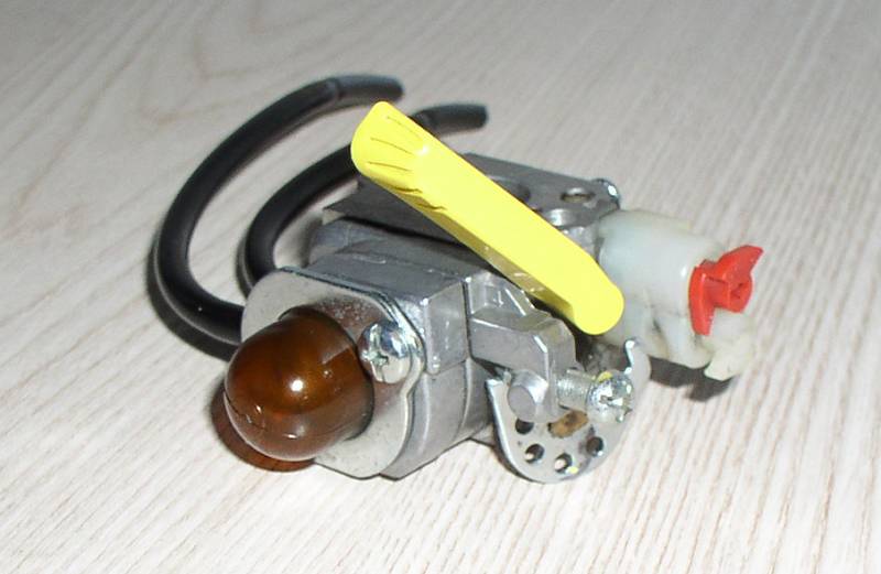

The Homelite 25 cc that I'm about to convert, came with a Zama carb H46 14A model, I've never used Zama's before, should I stick with this one or should I replace it with a Walbro, this one has a 1/2 inch venturi size, what about the priming bulb is it an advantage to have it on our models or should it be discarded?

Walter,
The Zama will work ok. The primer connection can be blocked off if you like. The engine would perform better with an 11mm carb, either Walbro or Zama.
Dave
Old 08-26-2006 | 09:39 PM
w8ye's Avatar
My Feedback: (16)
Posts: 37,576
Received 11 Likes on 10 Posts
From: Shelby, OH
Default RE: Zama or Walbro, which is better?
You need a bigger carb (11.11mm) either Zama or Walbro

OK, got my answer, thanks; guess I'll have to look for another carburator, this one is only 9 mm, maybe I can open it up a bit, I am used to Walbro's also, never had a Zama before, thanks guys!
