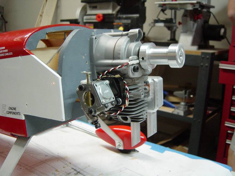

Here is the picture of the one I have. I want to sell it. $80.00 as it is in the picture. An ignition from CH is $89.95.
www.rcuniverse.com/forum/m_4848205/tm.htm

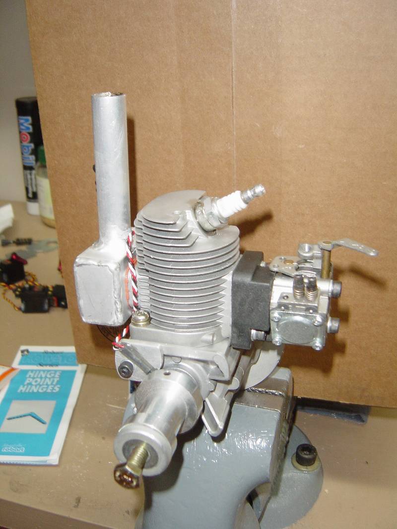

Anyone know what model trimmer this comes out of? I couldnt' find it on the Echo website. Is it the KE-140DA engine?

You could buy it now and run it on gas/glow mix. It would save a bunch of weight as well as the cost of a CH unit. You could go with CH later, when more money is available. All it would take is a glow plug adapter an a hot plug.

I still haven't been able to find out the models of Echo trimmers this engine is in, anyone know? Would be fun to find one cheap or free, grind it down a bit, buy a muffler and glow plug adapter. I've always wanted to try the methanol/gasoline mix, it really seems the way to go. No onboard battery, no heavy magneto, no nothing. And it's cheap! Don't want to sound like a broken record, but at this time the glow fuel would really be a cost factor: I fly alot

The 18cc Featherlite is light, but not very powerful. The Echo would be much better. I don't think the 16cc Echo has been made for quite some time, so it may be hard to find used. If I remember correctly it was marketed with various numbers from GT-1000 to 1600.... same engine. The 21 to 25cc Echos weigh only slightly more than the 16cc but have more power. The 16cc Echo would be nice on Gas/Glow, as it would help keep the weight down as much as possible, and increase the power a little. I sure like the Echo engines myself...

Probably less than 3/4 of a pound. I have a 21cc and it flew very well in the 60 size Seagull Models Edge we had it in. The engine is for sale also. Same $80.00 buys it too. Again an $89.95 CH ignition will be all you need to add.
