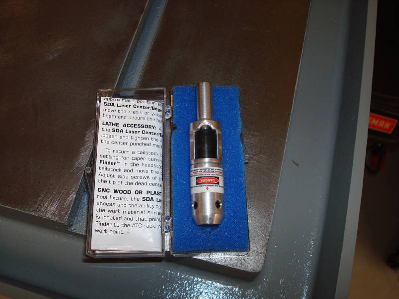

Tim: I read you now...loud and clear!!! I was going to do just that. Now ...did you ever see a gaget you can chuck in mill that has a lazer dot that shoots down to exactly on center? I seen one on the web...now I cannot find it again. Are they worth having? Thanks Capt,n
Old 12-01-2007 | 08:40 PM
  #406
tim220225's Avatar
Joined: Jan 2004
Posts: 1,005
From: Mobile, AL
Default RE: Lathe for conversions
Capt,n
Glad you have the process down. Once you start it will make sense. Take it slow and think it through. Yes I have seen one of the lasers you are looking for and I have one. I got mine from www.lasercenteredgefinder.com
Here is a picture of mine. I like it and use it for many things. If I need to find an edge I still prefer an edge finder and or wiggler. Once I get the digital readout installed I will use the edge finder and the DRO. I really like it for lining up centers etc. I would like to see your mill, can you post a picture or two?

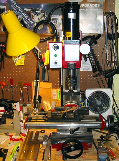

Old 12-01-2007 | 09:20 PM
  #407
Posts: 12,957
From: Hesperia Michigan, MI
I found 2 photos in my puter....not the best photos. Will take new one also.

Did that one come from Micromark? I almost got one like that before I got the Bridgeport.
Old 12-01-2007 | 09:49 PM
  #409
Posts: 12,957
It is a Harbor Freight Mill....same one Grizzly sells...but not green. Capt,n P.S. I can put a mirror finnish on the sides of that connecting rod. I like it!
Old 12-02-2007 | 12:13 AM
  #410
av8tor1977's Avatar
Joined: May 2003
Posts: 7,245
Received 6 Likes on 5 Posts
From: Tucson, AZ
Is that the one they sell for just under $500 bucks Captain? Do you like it? Is it tight?
AV8TOR
Old 12-02-2007 | 12:19 AM
  #411
Posts: 12,957
av8tor: I do like it You can make it tight as you want...its got adjustable ways. Capt,n

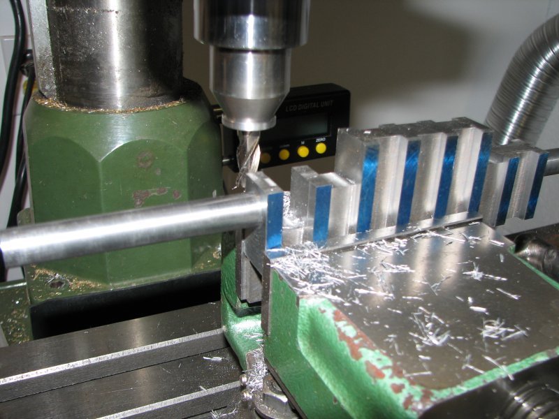

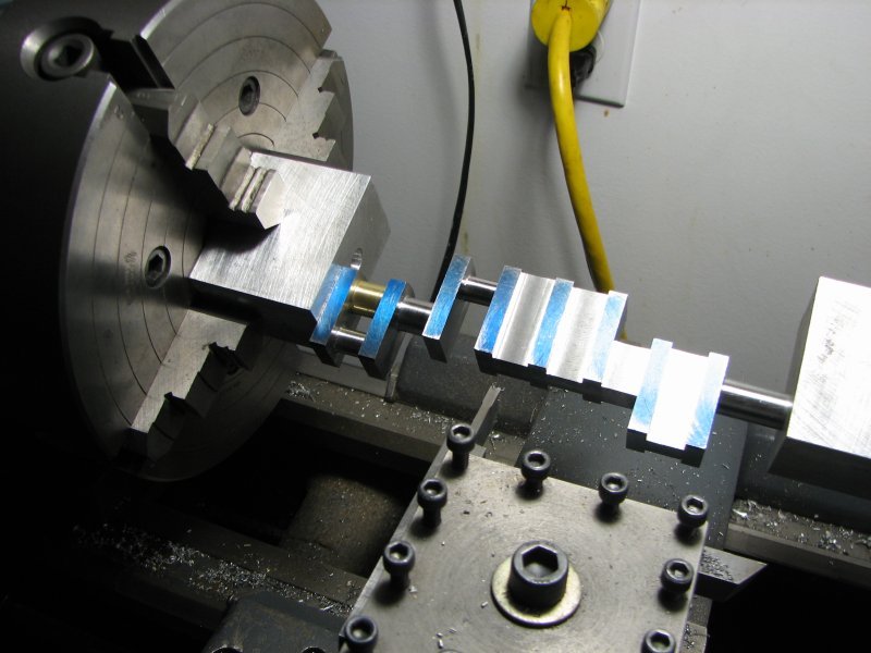

I forgot to measure mill travel in one turn! But here is a couple of nice photos. Hog that piece of metal with a mill...then put it in lathe. Looks easy. It is for some guys..not me!!! Capt,n

Old 12-23-2007 | 11:56 PM
  #418
Joined: Dec 2005
Posts: 1,345
From: iola, TX
Lookin good Capt,n.

Did anyone notice in photo 2 there was a piece of brass inserted in crank spaces? It is to help keep any flex in crank when machining the rest of the bearing areas. Capt,n
Old 12-24-2007 | 10:12 AM
  #420
Joined: Oct 2005
Posts: 168
From: Parma Heights, OH
Noticed it, but it is still a brave undertaking with a parting tool -- my least favorite tool. What alloy are you using? Good luck. John
Old 12-24-2007 | 11:58 PM
  #421
Posts: 12,957
This is not my work. It is the work of a freind. I am not sure what alloy he was using, or if he was using a parting tool. It may have just been turned in that position. He may have other tools in the tool holder. I will ask him. Best Regards Capt,n
