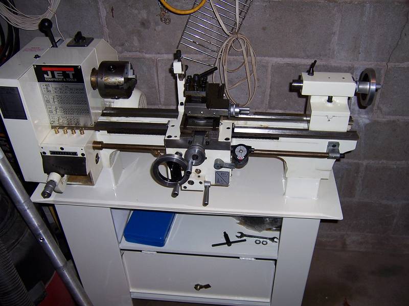

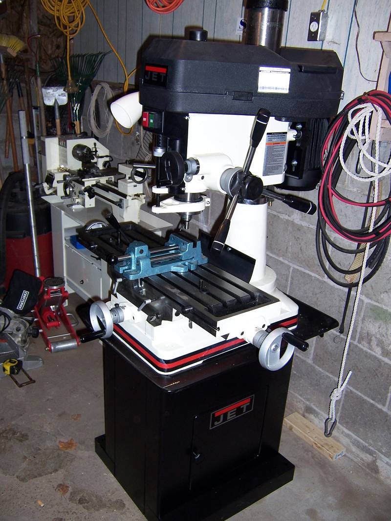

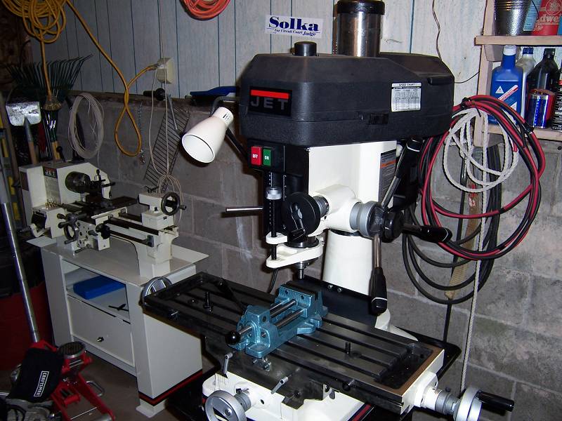

Old 12-07-2006, 11:28 AM
  #153
Mr. Mugen
Mr. Mugen's Avatar
Join Date: Mar 2006
Location: U.P., MI
Posts: 8,048
Default RE: Lathe for conversions
Hey guys I just got my machines set up on their stands. Here's a couple of pics of them. I plan to make some custom parts and whole cars.

Old 12-07-2006, 12:56 PM
  #154
captinjohn
Join Date: Jan 2002
Location: Hesperia Michigan, MI
Posts: 12,957
Mr. Mugen: Welcome to the Lathes for engine conversions Thread. That sure is nice Jet Lathe you got there. Sure like the mill set-up too! I see you are from Upper Michigan. I have a Grandson going to collage in Marquette. Hope to get up there when they have the Dog Sled race this winter. Click on my user name...and see "little miss mischief" Take Care Capt,n

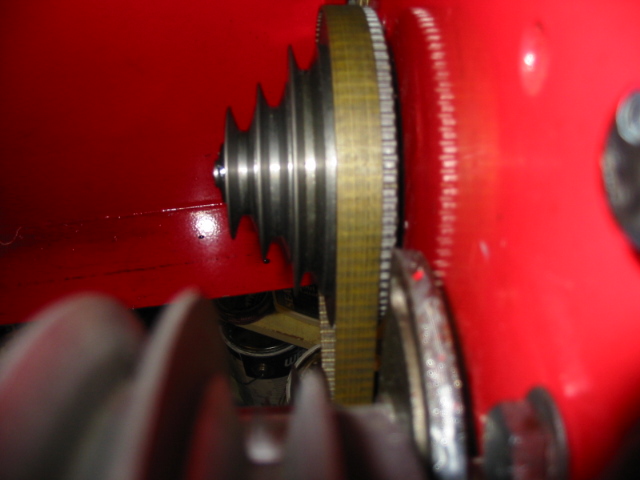

Old 12-11-2006, 09:21 AM
  #169
captinjohn
Join Date: Jan 2002
Posts: 12,957
Guys: I got a question? The drive belt with cogs on it wants to ride way toward the outside of the big driven pulley. The electric motor must be moved I think to get a better alignment so belt will ride more to the center. Can anyone shed some lite on this belt mis-alignment problem? My Lathe is a H.F. 8x12. Thanks Capt,n
Old 12-11-2006, 12:14 PM
  #170
RunningMan
Join Date: Jan 2002
Location: Hermon, ME
Posts: 81
You probably need to align the motor shaft axis so it is parallel to the head stock axis. In other words, the motor is pulley is a bit cocked with respect to the spindle pully.
Steve
Old 12-11-2006, 01:05 PM
  #171
captinjohn
Join Date: Jan 2002
Posts: 12,957
OK....but by looking at the photo...which way do I need to move the rear of motor. Would it be up or down? My guess is up...but some may know for sure. Guess I will move it again, but have not had any luck yet! Capt.n[:-]
Old 12-11-2006, 02:52 PM
  #172
captinjohn
Join Date: Jan 2002
Posts: 12,957
UDATE....I got the belt running on center. Took a little messing around....but she is good to go. Well the BROWN TRUCK just stopped in and I got some lathe tooling. I am real dissapointed on the 8mm cutting tools that was suppose to be just right for my Lathe. I installed one and the tip is about .080 below center. The tool is 8 mm (.0260) wide not leaving the best surface for the 3 screws in 4 way tool block to lock on tool. The 10 mm (.0320) height is not high enough to line up with center= about .080 below center. The 80 mm length is ok. So really I am not set up yet to do much yet. I do have only one tool that I can turn with ...I had that before I got the lathe[:-] What I need is a tool holder I can clamp into 4 way tool block that has a dovetail set-up so I can change tool height. I may Have a toolroom friend make one. unless I can find such a thing. No I am not going to pay the big bucks for the Quick change and still have to modify things to use it. Thanks Capt,n
