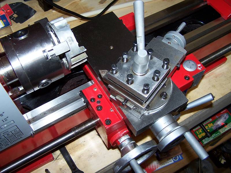

Well, I got my Lathe today. Give it a wax job! I am posting a few photos because...I got questions! The square tool block will clamp 3/4+ inch tools. Or is it better to get a tool holder that is 3/4 inch square. Also what speed is best for aluminum? I clamped a flywheel in it to see what dia it would hold. Seems ok with the Homelite flywheel with more to spare. It came with 2 sets of jaws. The only thing that concerns me is...the electric motor seems noisy in the ccw direction, but is quite in the other direction. I may call H.F. about a new motor? Here is photos. thanks Capt,n

The 4-way tool holder will hold a big tool. The important thing is that the tool's cutting edge is at (or near) the centerline of the work. QCTP's have a nut you adjust for height. After setting one up, it stays at the right height when you take it off. With a 4-way you typically use a tool a little short and shim it up to the CL. I say typically because these machines are often metric (IE 8mm tool) and the tools you will find are imperial (IE 5/16" ). Also, some profiles will require grinding material off of the top of the tool requiring shimming. The 4-way can hold 4 tools, all shimmed, for a rapid quick change. Change one and you will likely have to set it up. I've seen tools stored with their corresponding shims to take some of the hunt and peck out of it. I have a 9x20 and use mostly 1/2" tools. In most cases 1/4" tools would be fine. I also have a QCTP (wedge from JTS Machinery) and it is easier to use and a big timesaver. MIKE

Another way to check for center height accuracy is to take a lite face cut. When you can turn just past center and have a smooth finish with no little *** of material standing out your tool is at the center of the work piece. Speed is dependant on tooling the material etc. For your machine I would say maybe 1100 RPM with HSS tools. Try this link to Little Machine Shop for the round nose tool I am referring to. I have some that are old from there and use them in my 12X24 Clausing. http://littlemachineshop.com/product...ProductID=1967 If you have one or grind one with a rounded nose you will get a fine finish on aluminum. I also use super fine sand paper or scotch bright. Then I use Mothers compound and polish them up using the lathe. Just make sure you level and set the machine up properly, including bolting it to the table and don't forget to align the tail stock with the head or center line of the lathe and you will love it and turn your first hub out in few hours. Go slow and take your time. Also don't take agressive cuts with the machine and you will hold concentricity. When you part one off go very slow or you will break your tooling.

Looks like you will have a tough time turning the flywheel down as the chuck jaws will interfere. You need a mandrel or a live center for the tailstock and a dead center clamped in the chuck as Edwin talked about. Otherwise you will be out of round. Another way I have done it is to use the tapered end from an old crank. I had lots of them and have cut the ends off with the taper to use as a mandrel. Slide it into the tapered end of the flywheel and tighten the nut. Then I chucked it and indicated the shaft cut off in and started cutting. You may need to take a cleanup cut on the face of the flywheel to seat the hub good.

I do not plan on turning down any flywheels. I just wanted to see if it fit in. I may bore a flat spot for a hub to seat against. Most flywheels only need a little more clearance for hub to seat good. I know I could taper the hub adapter down some...but I like the full dia I am using. More surface contact. Also I have been saving crankshafts to cut off. I plan on cutting the center out of the flywheel with a hole saw (works nice) and the mount the center part on a crank shaft in Lathe. Then I can tru it up. Photo for that later. Keep the good tips coming....it really helps. Capt,n
