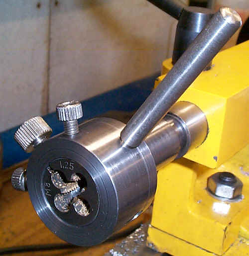

Old 12-04-2006 | 06:23 PM

Default RE: Lathe for conversions

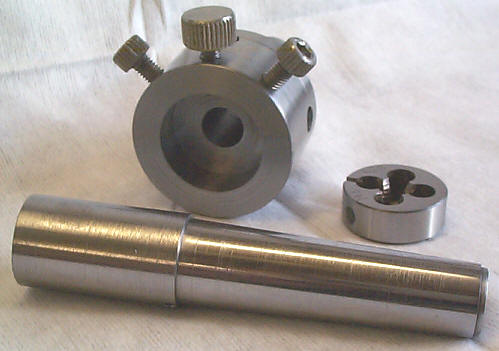

Here is a few photos of some neat stuff fo doing those cconversions on Lathes. Capt,n

I added more neat photos...last 2 postings. This was a home made tool block. Look up this stuff and you can see how to make one. Capt,n
