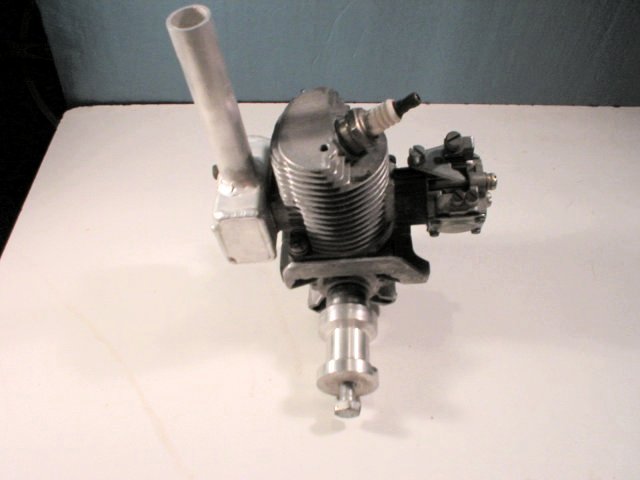

I have had this motor for years. Maybe 12 years ago I tried a glow conversion with a 4stroke glow plug (silver soldered into a cut-down plug). It has a barrel slide carb on it (not original). I was running 25 or 40% nitro glow fuel (as is). It wouldn't idle, but seemed to run well. I just hooked a AA battery to it. Now, with a 38 page gas-n-glo thread, I see I may have been on to something.
I think it is an (old) Echo 20cc. I cut the crank down, and trimmed more metal off of it last night. It is down to 1lb 13oz. I might expend a little more effort on it. Neat how the mount is built in and it has a two-ended crank. The flywheel is (was) keyed to the crank (no taper, 8mmx1.25). It has tight, round, barrel fins and an angled plug. Anybody positively ID it? Any insight into it's possibilities ? Thanks, MIKE

The present day 16cc is almost, if not, identical to it. Flywheel mounting and all. That's my son on the tractor with an Echo 16cc in it. Looks just like yours, My dad to my left. That picture is 20 years old. Now my grandson drives it. That's him in the second picture.

if it looks like mine in this pic its a 16cc echo.mine in this pic weighs 2.4 lbs.

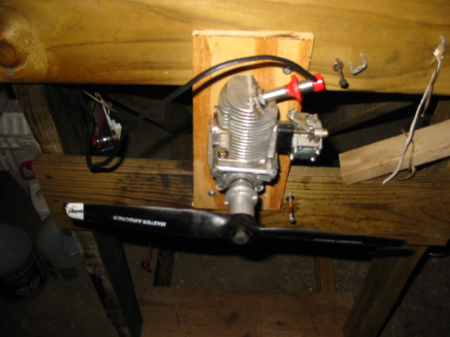

Old 11-19-2006 | 11:55 PM
Posts: 12,957
From: Hesperia Michigan, MI
Default RE: 1lb 13oz
This look familiar? Capt,n

OK, so I'll go along with 16cc Echo. My brother (former lawn mower shop guy) gave it to me. I called him today, and he thought it may have been 20cc. He hasn't seen it in a LONG time. What prop & RPM are you guys using/getting? Anyone have one flying? Somewhere around here I have a 1/4 scale Pietenpol Sky Scout (S Squared kit). It is not finished (not me...), it was supposed to run a .40 and a pound or so of weight added to the nose. This little gem might prompt me to finish it (or at least start to work on it again).
Buck, I love the tractor! How did you drive the wheels? Must be a bunch of gear reduction in there somewhere. Very cool.
Thanks for the ID, MIKE
